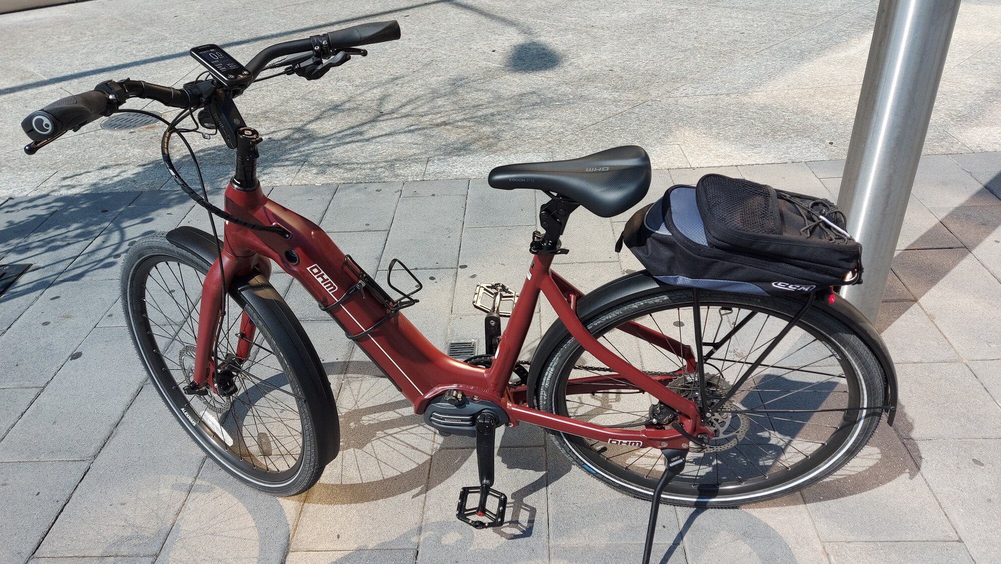

I have been using the Redshift ShockStop stem for about a week, and today my new ShockStop seatpost arrived. Took the bike for a ride over some rough patches I usually prefer to skirt around. I am very impressed with both of these additions! Together they do just what they say: Take the shock out of a rigid suspension. The ride is much more enjoyable now, and still without any excessive bob or bounce. I’m a VERY happy customer!
