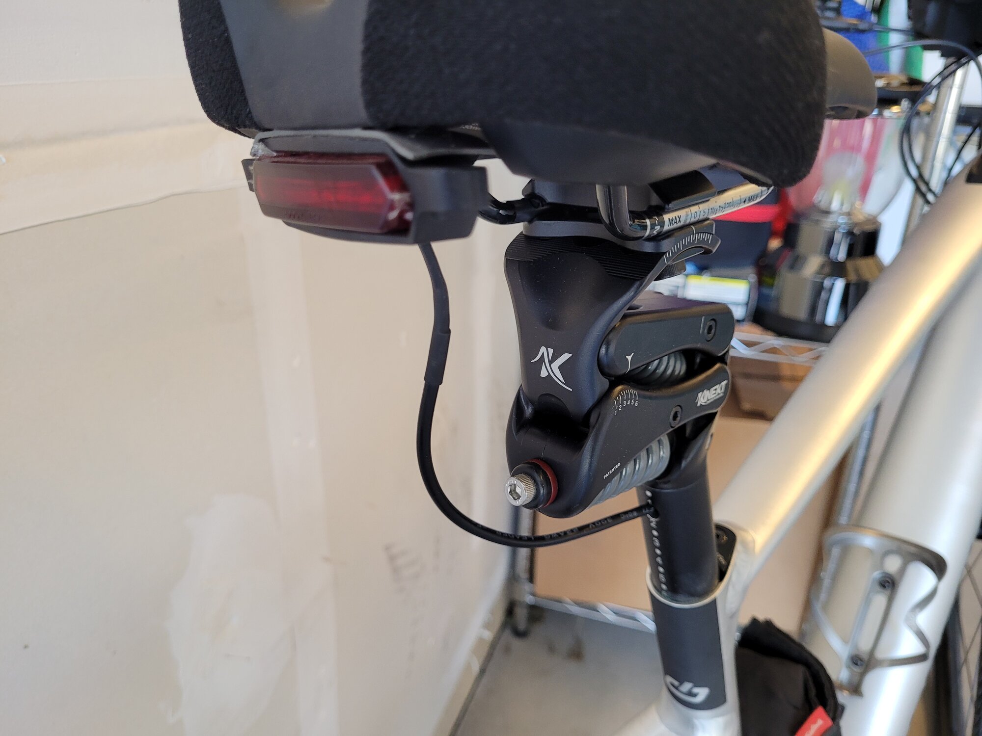

There is a disconnect push/pull pin setup in the wire(s) when you remove the seat post. No splicing necessary. The light is attached by 2 screws to the seat.
Yeah I removed the light from the seat already. I hate the way they try and make you keep the specialized seat. I have the light mounted to a WTB seat with some 3m double sided tape for now. Maybe zip ties in the future.
Looks like Kinekt won't drill a hole for you anymore, so will definitely be using your guide when I get it. Also, couldn't get a short enough seat post, so I'll have to cut it down when I get it. I think default is 350mm. I need around 320mm due to my stubby legs.

Got the Kinekt post. Didn't have to cut it. Here's a pic.
After riding on the Kinekt twice now, I really like it. Doesn't totally eliminate bumps, but definitely a lot better. The bumps that I do hit now, aren't as jarring. I did have to adjust the preload, otherwise I was bouncing a lot when pedaling. I think I'm at a 4 right now. I'm using the XR with Purple Red. I may try tightening a little more or go up a level in springs.
Also, I noticed that the reason the original Specialized seat post didn't slide into the seat tube as well as I would have liked was due to the wiring for the rear seat light getting in the way. I put some more of the wiring inside the seat post and get a lot more range without it getting stuck.
