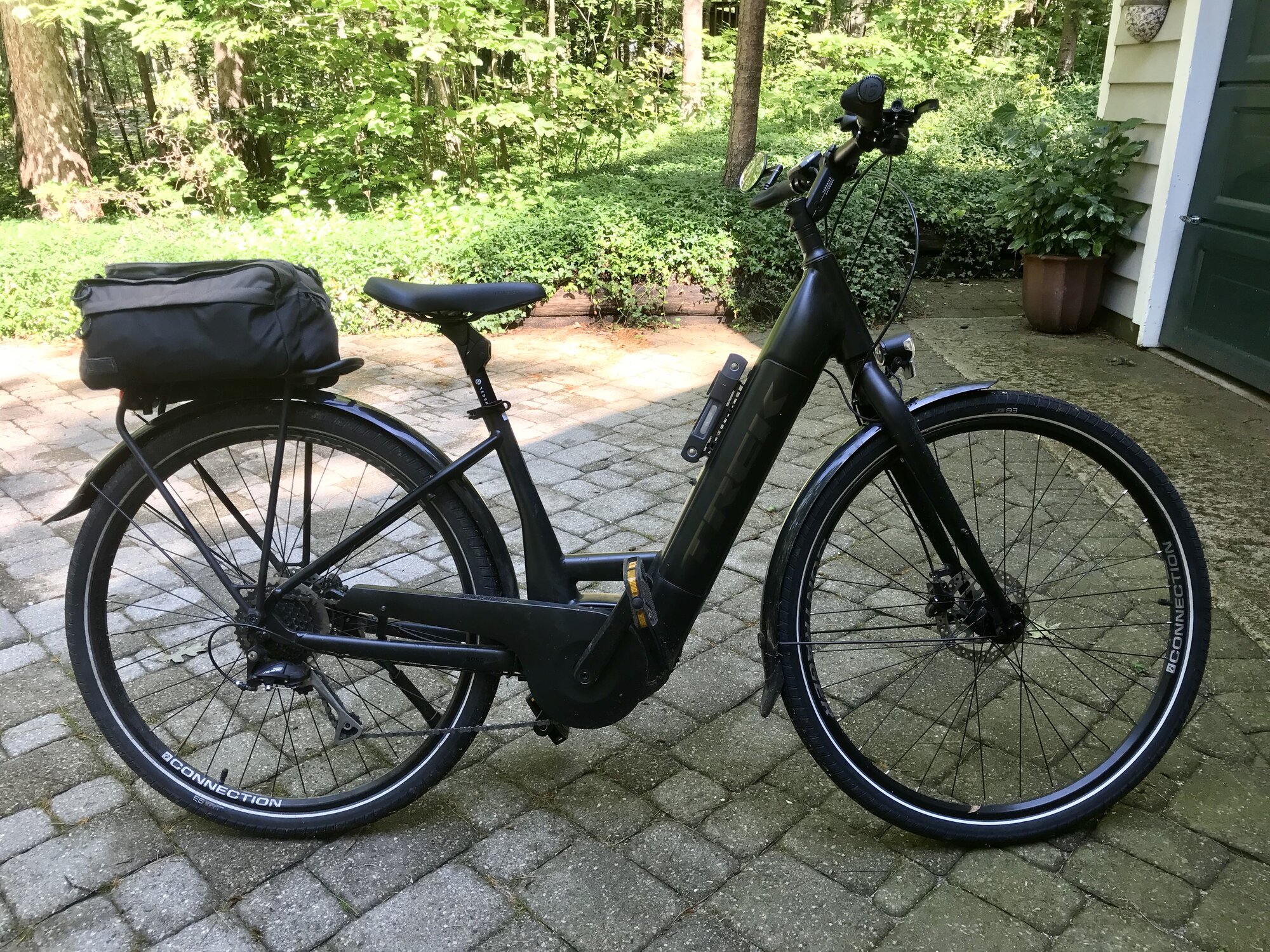

Redshift ShockStop seatpost and stem installed

I have been using the Redshift ShockStop stem for about a week, and today my new ShockStop seatpost arrived. Took the bike for a ride over some rough patches I usually prefer to skirt around. I am very impressed with both of these additions! Together they do just what they say: Take the shock out of a rigid suspension. The ride is much more enjoyable now, and still without any excessive bob or bounce. I’m a VERY happy customer!

I installed the Redshift stem on my Lefty 3 a couple of days ago and yesterday I went for a 70km ride (mostly pavement, but some gravel pathways and roads).
My first impression is it smooths out the ride slightly. It's barely noticeable, but enough that I'll keep it on the bike for awhile.
I followed Redshift's recommendations on which elastomers to use, but I find the stem movement to be almost non-existent. Even when the front brake on and press down hard on the handlebar I can barely get the stem to move.
Today I'm going to change the elastomers for a lighter weight rider and go for another ride to see if I notice any difference.
