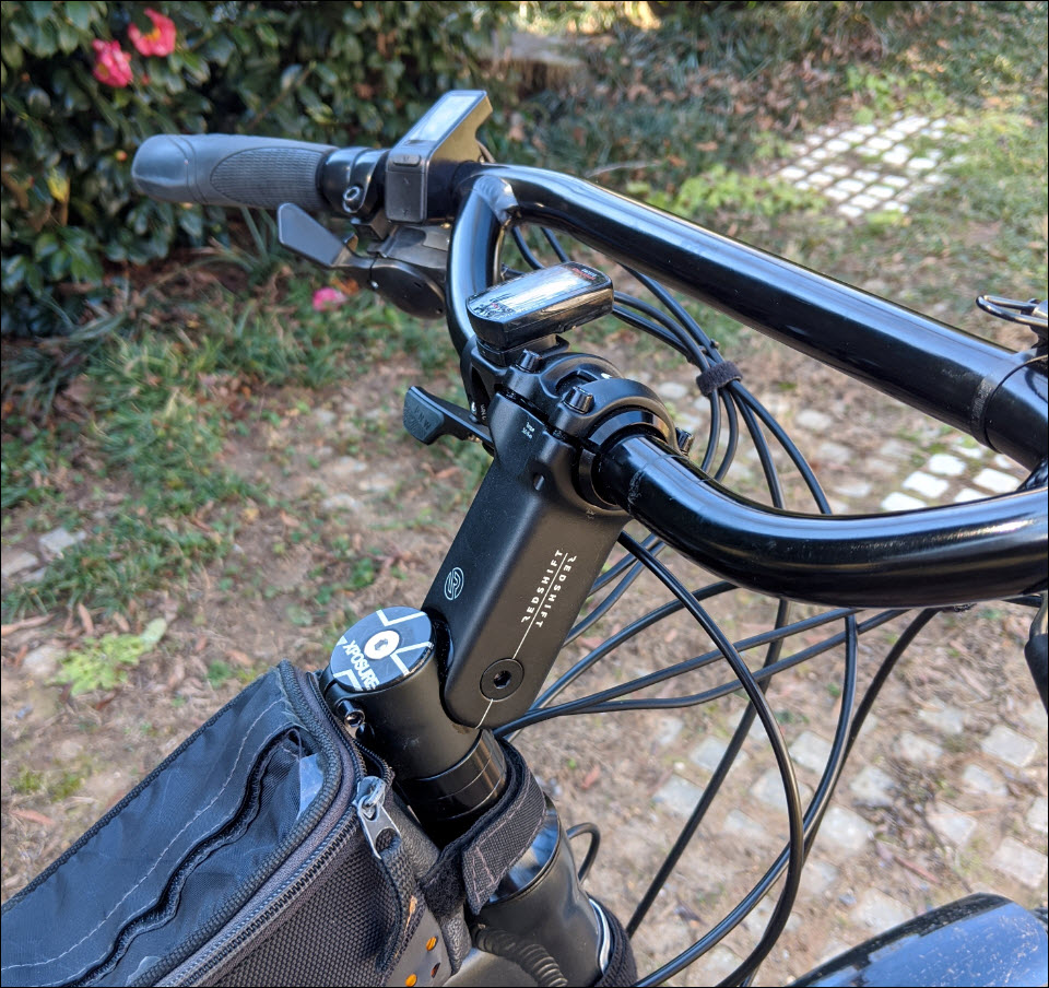

Redshift ShockStop seatpost and stem installed
Good to hear you will be back on the bike! ;)
Does the single elastomer provide balanced shock absorption... ie., even damping on both the right and left sides of the handlebars?
I will let you know after my ride tomorrow. Just got clearance for riding, golf and swimming. (and some indoor sports we cant mention on this family friendly forum!)

This week, I installed the 30deg/100mm stem on my Mongoose Envoy.
By default, the stem comes installed with a pair of elastomers. The 60 (orange) and 70 (blue). I pulled the 70 and left the 60 installed. I took a ride and it seemed squishy. The next day, I pulled the 60 and replaced with the 70. The ride was better but seemed a bit stiff as I'd already been 'softened' by the 60 the day before.
I reinstalled the 60 and that's where I stayed. The movement of the handle bar is a bit strange at first. You'll get used to it and for the better. Minor imperfections on the sidewalks, roads, and trails are now tamed.
I've also set my stem up with a softer elastomer. I can feel the bar move slightly, but after putting a couple hundred km on the bike it doesn't bother me. On the other hand, riding on gravel feels better.
