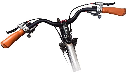

Cruiser style handlebars will definitely help with better ergonomic positions for your arms, hands, and wrists.

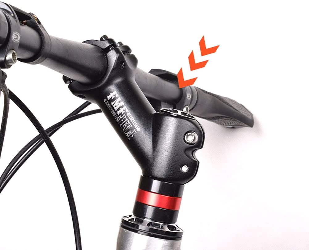

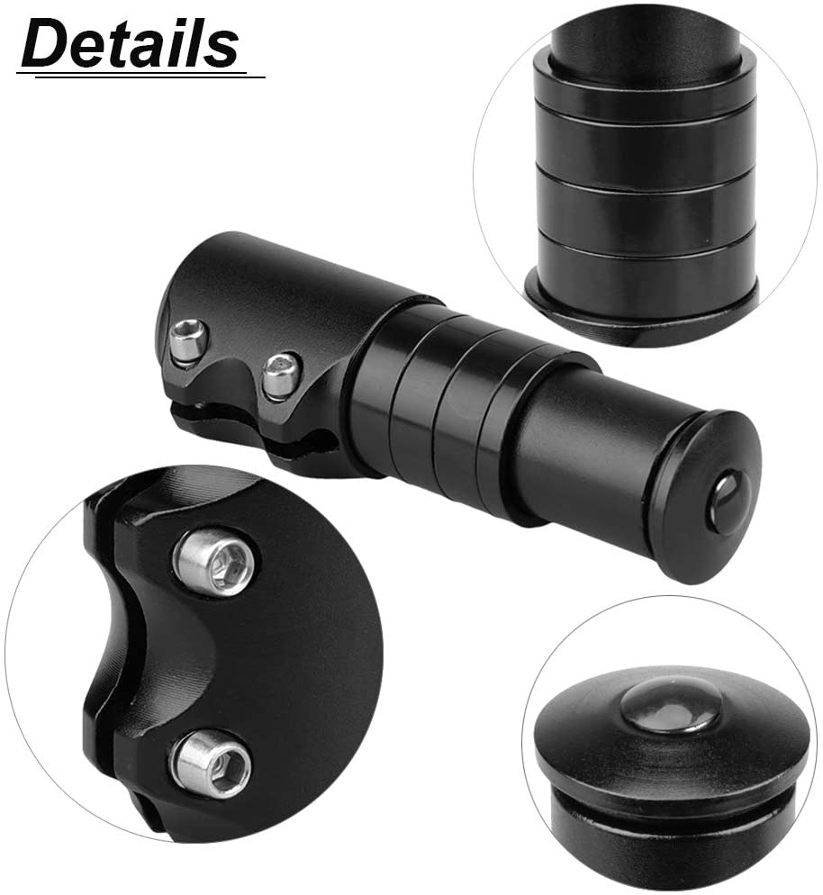

The stem riser and high angle stem will help with your back, neck, and shoulders. Here are a few suggestions: Hope this helps!
AmazonSmile : UPANBIKE Urban Road Bike Retro Handlebar Moustache Shape Extra Wide Dutch M Shape (25.4mm600mm) : Sports & Outdoors
AmazonSmile : MAGARROW Bike Stem Riser Handlebar Riser Adaptor Bicycle Fork Stem Extender Aluminium Alloy, 3 × 10mm, 1 × 5mm (Black) : Sports & Outdoors
AmazonSmile : FOMTOR Bike Stem 31.8mm 45 Degree Bicycle Handlebar Stem Riser MTB Stem Suitable for Mountain Bike Road Bike BMX MTB (31.8 x 90mm) : Sports & Outdoors

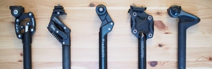

Here is a good comparison blog on various suspension seat posts... 😉
ShockStop Seatpost vs. Thudbuster, Bodyfloat, Suntour NCX and Specialized CG-R – Redshift Sports
The ShockStop and BodyFloat seatposts are both designed to "float" the saddle within the travel of the suspension, isolating the rider from vibrations as well as larger impacts. Both utilize linkage-based designs with 35mm of stated travel, and they’re similar in weight (ShockStop 497g, Bodyfloat 525g). Despite these similarities, there are some meaningful differences between the two designs:
  • Preload Adjustment vs. Suspension Travel - Both the ShockStop and BodyFloat allow the user to adjust spring preload (the amount of force required to make the saddle start moving), but the way that the adjustment is accomplished is very different.
  • With the BodyFloat, as you increase preload, the linkages compress downward, which means that you lose suspension travel as you increase preload. If you’re toward the upper end of the weight range for a given spring setup, or if you want to ride a more traditional, stiffer-feeling setup, you’ll have dramatically reduced suspension travel available when you encounter a larger impact.
  • With the ShockStop Seatpost, the preload adjustment is accomplished by compressing the spring upward from the bottom of the post. This means that the travel range of the linkages is unaffected by preload - you always have the full 35mm of travel available regardless of where the preload is set.
"The Suntour NCX is a linkage-based design with an internal coil spring, but there are some pretty big differences between the Suntour and the ShockStop:
  • Adjustability - The ShockStop and the Suntour both allow the user to adjust the spring preload (the amount of force required to make the saddle start moving), but with the Suntour, the stiffness of the spring is one-size-fits all. Whether you're 100lb or 250lb, you're stuck riding the same spring stiffness, which means that the vast majority of people aren't able to adjust the suspension performance properly.'
That claim of only one spring type might be true about buying from most sellers, but I bought an extra spring, so I have one soft and one medium or "regular" spring for my Suntour and there is a stiffer spring as well.
