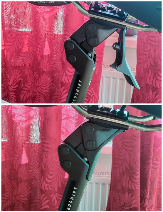

The seatpost comes in an elegant cardboard box. There also is an additional "inner" spring and a detailed instruction manual there.
Installation & Setup
The seatpost is almost ready to be used. The only thing you need to do is to rotate the Preload Adjustment Plug at the bottom of the post to the correct preload position (listed in a table of the instruction manual) appropriate for your weight (the preload position was #3 in my case).
The only circumstance under which you would need to unscrew the plug totally is the case you are a heavy person (over 90 and up to 110 kg that is 200-240 lb) or your riding style requires firmer suspension. In such case, prepare yourself for some mess, as the internals of the seatpost are generously greased. (You would need to remove the internals, insert the additional inner spring inside the main spring, and reassemble the whole thing in reverse order, possibly adding more grease).
After that, you install the seatpost and the saddle as if it just were a regular seatpost with one exception. The chamber holding the saddle-mount bolts is covered with a "fender" that is held in place magnetically (and is secured by a rubber band). You need to pull the bottom of the fender, take it out completely, and then you get the access to the bolts and are able to install the saddle.
The fender removed and re-attached.

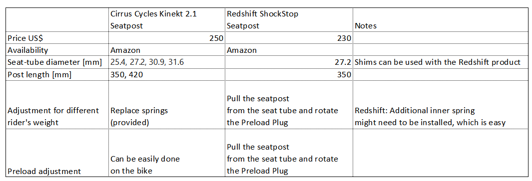

Comparing Redshift ShockStop to Cirrus Cycles Kinekt 2.1 suspension seatpost
These two seatposts are equal in performance. The only difference is, I'm getting a little pedal-bob at high cadence with the Kinekt while I experience no pedal-bob with the ShockStop whatsoever (perhaps I should increase the preload on the Kinekt).

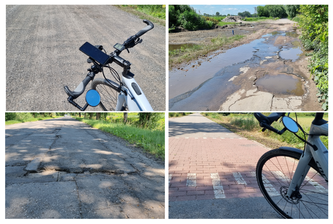

Bad (and Good) Road Test
Various surfaces ridden during my test.
  • Good but uneven asphalt: The Redshift "suspension" makes the bike flow. The ride is totally cushioned.
  • Speed-bump. Accelerate to high speed and just ride over the obstacle. The experience is equivalent to riding a full suspension bike!
  • Low, nasty curb: No worries. (You will feel the hit but strongly dampened).
  • Good gravel (with minor potholes): I rode through such a segment at full speed, with the vibration still perceived but strongly dampened.
  • Washboard gravel: You just suffer far less, and certainly don't yell "Aaaaaargh!" :D (To totally dampen vibration in such terrain, you need to ride on low-inflation tyres)
  • Cracked asphalt: A pleasure to ride it!
  • Heavily damaged asphalt: the suspension mightily dampens the vibration. Just ride slower.

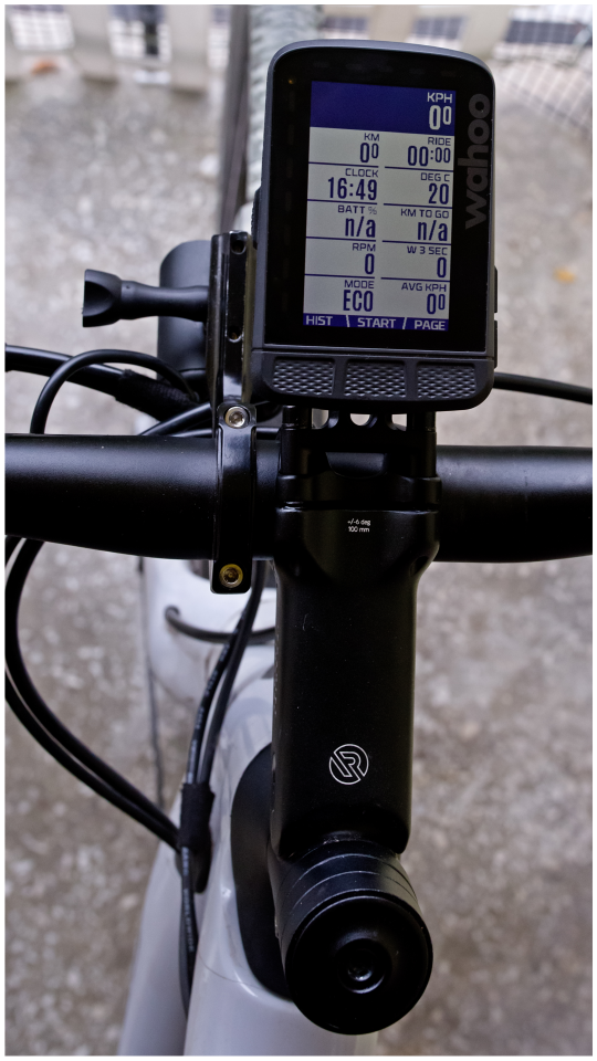

Finally, another Redshift product: ShockStop Computer Mount (Wahoo version). Garmin and CatEye versions are available, too, allowing mounting even more mount-compatible GPS bike computers. The mount is made of strong aluminium alloy. Another product (which I might find useful but actually don't need) is the Utility Mount: a piece of horizontal tube forward of the stem, which allows mounting items you would normally mount on the bars.
The ShockStop Computer Mount holding my Wahoo ELEMNT Roam.

BEC:
Before I go on, be warned you will need to get a Go Pro handlebar mount to relocate the headlight from the original stem. (It is good as it moves the lamp forward beyond the cables). I assume you have the Lezyne Hecto StVZO headlight.
The size choice is yours and depends on your preferred riding position. Most of people would choose the 30 degree stem, one size, to raise the handlebars. My choice was very specific, let me explain why I chose the 100 mm, ±6 degree one:
My Vado SL is size M for the proper top tube height for my legs length. However, that e-bike is a tad too small for me in other dimensions. First, I placed the 100 mm stem in the +6° position, as tall on the steering tube spacers as possible. That developed neck and shoulder aches, and also I suffered pain in my backside (I was sitting too upright on the saddle).
Following advice of EBR Forum members, I flipped the stem to -6°, and moved it down all the way on the steering tube with only the smallest spacer left below the stem. My riding position has changed to more aggressive but my pains are gone.
Not easy to find a good bike fit. I was lucky!
