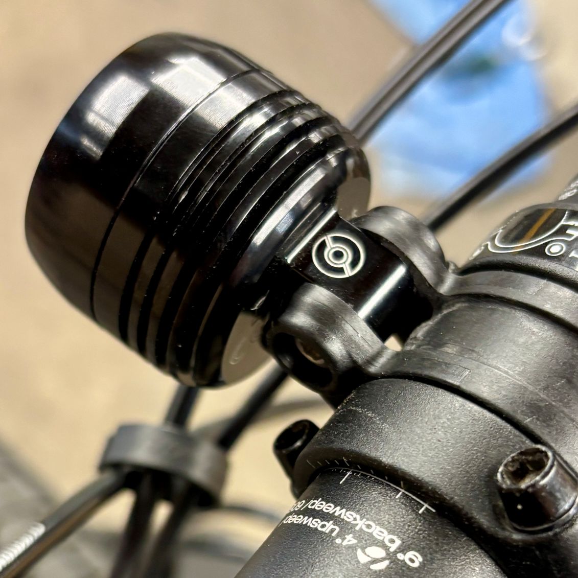

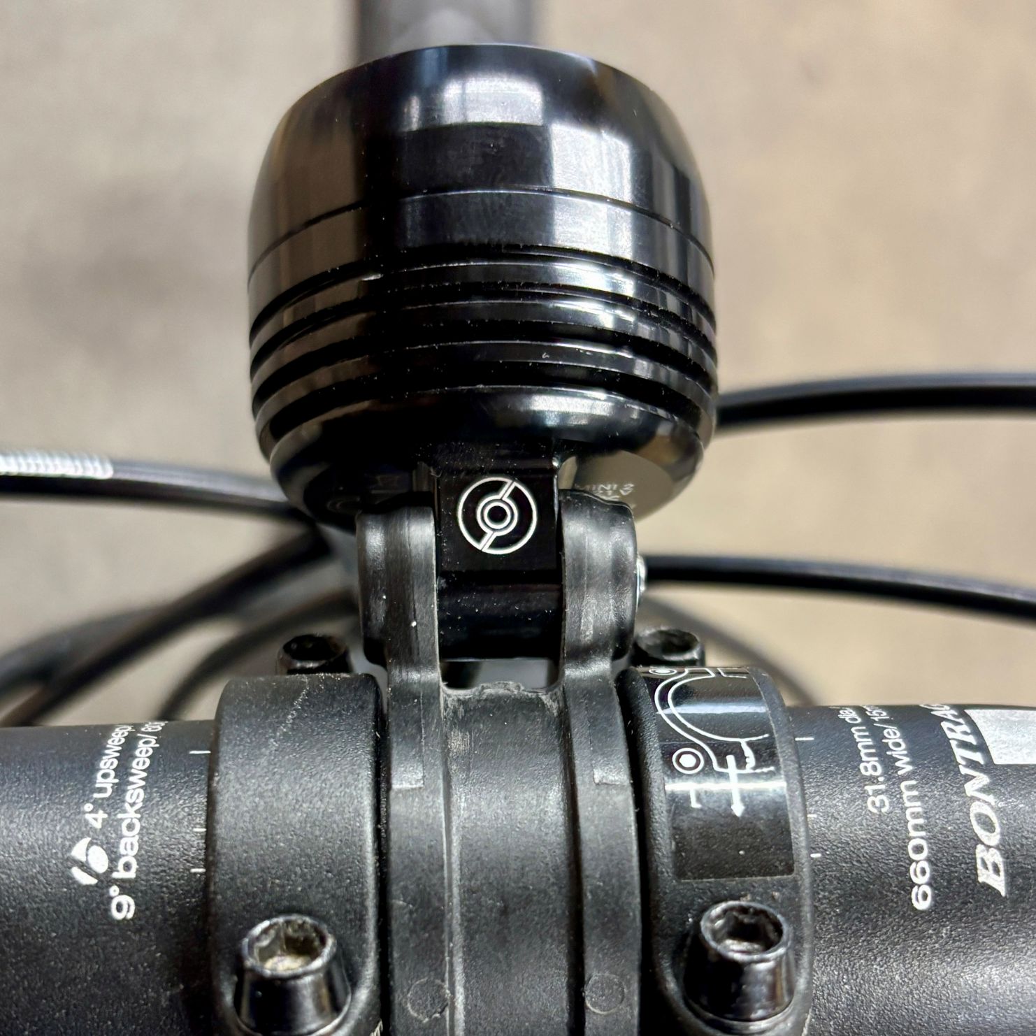

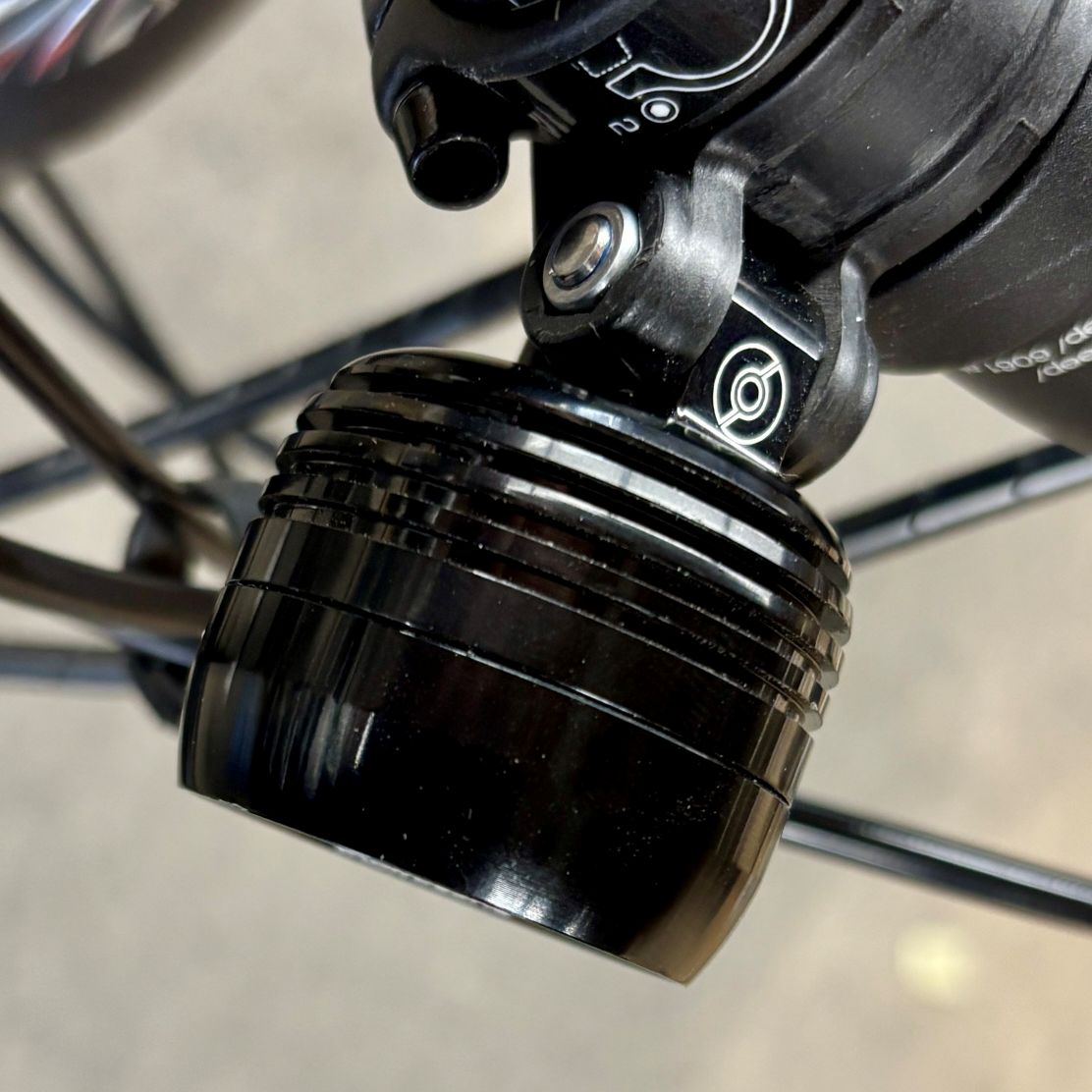

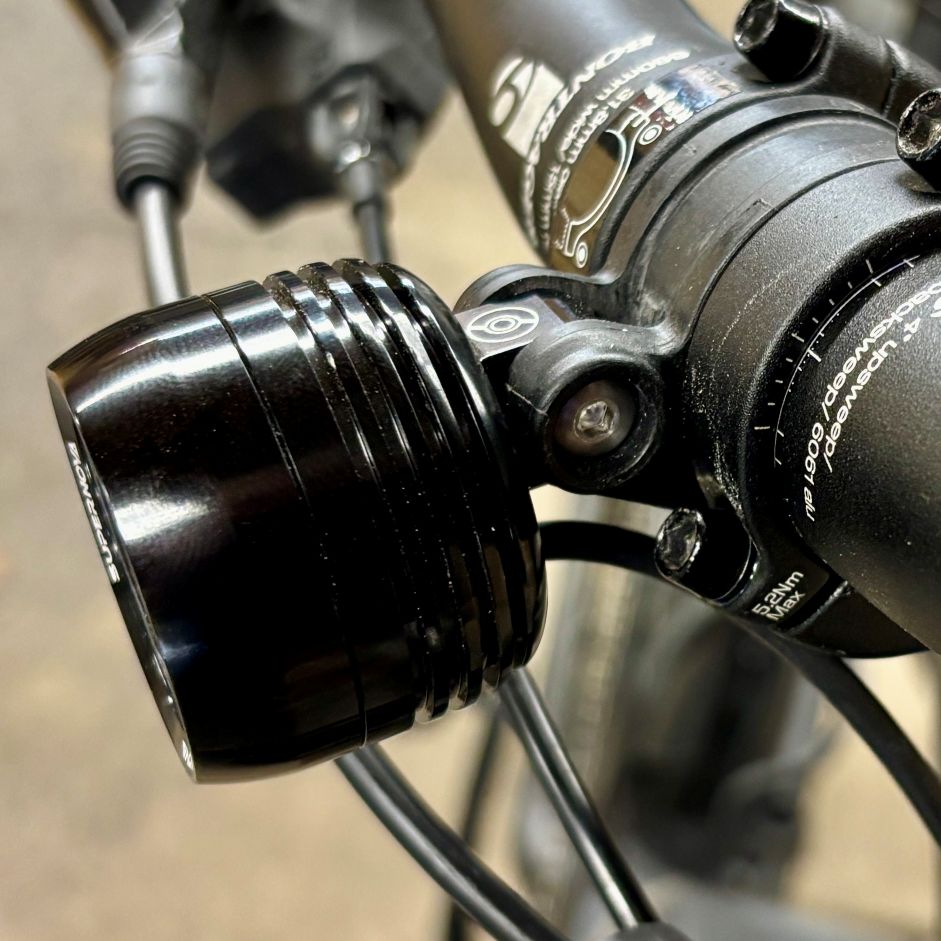

So, that sets me up to solve my light mount issue, and I prefer to have it in its original location. And to tell you that the standard BLENDR insert can be pretty easily modified to use as the mount for this light, and possibly other applications. The standard BLENDR system mount has a center 'finger' if you will. By carefully removing that middle section and slightly widening the remaining gap by filing or sanding a slight bit equally from both sides of the remaining outside sections, the Supernova light will slide right in and tighten securely. The original mounting screw is too short to work without further mount modification but an M5 nut will fit that cutout and an M5 screw cut to size completes the needs. For the screw I had on hand I had to turn the screw head and remove a slight bit of material to fit into the recess. Came out beautifully and should serve me well.
