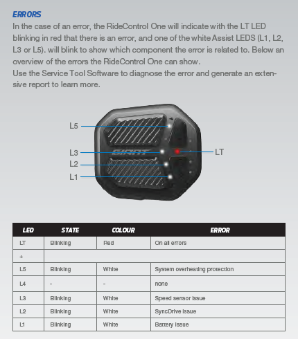

Hello l am having red light issues with my 2020 Giant Estance 29er. The bike ride control flashes up with a red light. It happens after a couple of minutes.
I have checked the sensor position and have tried resetting the controller.

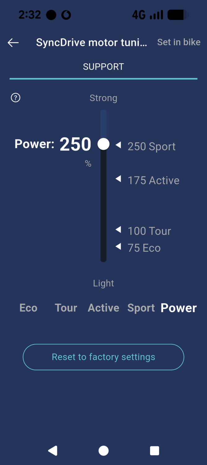

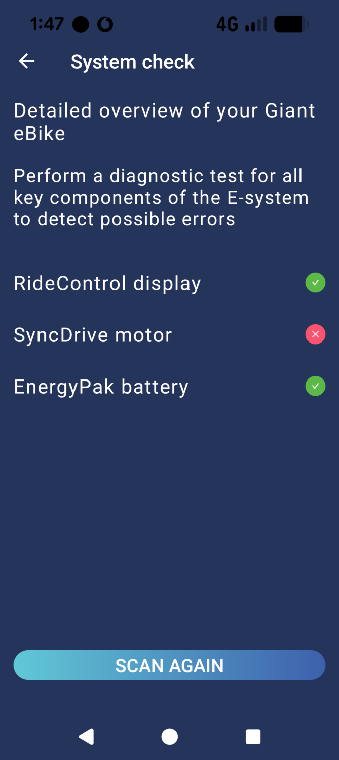

I have added a 1mm spacer under the battery connector, this has been a fix for others. I had the spacer 3D printed. Unfortunately this isn't the route cause of my issue. I used the giant app and it reported a drive sync issue. I managed to use the app to set the power level to full power, this got me home and the app seems to override the sync controller. This leads me to believe that the problem is with the two button ride controller. All the lights went off on the ride control and the phone with a Bluetooth link allowed me to get me back home. Is there more detailed fault analysis that l can do. I think it is likely to be the controller but it may be an intermittent pedal assist sensor. Don't want to waste money buying unnecessary spares. Any useful help appreciated.

I think when l used the giant app to manually set the power mode that this bypassed the speed sensor input? I did over 5 miles on full power and noticed that all the ride control lights went off. I normally don't go over level 2 on easy runs.
