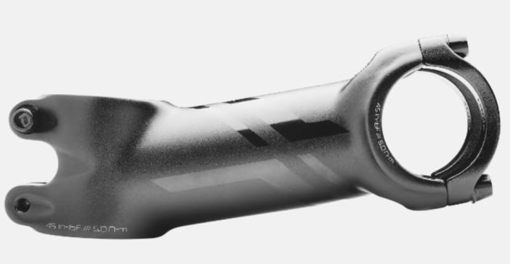

My choice was a 120 mm long, A-HEAD compatible (28.6x31.8mm), 12 deg Comp Multi stem. It is an amazing product from Specialized as it allows installing the stem at any of these angles: -16, -14, -12, -10, -8, +8, +10, +12, +14, or +16 degrees (10 possible positions!) How is it done? The steerer clamp of the stem is of an oversized diameter. You place the stem at the desired orientation (pointing upwards, or "slammed", that is, pointing downwards) then you insert one of three provided "angle shims" in proper orientation. Any shim is 28.6 mm (1-1/8") internal diameter and is allowing to change the stem angle in 2° increments. It was no wonder that the stems were stored in the bike-fitter's drawer!

My choice was installing the stem slammed at -12° (using the 0° shim). We fastened the thing delicately (so I could remove the thing without damaging the bolt paint). Then I mounted the Vado with Jerzy supporting me. When I got off the e-bike, we had that talk:

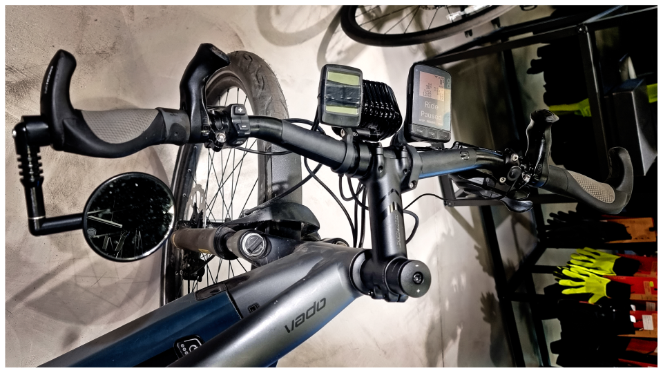

Then we completed the setup. Handling of the display was the most difficult thing. As the base of the unit missed the cover, and the mounting part was damaged, I protected the battery with a rubber spacer, and made up the remaining space with a 2 zloty coin (Jerzy laughed I made the part really expensive!)
Then I wrapped the display with strong tape, installed a Garmin handlebar out-front mount, and eventually fastened the display to the mount with more tape. As a Wahoo ELEMNT Roam v2 is my primary e-bike display now, the TCD-w is only kept for the Vado functioning (like a dongle).
The final setup.
Riding impression: The modification allows me riding in the true "sporty" forward position now. My butt has been relieved, and I felt no pain or hand numbness after the return ride. Now, my Vado is riding against the headwind significantly faster! If I need even more speed, I support myself on the Ergon GP2 bar-ends, which puts me even more forward! When I want some relaxed riding position, I just grab the regular handlebar GP2 grips.
