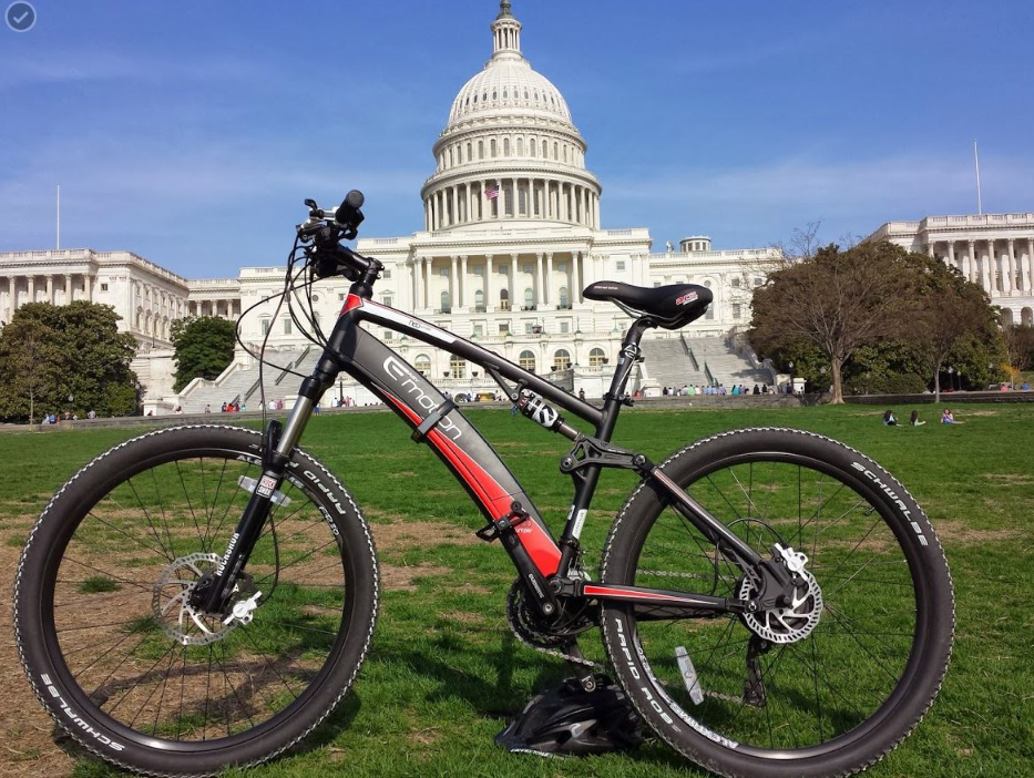

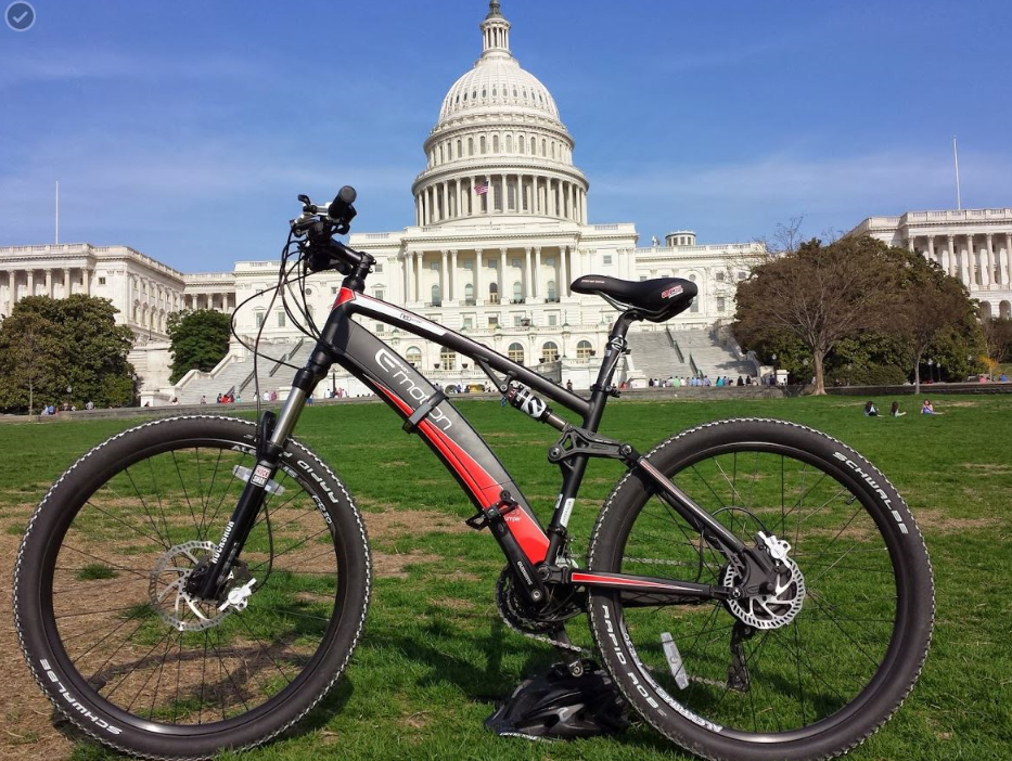

Just to give you some background information....
I have owned several bikes with the DAPU hub motor.
Perhaps I was one of the earliest to own BH E-bike with Dapu motor back in Feb 2014.
I put 3000 miles on it and another 3 thousand miles on BH Nitro E-bike.
It was small (less than the diameter of 160mm rotor), powerful for it's weight/size and did not give me any issue.
I know @J.R. has one and with over 10,000 miles. They do last a long time. I was speaking with the former CEO of BH last month and he said, he dealt with DAPU for over 8 years and never had issues business-wise or technical/warranty related. They are a Japanese company that builds motors to high standards and have factories in China to produce them.
They are more expensive than Bafang or MXUS motors but they work really well.
