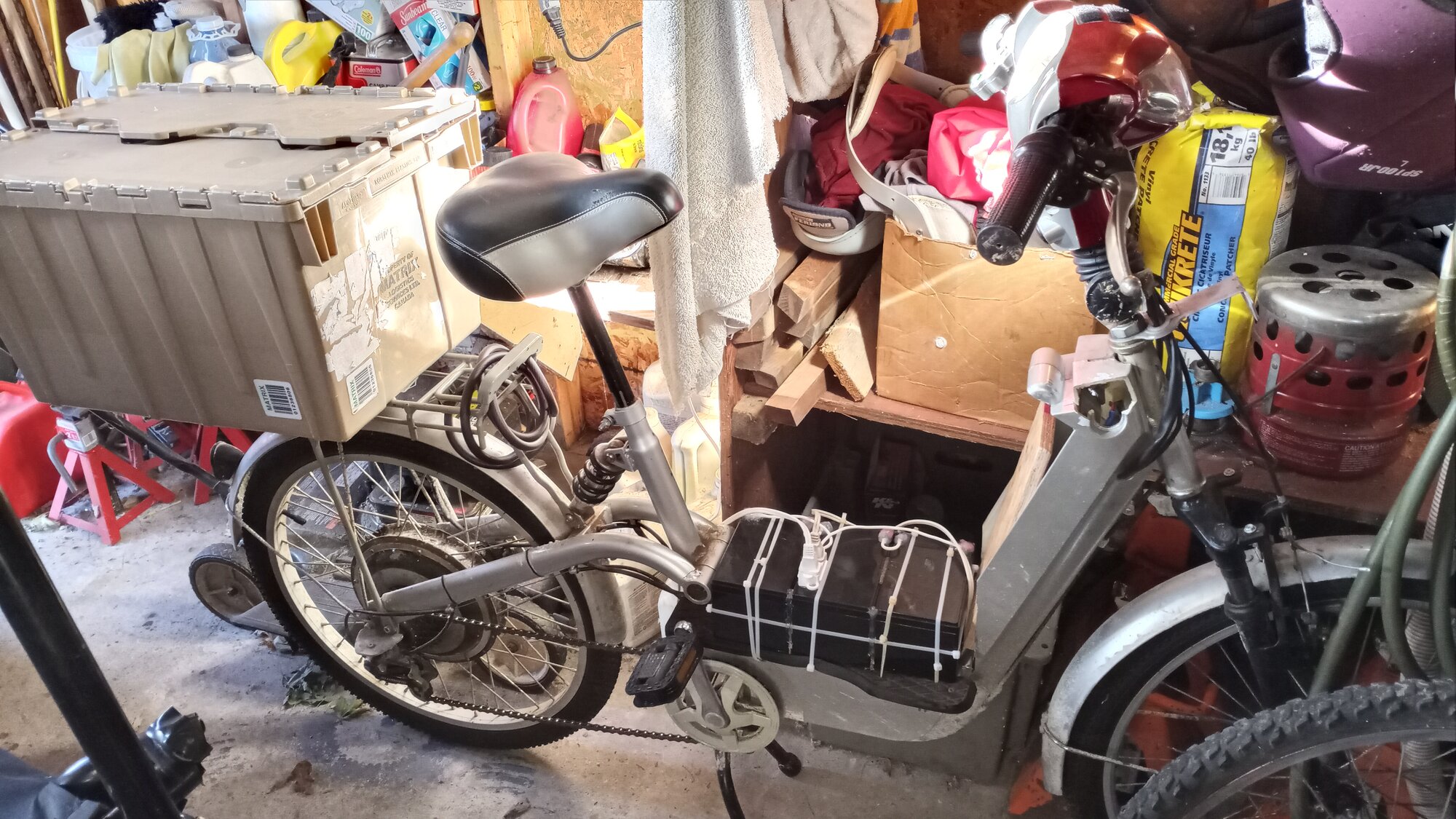

I use my ten dollar e-bike to get groceries.
Up to 70 pounds in the box.
It's a good thing that my batteries are heavy.
It keeps the nose down. 😂
Those are not your conventional ebike batteries man, they remind me of batteries for a small electric boat.
Ohh yeah!, no s*it!!

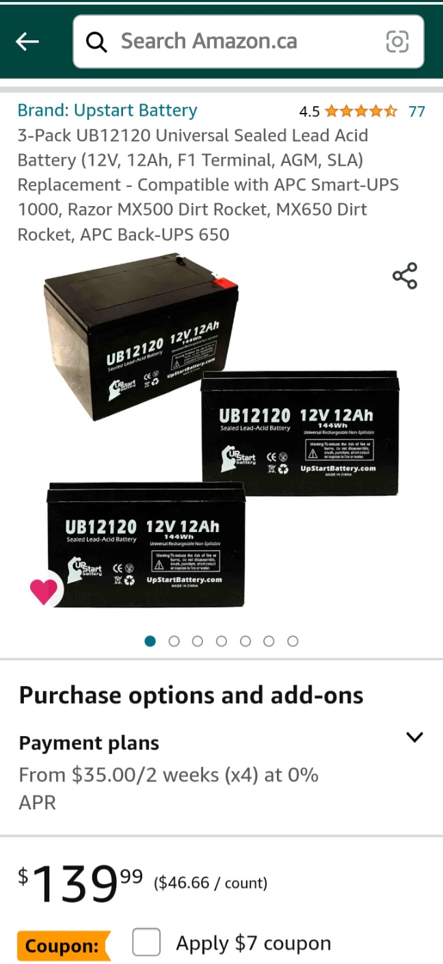

There's three 12V SLA batteries Zip-Tied to my floorboards. 😂
These Sealed Lead Acid batteries were the conventional power source before lithium ion.
That e-bike is 25 years old.
I don't how to put batteries together and make it perform.
How many miles on throttle alone.?
