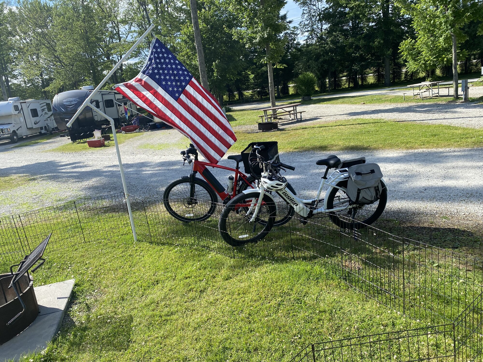

My wife and I have both kinds. Her Fission’s hub motor is 500 watts versus the 250 watt Bosch in my Gazelle T10+ Ultimate. I ride both of them but prefer the mid motor as I prefer to use the gears. Hers is very “zippy” as you say. I think it is just personal preference and an apples versus oranges kind of comparison.

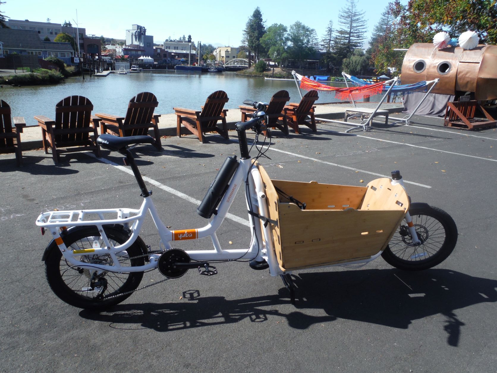

It's funny. Stefan and I are so very different, yet we both like bikes with the same riding characteristics. Here is one that lives on a hill in San Francisco and can carry 200Kg. It has a powerful duel clutch motor that I have optimized so it feels like a responsive instrument that is amplified to the extent desired. The small rear wheel steps down the gearing. It is going out today. See if you can spot any electrical wires. You would have to zoom and squint.
