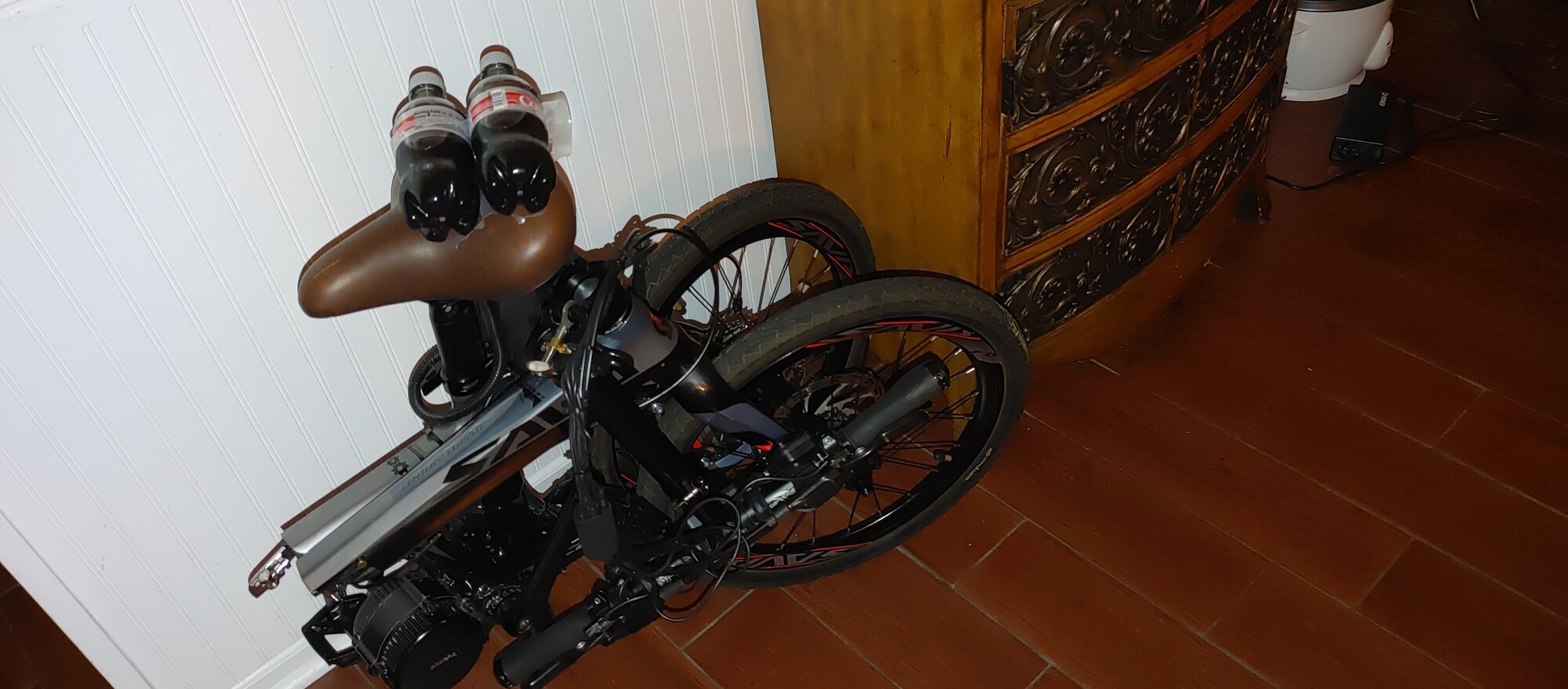

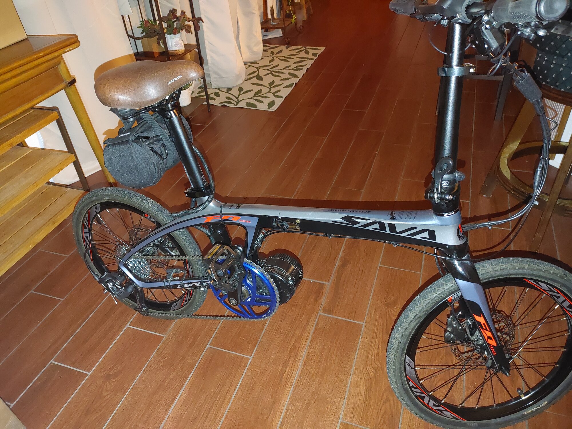

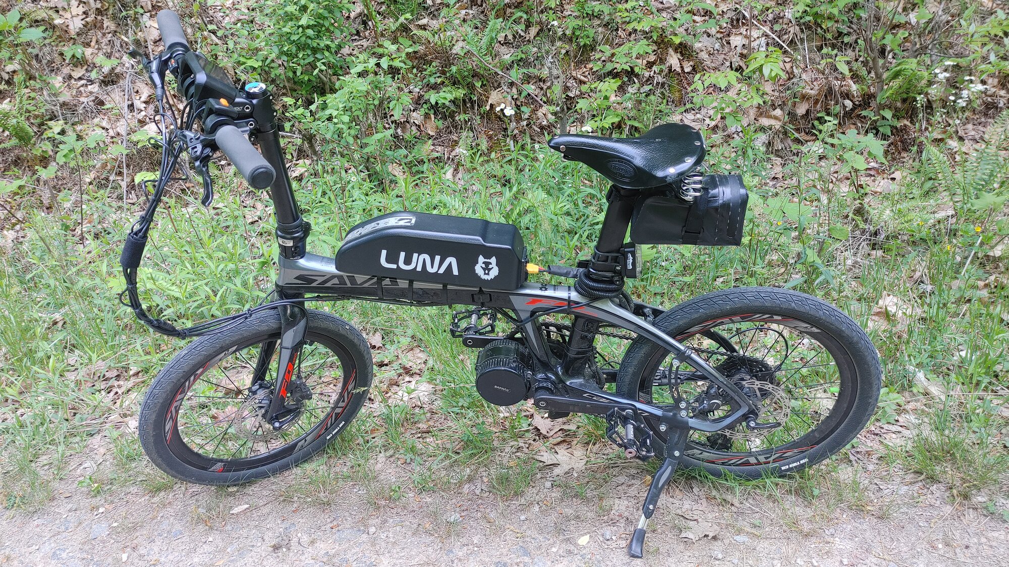

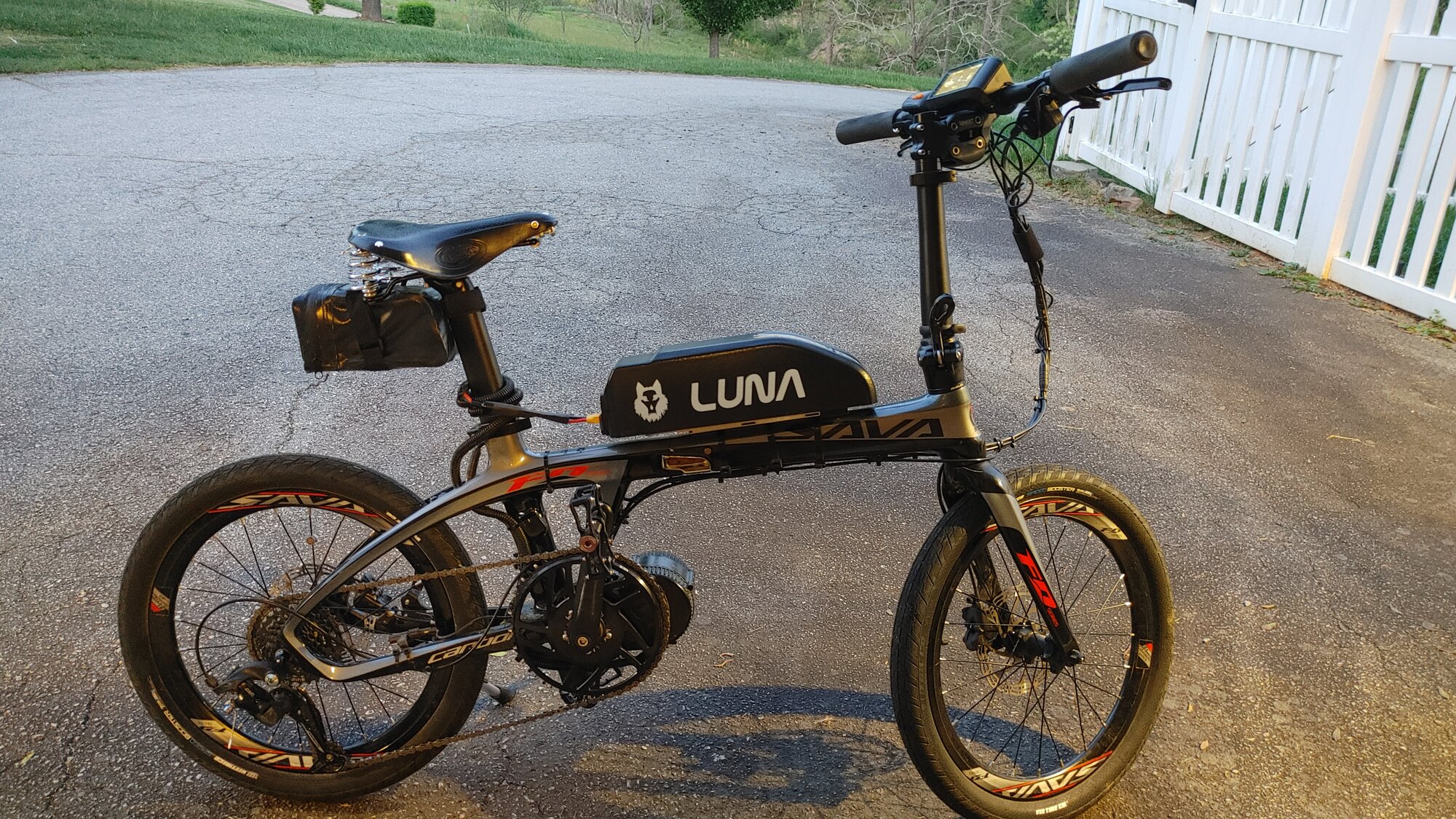

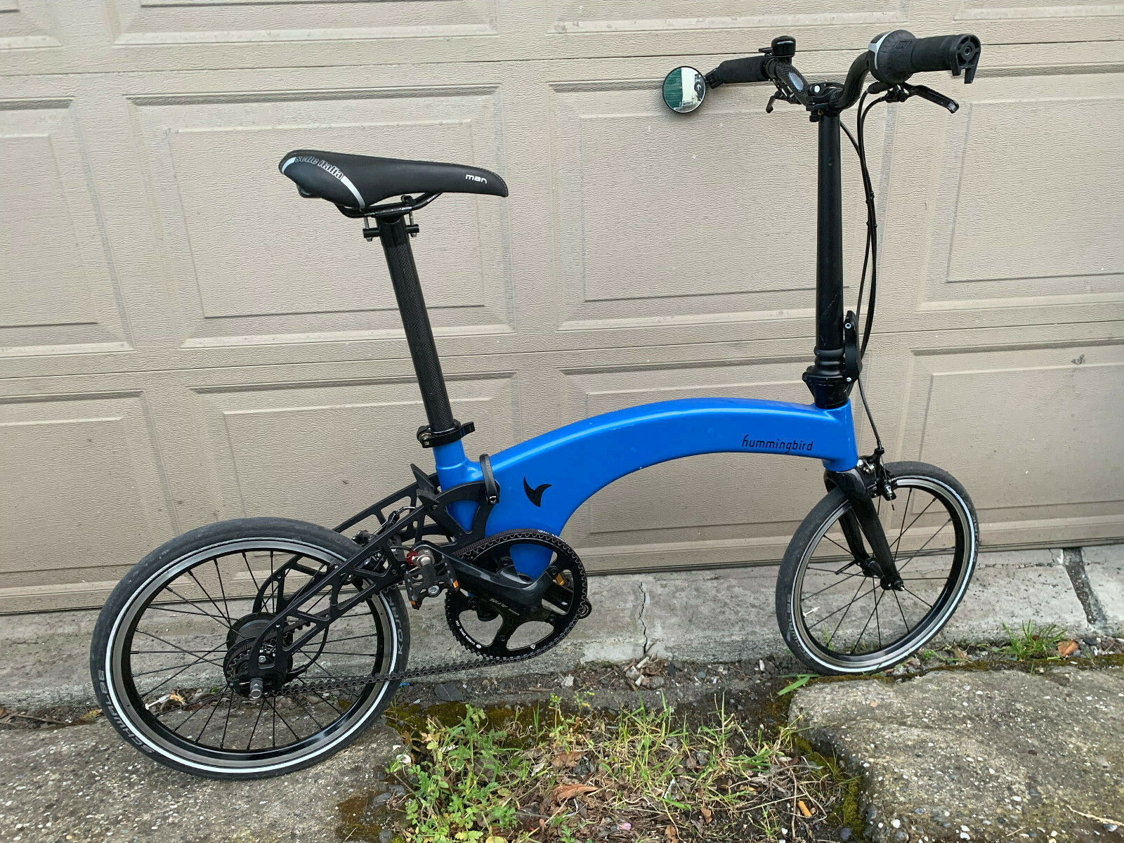

I've already built one and it ran excellent. Better then expected to be honest. The SAVA frames are really strong. Don't buy a frame from Aliexpress though , you might get a counterfeit . The guy at SAVA trained in Germany , they make some great one piece carbon frames.
I had over 1000+ miles on my bike (see picture) and it's a SAVA carbon folder. Never broke a chain. No flexing of the carbon under torque. Notice the rear of the frame is the box design which adds to stiffness. The motor doesn't shift or move at all. I recently sold this on EBAY and the new owner is installing an IGH. I'm worried about the Hummingbird folder because it doesn't have the rear box design like the SAVA but it does seem to be really well engineered. It depends on how well they built the bottom bracket, that's the key. I know the SAVA will work , but I want to try something even lighter. It's my goal when building an ebike , "It has to be light , strong, easily carry in a car trunk and really , really fast"
The hummingbird may be my next build. BBS02 , 52v , I included a picture of it (the blue bike) . I just wished it had a box frame in the rear. I don't like coaster brakes either. Only way to find out is to build it. They do sell a hub kit for it. But it doesn't meet my power needs.
But I can vouch putting a mid-drive on a carbon frame worked just fine for me.

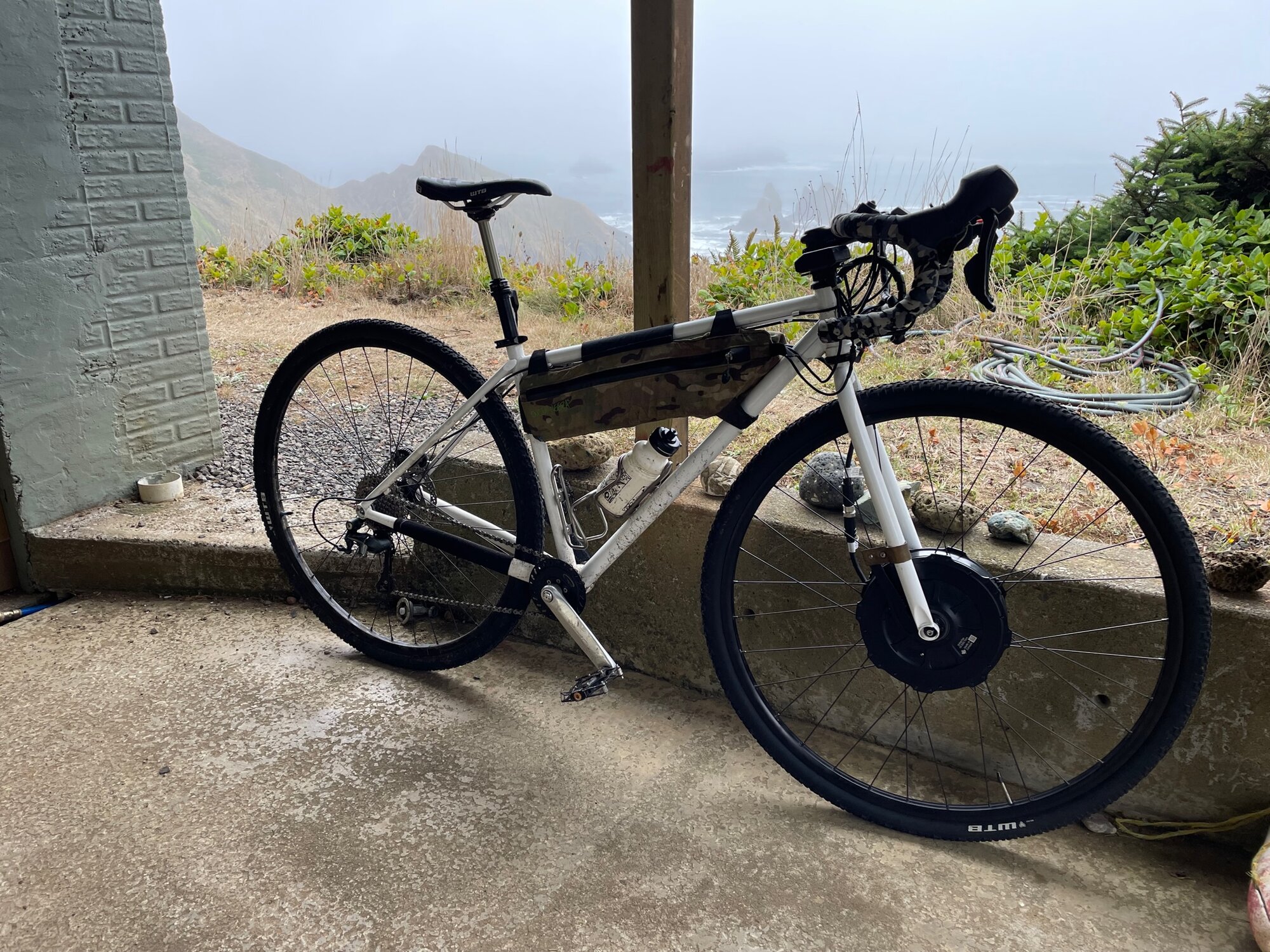

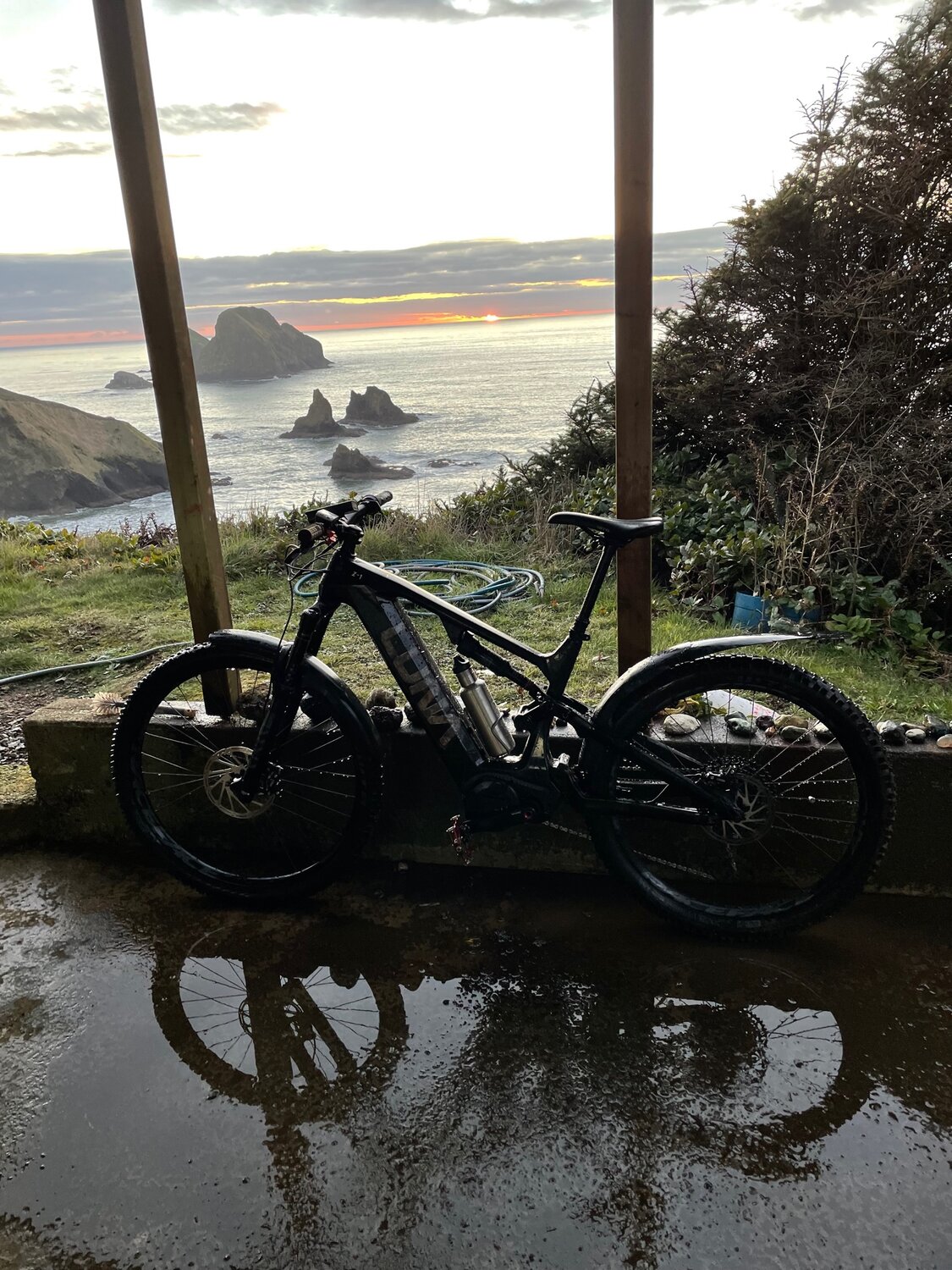

Once again we promote that which we don’t know mostly on the back of forum drivel. My choice is best, but lacking relevant detail. Jeebus. In some cases my 350W mid drive kicks ass on my 1000w DD. And my 1000W GD bows them both away. It’s all in the details. Me? I find reasons to run them all.
Perhaps this will illustrate how I feel about hub and mid drives as it shows the distinct differences between their overall setup?
Bike Wash 2:24'22.jpg
I agree with Al that folks all down on hub bikes have either never ridden one, and frankly wouldn't work as well for their particular riding terrain/style, or had a cheap one to start out with that was underperforming due to cadence sensing, lack of watts etc..
And pardon the rat's nest of wires on the white bike I hadn't cleaned them up yet.
