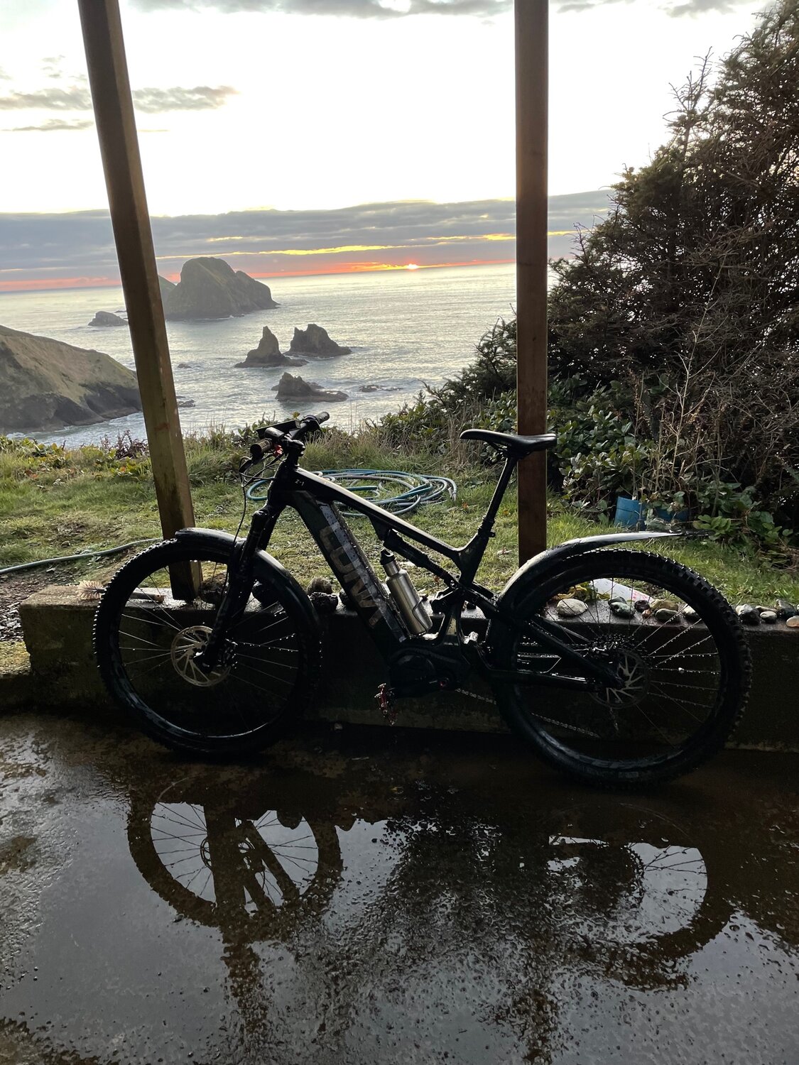

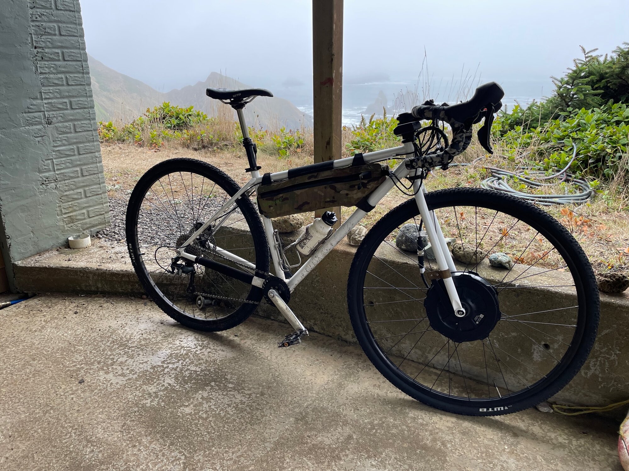

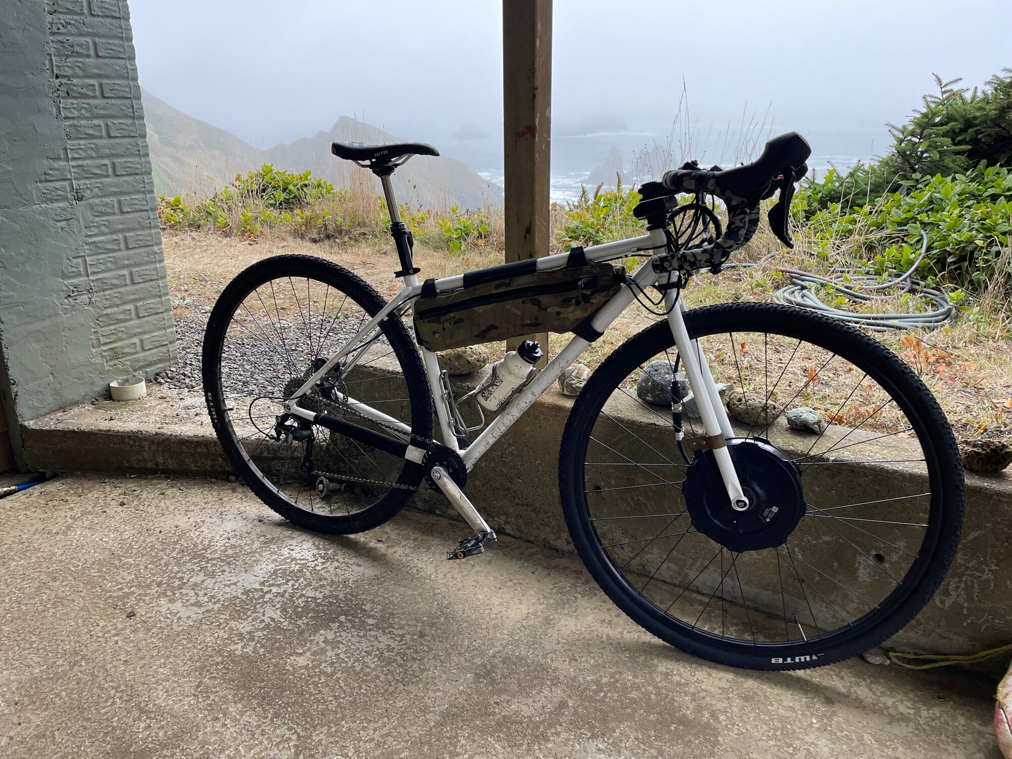

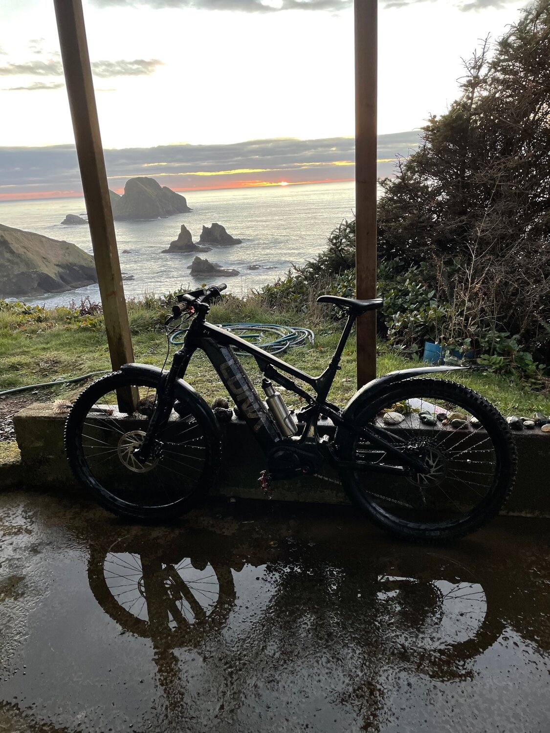

Perhaps this will illustrate how I feel about hub and mid drives as it shows the distinct differences between their overall setup?
I agree with Al that folks all down on hub bikes have either never ridden one, and frankly wouldn't work as well for their particular riding terrain/style, or had a cheap one to start out with that never was underperforming due to cadence sensing, lack of watts etc..
And pardon the rat's nest of wires on the white bike I hadn't cleaned them up yet.
So would you agree that your hub motor is naturally more zippy than your mid drive?
Do you have the ludicrous controller or is it the stock controller? The newer v2 controller pushed out 4000 watts.

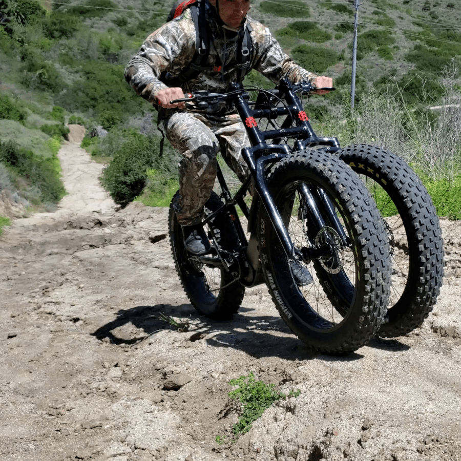

That is a massive front hub motor. So again we're comparing a Porshe Turbo to a Honda Civic type R possibly?
I can't imagine all the weight in the front wheel , taking sharp turns and the bike appears to be light. I don't hate hub motors but I can't agree that mid-drives are naturally "less zippy" than hub motors when there are so many other variable at play here.

That motor @JRA is using up front is a hub motor for sure, but it's not like what a lot of us are thinking of when we say hub motor. There are 2 different types of hub motors. Gear driven, with their 5:1 gears built into the hub, and there are direct drive hubs (without gear reduction), like the one shown on JRA's bike.
Again, there are (a lot of) compromises in play when deciding which might fit your application better. Without writing a book on the topic, MY opinion is that on typical 48-52v, a direct drive hub is not going to be nearly as "peppy" as a geared hub - until they're both up over 10mph. The Direct drive motors start getting pretty efficient at 15mph+, which is where the geared hubs are starting to run out of breath.....
THEN, you add the fact that the direct drive motor has better heat dissipation. The big side covers actually help dissipate built up heat. The geared hub motor, buried inside the much smaller case with NO air circulation doesn't have a chance in comparison. Who cares? The guys that want to go REALLY fast that can put 72v+ volt batteries on them (e-motorcycles), and the guys that are commuting longer distances as fast as they can.
My vote, regarding "zippy" would be geared hub. In JRA's case, he might not want a "zippy" motor up front like that. My guess is he's just looking for a little boost - boost that won't easily loose traction.
