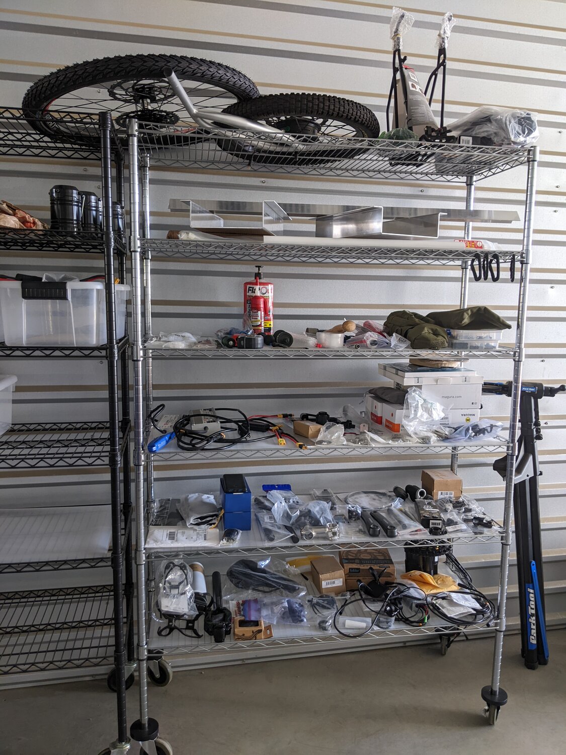

The very last part needed for my current project is getting ordered today: The KT-LCD3U display. Waiting on frame/fork scheduled to arrive some time in November.

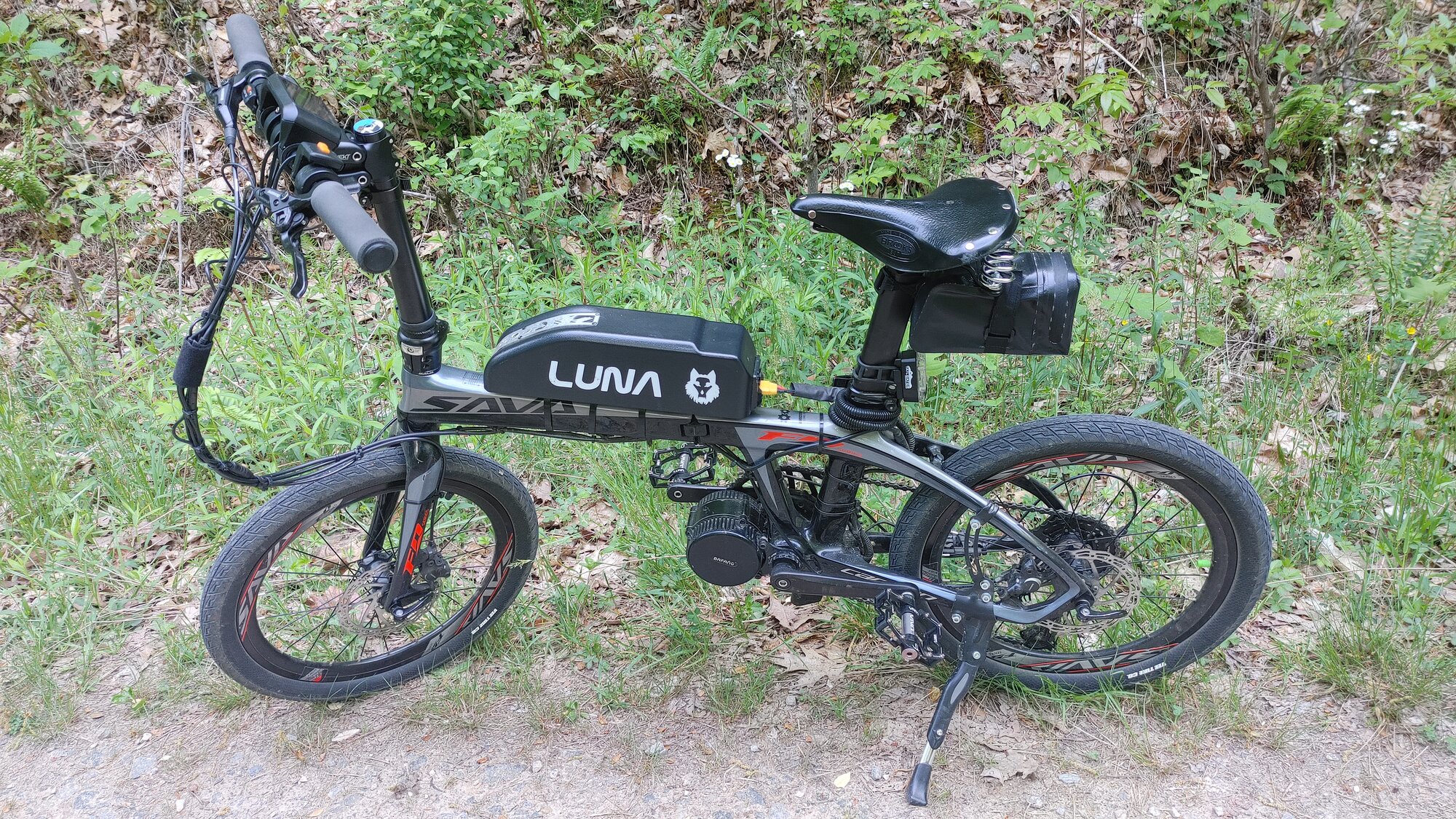

So I sold my mid drive and the gentlemen who bought it was doing a test drive was pulling up a steep hill in the highest gear. I said you need to understand how mid-drives work. He didn't seem to understand the concept of starting in 1st gear at a red light and using lower gears for hills.
Then he started to shift all gears from 11 to 32 while standing still on the bike. I warned him not to shift gears while the bike is stationary from the 11 teeth cog to the largest 32 teeth. Imagine if he had throttled 120nm of torque like that? The gears would have done an extreme jump from 11 to 32 under torque.
Then after some learning curves I convinced him to try a top speed run on a long flat road near my house he then proceeded to get to about 36mph/58kph in top gear and complained his legs were just ghost pedaling at 36mph/58kph and how he wanted to change the cassette. I told him for a natural human to pedal that fast and 'feel the pedals' you'd need to a front chain ring the size of a *metal garbage can lid, since the front wheels are only 20inches. The bike already has a 52T front ring a 11teeth rear at it's smallest. He could try for a 10 or 9 rear but then you introduce a lot of torque to just 9 or 10 teeth . It took me many hours to get the chain ring dialed in-just right for the 11 tooth so there was zero torque slippage at full throttle in all gears. 36mph/58kph on a 20 inch folding bike is plenty fast enough IMO.
He purchased the bike off EBAY from me and I was close to refusing to let him take the bike and send him a refund. I told him if he feels uncomfortable with the bike , full refund right now off ebay. I'll keep the bike. But he said no he really liked the bike "it's super fast" he said and was starting to understand basically he has a manual transmission car.
After following up on phone with him I suggested to install a gear shift sensor and possibly consider converting it to a IGH. He said he's looking into getting an IGH from his bike shop. I said for his needs that would be the best option. I was planning on adding a ROHLOFF to it myself but after dialing in the chainring which had no slippage I really didn't need it but WANTED it.
His last bike was/is a pedego hub motor bike that his wife uses.
