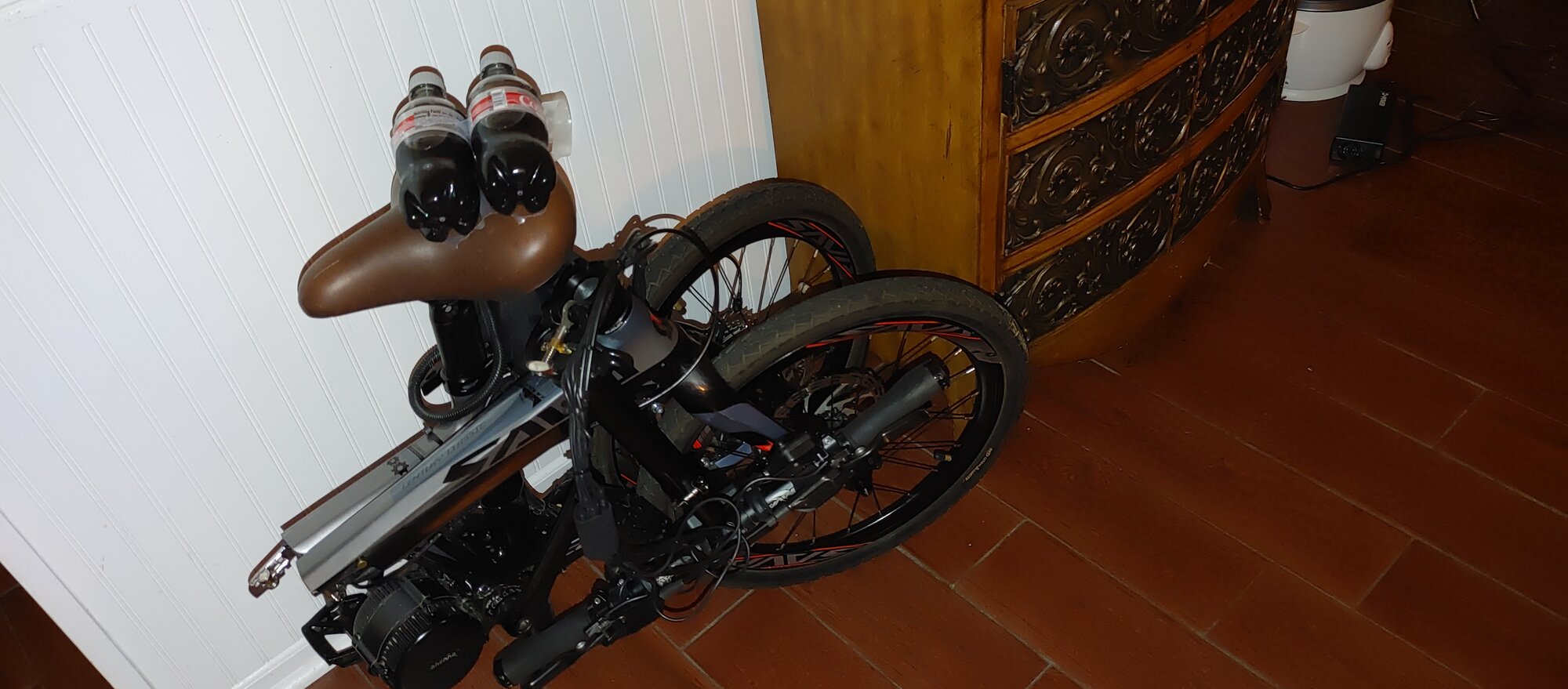

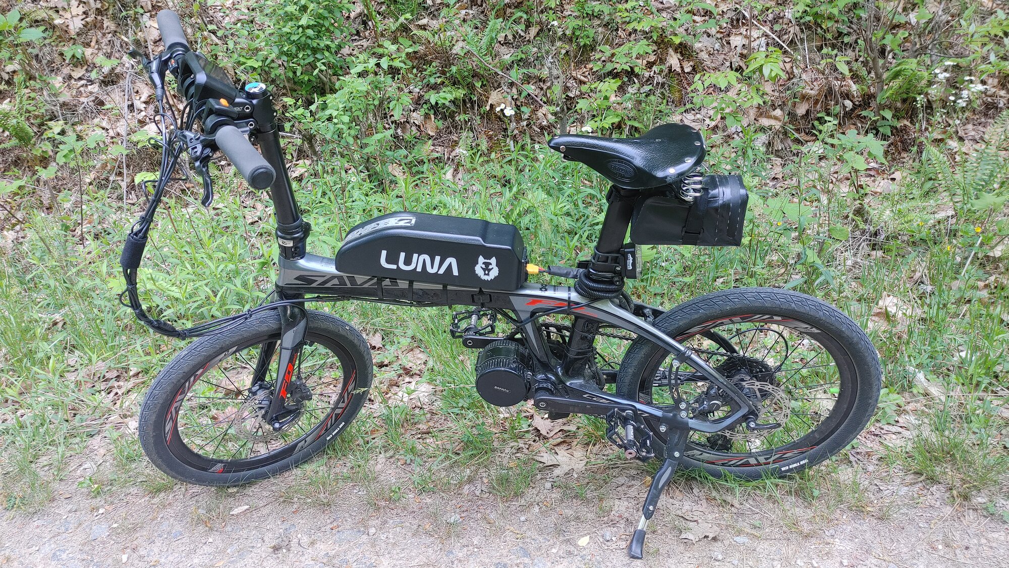

Here is the bike I built , starting with a SAVA carbon folding bike.
36mph top speed , throttle only on a flat road , climbs any hill with throttle only , total weight 40lbs. 120nm of torque and a peak wattage of 1280watts.
I took this bike to an EBIKE shop here in Asheville for a IGH possible install , all they sell are hub motor bikes and the Bosch mid drives among regular bicycles . All of the mechanics fell in love with the bike and the one consistent comment was "man this thing is fast."
I could've made her a little lighter by swapping out the heavy spring brooks seat and the super heavy suspension stem and possible get a carbon fiber handle bar. I'd imagine I might squeeze it down to 35lbs perhaps? But it's not even needed , at 40lbs with a rider weighing 220lbs the thing is crazy fast , ZIPS up hills , ZIPS around corners , ZIPS right along side cars. I think I'll rename her "Zippy."
It cost me around around $3000 to build.
