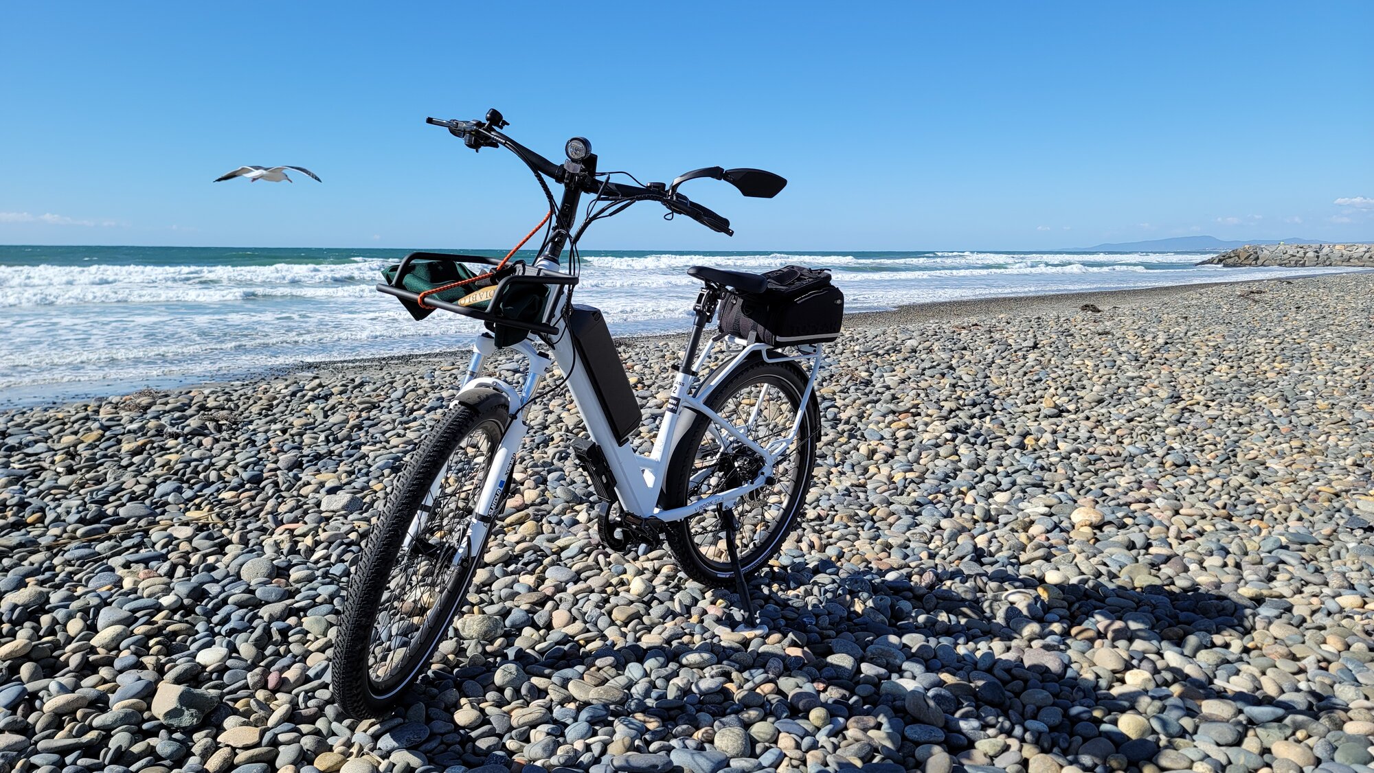

Odd thing is, not once on today's beach trip did I think about efficiency. Not in the stiff headwind. Not on the short but steep hills up to our terrace.
Just grinned the whole way there and back, the hub motor and I working together at 14-18 mph most of the time.

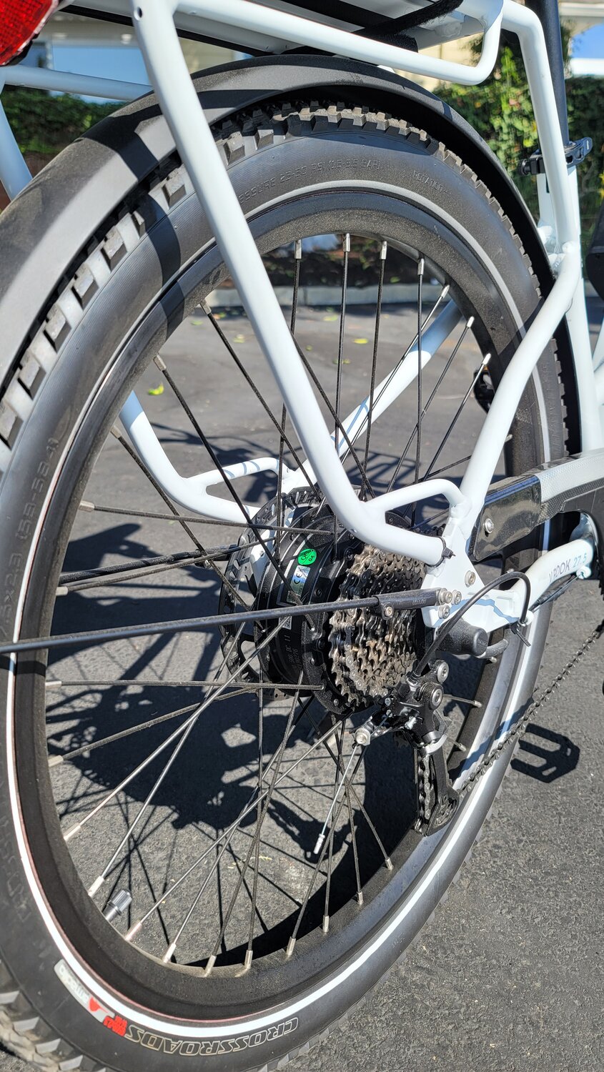

Oh look at this picture , a rear hub 1000 watt mac geared hub. I wonder who built it?:cool:
You're bike looks awesome and if you're having fun than that's all that matters.

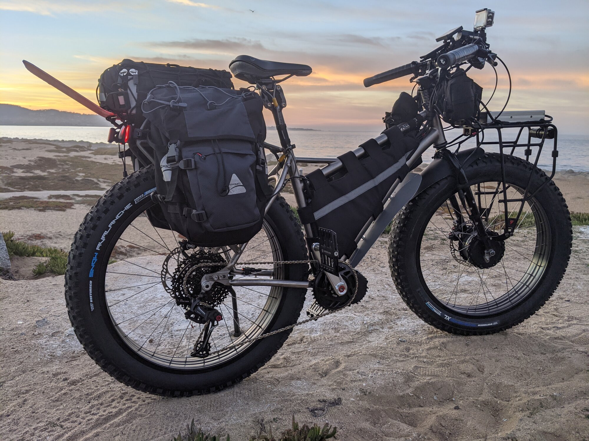

In builder circles, its generally accepted that mids are more efficient than hubs in terms of the power they eat. Recently I have been playing around with efficiency on very long hauls on my 2wd cargo bike, where I have a front hub and a rear mid. Just in looking at the amps and watts needed for the two motors individually as I toodle down a long, flat straight stretch of road, I've been playing with balancing the output between front and back to improve range. Looking at the outputs, I've been reminded of how mids sip power at cruise as well as under pedal assist. However, you can tuirn this on its head by hammering the throttle, or even using the factory programming and not rolling your own that is aimed at converting electricity to forward motion and minimizing how much is instead converted to heat.

Having done a few generations of 2wd bike myself, I can say they are pretty awesome. I have years, and thousands of miles, commuting on a hub/hub version, and my mid+hub can go places no other 2-wheeled bike can.

Thanks! Will definitely play around with the Grin simulator. Interesting bike and tuning challenge you have there.
Very impressive ebike and outfit in that photo. You've clearly been at this a while. Will be spending some time on your site.
