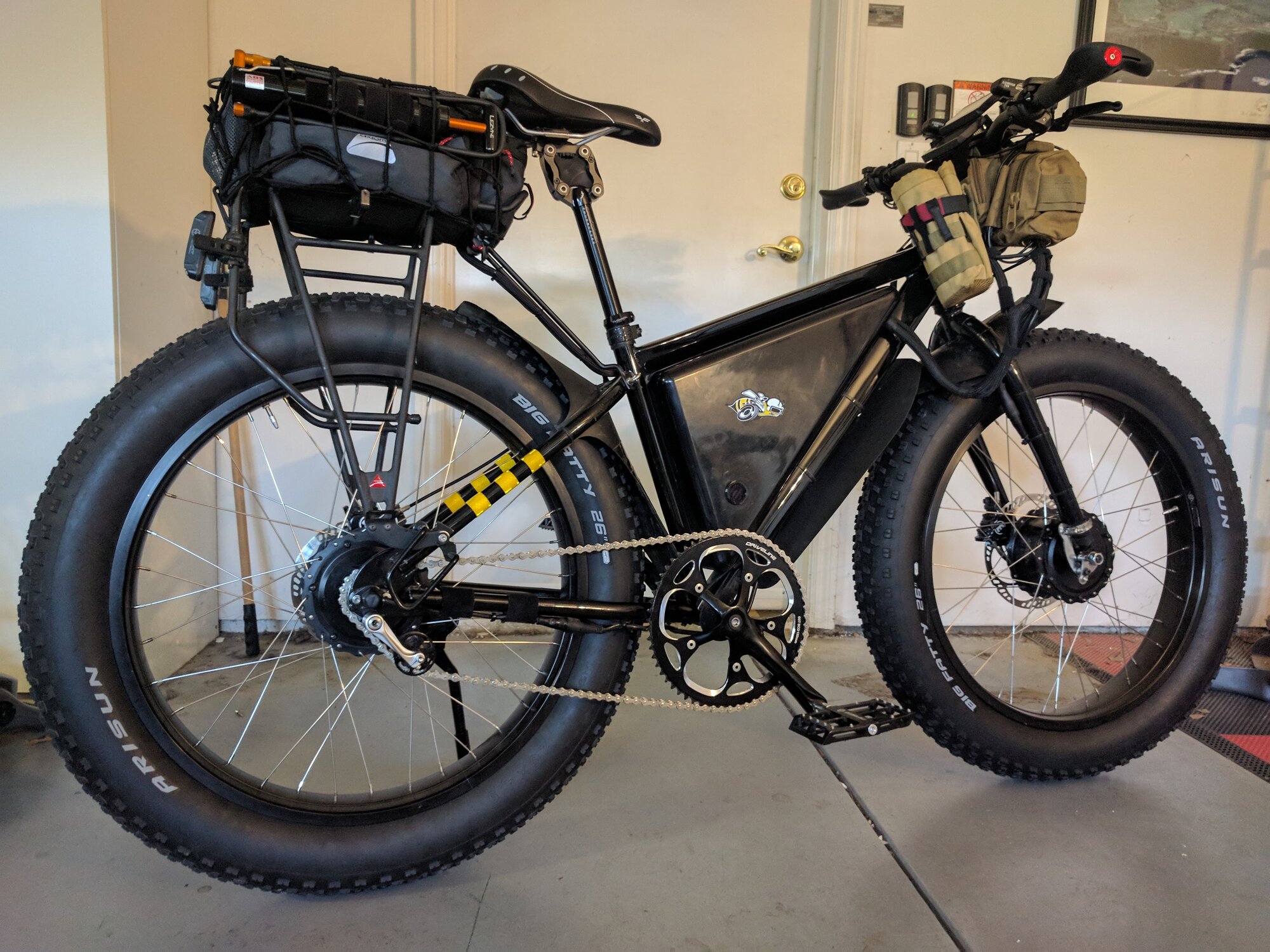

Want evidence of that contention? Look at the front chainring. Ever see a ring that big on a fat bike before? More? Look at the derailleur. Thats a short cage derailleur. Why? Because there is a small cluster in the back, which you can also see and which is also pretty much unique for a fatty.
Or rather its almost unique.... Those wheels on the orange bike were taken off of a predecessor whose frame I cracked. Here it is. Single speed so the rear gear was fixed at 16T. To get it geared so I could pedal hard, I worked my way up to the 60T chainring seen below.
These bikes are built for pedaling on entirely flat land, which is where hubs excel. Don't equate speed with motorcycles. One does not follow the other.

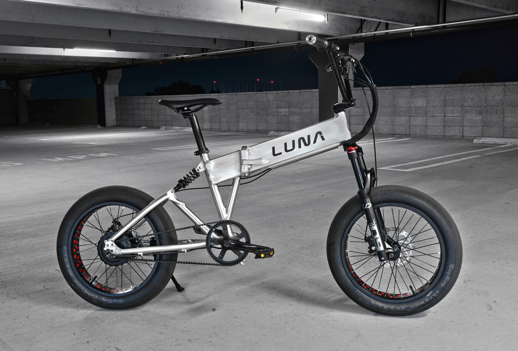

That little bike in the video is powered by a 3kw mini Cyclone kit. They were powered by a 60a Kelly controller that Luna was doing the programming for pre-sale. Want to see another one (I didn't spring for the Luna Tick alloy chainring in that video)? Want to see the instructions on how to install it? They are on the Luna forum. I wrote them. You will see this bike there in the pics.
This was, by the way, October of 2017, which is two months after your video was taken (which I watched at the time, pre-sale. Battery in it was a 52v 12ah Samsung 25R pack). In that video, the motor peaked at 62a. I didn't hear a wattage peak in the vid but mine peaked right at around the same amps. Peak wattage was about 4000w, not the advertised 3000.
So... rather than you watch a video and read it wrong, I can just tell you how they worked.
The Mini Cyclone had very high rpm's which is amply demonstrated by the guy holding it in the air and letting the motor spin it up. But... they are gutless. All horsepower (rpms) and no torque. Apply a load to the motor and it bogs down. To solve that It is essential to downshift at a stop 3+ gears, and then row thru them as you came off the line and get up to speed.
If you tried to run that motor under load without managing throttle - so those 60 amps are only used to make it go forward - it overheated and the controller shut it down. Then you had to sit on the side of the road for 10 minutes while it cooled enough for the controller to let it come back on. Once I learned how to feather the throttle (PAS did not exist) I was fine so long as I stayed off my 12T gear and let the motor keep the rpms up... after ramping up thru the gears. Top speed was about 33-35mph in that next-to-top gear on this bike, bearing in mind my 250 lbs, which were a major limiting factor. Also necessary to stave off overheating during my commute even after feathering the throttle were heat sinks all over the motor, as you can see installed below. These were worth quite a bit. Something like 40 degrees of surface temp but they made the difference internally between a shutdown and a successful arrival at the office from home.
But put all that aside... Cyclones were and are known to taco chainrings and tear chains apart (zoom in on that first pic and look at what kind of chain I used for the primary off the motor). The video you liked so much shows a guy spinning the motor under zero load. But look at the very end of the vid when he tries to ride it. They ended up fixing that as well as they could by the time they started selling them, but bottom line is you cannot watch a motor whiz around with no load and have the slightest clue what it will do with a rider on top.
So... you row thru the gears with that motor. Which was kind of fun as the bike - with no PAS and no display, was kind of like a little crude sports bike all rough around the edges. Remember this was 2017 and there were different expectations of what a DIY bike should be. Just look at all the zip ties I used.
So... THAT is how a hub motor - with sufficient power - beats a mid drive off the line. Hub motors need no shifting. Their acceleration curve is smooth and continuous with no gaps. Mids - even with a gear sensor - need a pause in acceleration to shift, and when they do they have to ramp the power back up. It sounds EXACTLY like a car and it has exactly the same negative effect in a drag race.

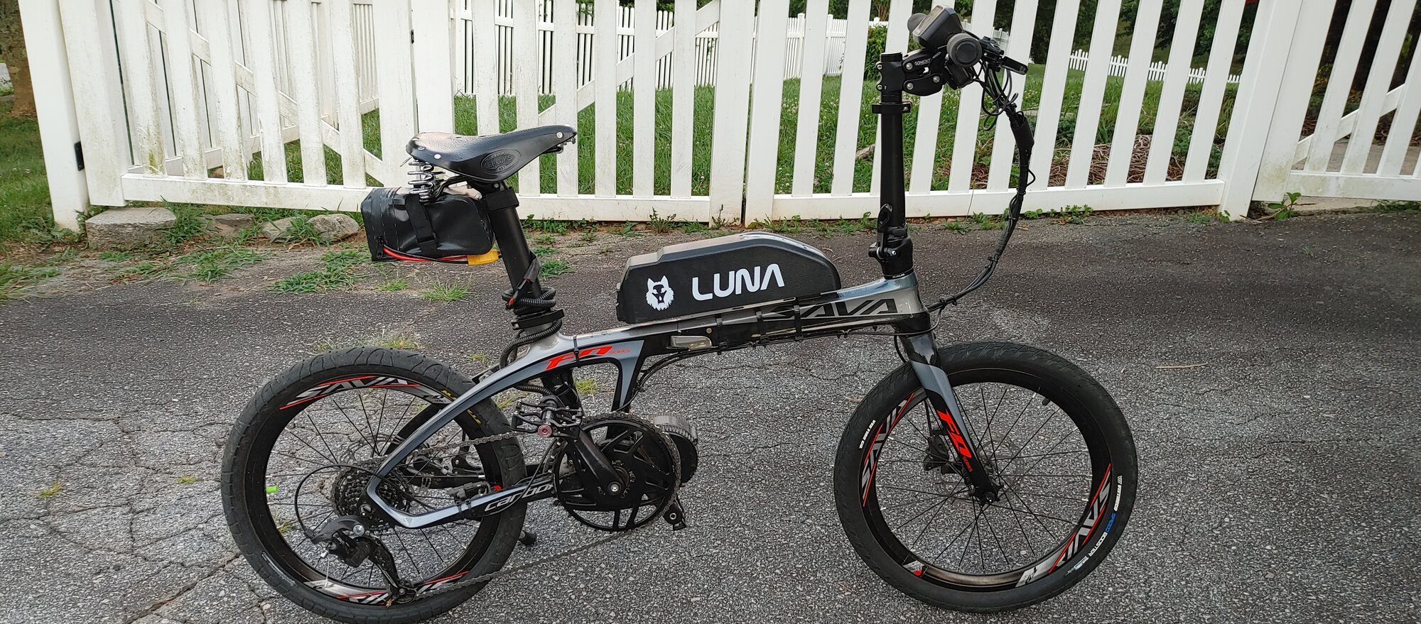

That looks to be a BBS02? What Size front sprocket is that? How about the rear?

Solar Cabin? haha I wish. It's a 4000 sqft house.
Right now is a Lekkie 52T in the front but I have a 28T lekkie I can put on it as well. The 28T is for super fast hill runs. It's pushing 1280 watts peak and is a 750 watt BBS02 running a 52V battery.
The rear cassette is a 7 speed shimano 11teeth is the smallest and the largest is a 32teeth. I do have an old stock mega-range cassette I got from Japan it has a 34 teeth sprocket. But right now the chain line is dialed is so I don't get torque slippage on the smallest cog. That's the biggest problem was putting 120nm of torque on a 11 tooth cog it would slip. But now it's solid I had to use some BBS02 spacers for the Lekkie chainring. Now it shifts smooth under every gear , no gear slips under high load and torque.

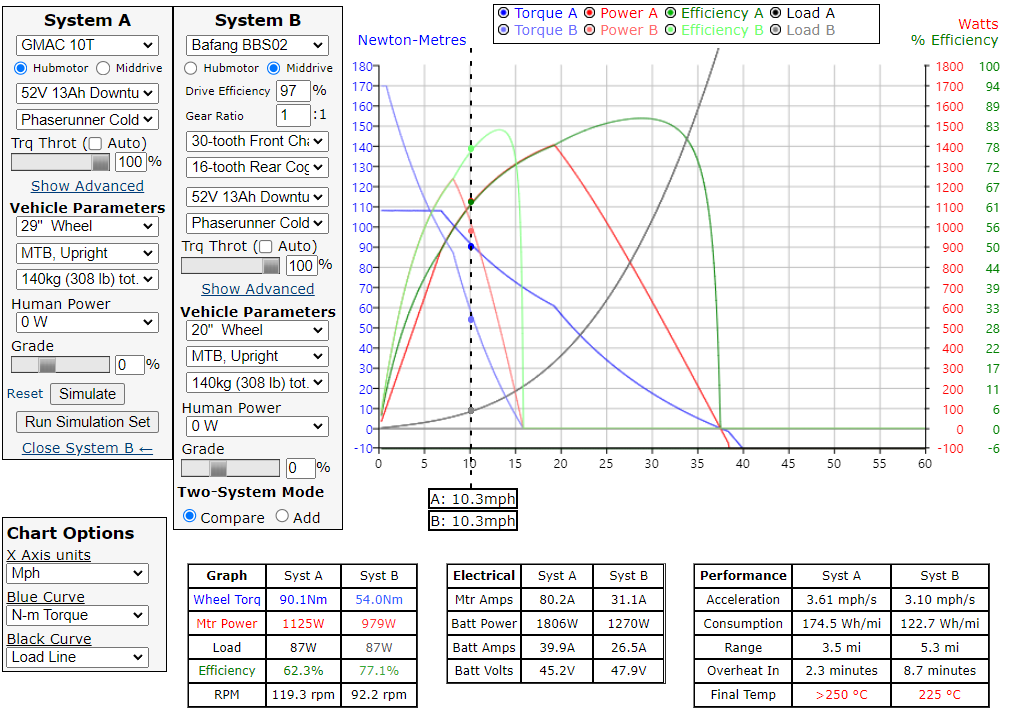

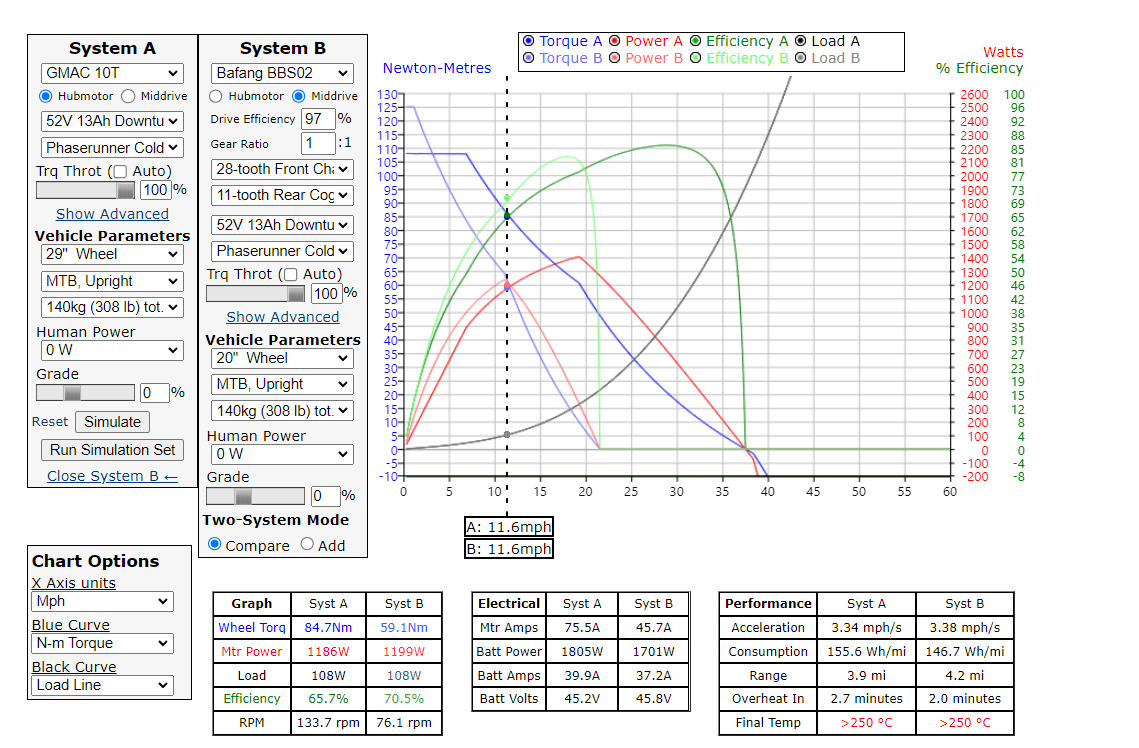

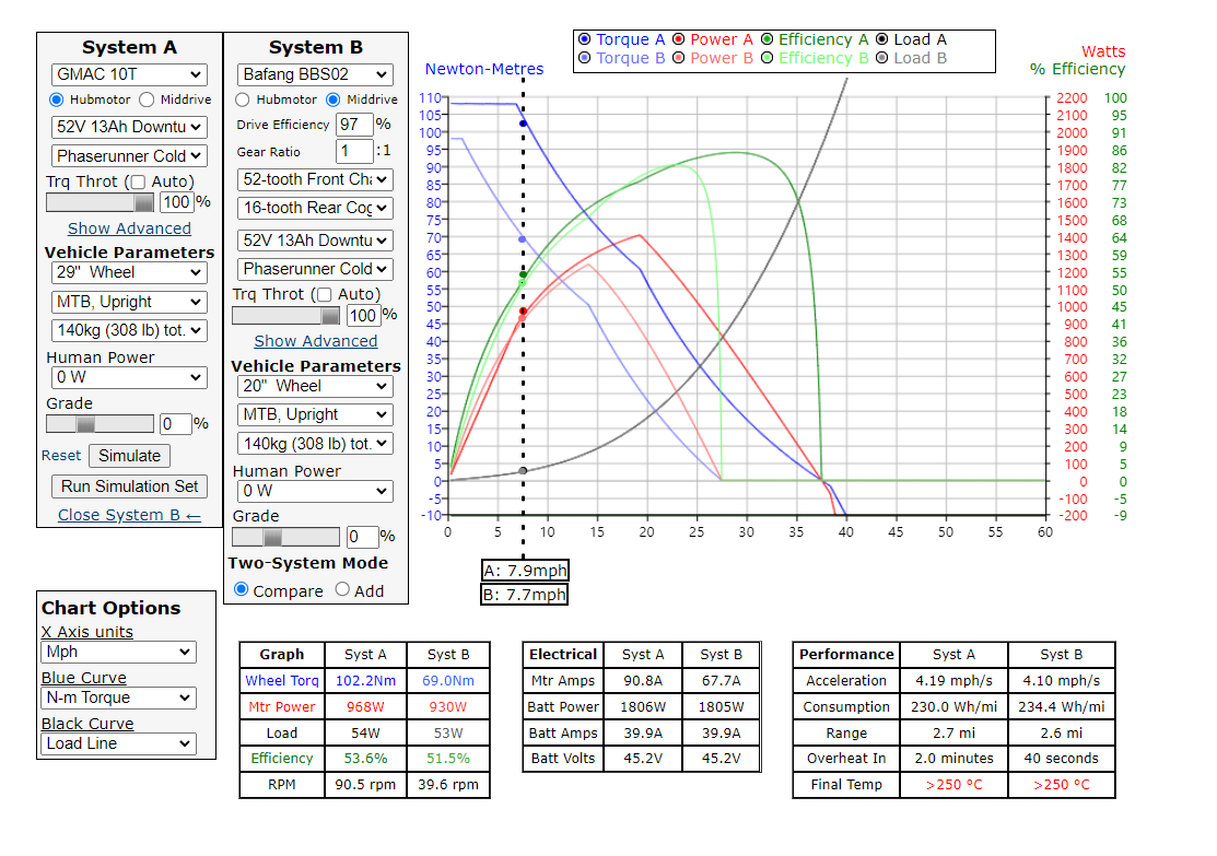

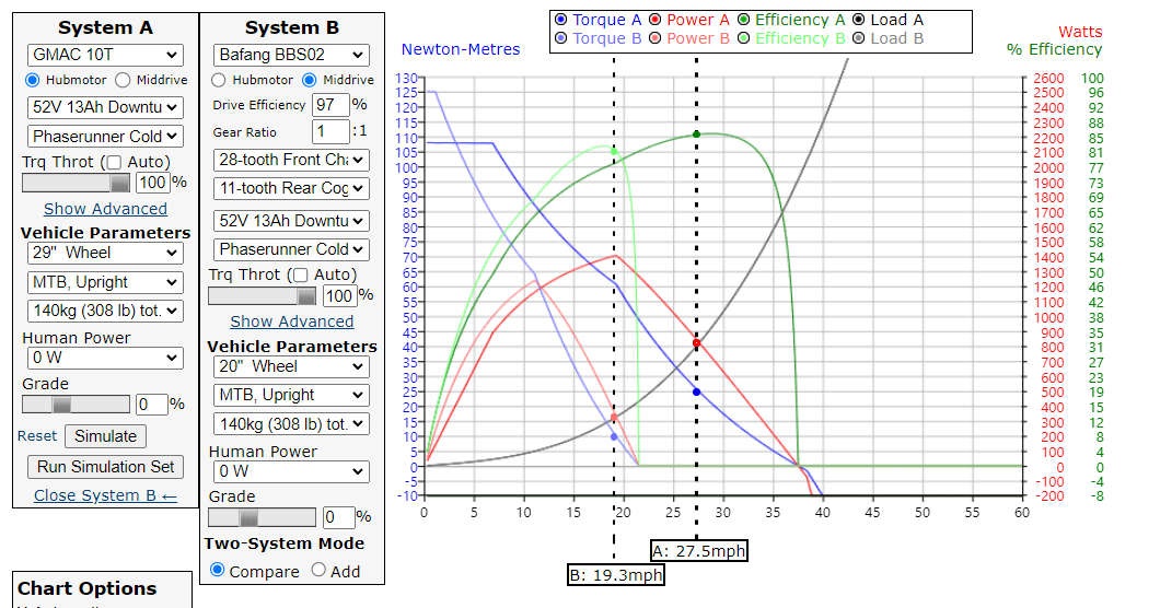

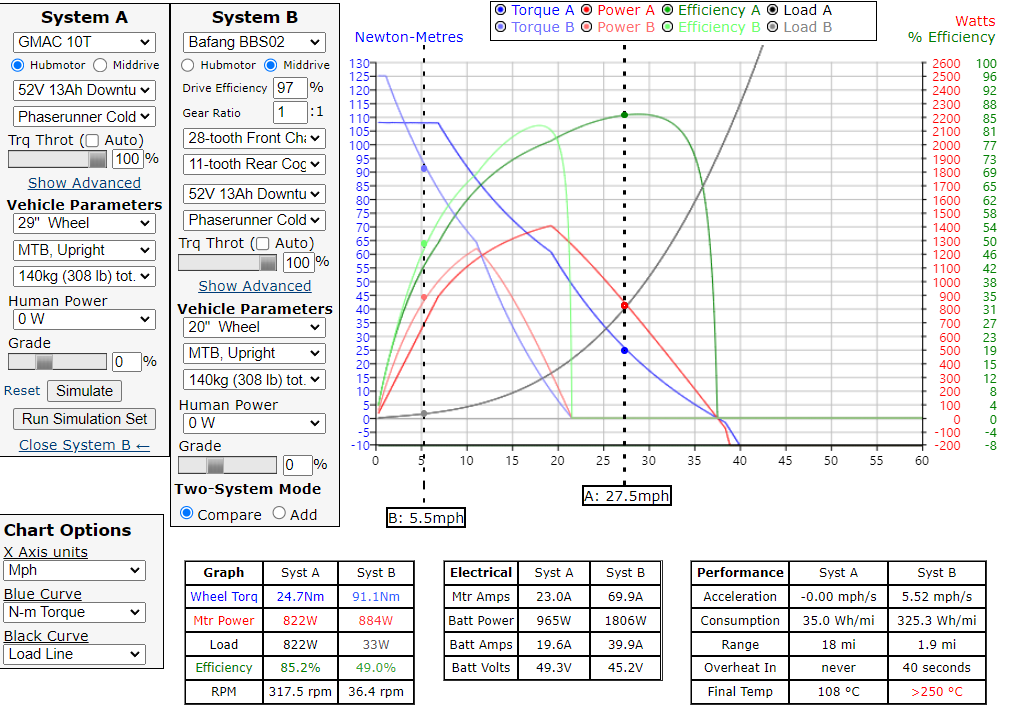

Here is a Grin Motor Simulator anybody can play with. https://ebikes.ca/tools/simulator.h...t_b=PR&wheel_b=20i&mass_b=140&hp_b=0&axis=mph
I picked a 52t front sprocket and rear sprocket to allow mid 20mph (per scoochbooch's earlier post).
If you use your mouse to move the vertical dashed lines in the graph, you can see the acceleration at different speeds.
For this example, the BBS02 has an advantage up to around 7mph and then the GMAC takes over. Note the wheel torque of the BBS02....its not 120nm
This comparison is being VERY generous to the BBS02 as it is using a phaserunner motor controller which is WAY better than the motor controller on the BBS02 (i,e battery amps are limited to 25 vs 40 on this chart)
It has the controller from LUNA on it . I believe it's 1300 watts max and running 52v battery.
Now try the 28tooth front chain ring and different rear cogs.
I would never start from a stop in the 16 tooth cog and a 52t front that's too much stress on the motor. THAT'S THE ENTIRE REASON MOST BIKE RETAILERS SELL HUB DRIVES , they're idiot proof.
Try a 52 and 28 tooth front and 32-34 rear with 20inch tires.

I can guarantee you that the phaserunner is more powerful than the luna controller.
Wow, you have a 52V battery that puts out 58.8V at 25amp. I have a wolf battery as well and it doesnt do that, Did you have to pay extra for that?
I thought you stated above "NO SHIFTING", you also claimed if you geared for mid 20mph, you would blow away a dual hub drive (note that I am using a single hub drive for this comparison)
Cant go below 30t in the front, with a 30t, the BBS02 starts to loose at 10mph

So the mid-drive loses after 10mph , which was the entire argument , the mid-drive was faster in a 10mph sprint across the road. Wasn't that the original argument?

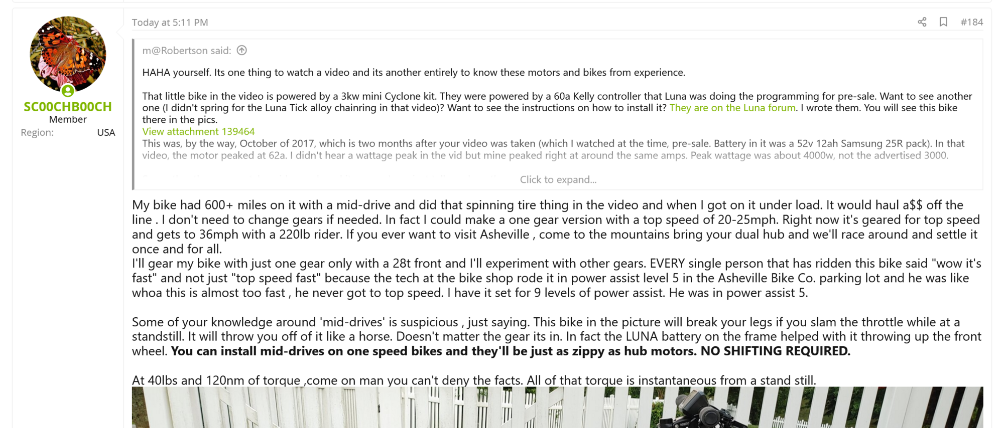

You did actually claim in post #184 that you could build a mid 20mph one speed mid drive...that would be a 52t front chainring and 16t rear sprocket. When I post this setup, you claim you would never use it.

POST #184 right here ,nothing about a 52t teeth front and 16teeth rear you're putting words into my mouth. I said "I'd experiment with a 28teeth front and experiment with the rear cog size.
Well yes, I did put words in your mouth because you were speaking gibberish. Doesnt mater what actual gears we pick as long as the overall ratio is equivalent.
If you pick a 28t front, with an 11 tooth rear, max speed will be 19.3mph. You said 20-25mph...I guess thats close enough but I was assuming 25mph.
With that combination the BBS02 (with more powerful phaserunner which you dont have) is faster to 11.6mph

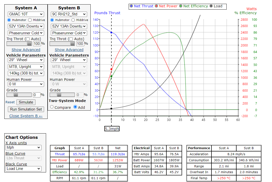

Im working on a dual hub motor grin simulation....stay tuned

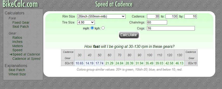

Which is why it seems weird -- but entirely expected -- the crazy nonsensical fairy-tale nonsense mid-drive fanboys seem to outright fabricate in their attempts to throw shade on hubs.
Or rather its almost unique.... Th Single speed so the rear gear was fixed at 16T. To get it geared so I could pedal hard, I worked my way up to the 60T chainring
Which ends up surprisingly weaksauce at 1:3.75... It's all about ratios and a 60 means nothing with a fat-ass 16 rear. Which makes me feel out of touch, don't think I've seen a single speed with more than 14 rear since smaller rear + smaller front == less material == cheaper to manufacture.
Also though as a single speed that has to be an absolute pig to pedal if you run the battery dry accidentally or have a failure that takes the motor our of the equation. That's where I screwed up re-gearing mine when I added the 53 tooth chainring but keeping the stock 12..32 cassette. I really didn't think about the low end, and whilst an 11..36 only gets me 1:1.47 vs the 53:32 == 1:1.66, that's the difference between "suffering" and "Yeah, I got this."
And at the high end I might "only" have a 53 on the front of mine...
But with the smallest an 11 that works out to 1:4.82, a good deal more than you're getting out of that 60 tooth. Even with the 12 it was 1:4.12, higher than your big 60 is doing.
It's all about your ratios. I'm still arguing with myself over swapping the largest cog for a 40 just to make unpowered travel less of a headache... though that means I'd have to add a hanger extension as to support the 36 I've got the B screw all the way in.

on my OP this link was in reference to the quote then you went off on a tangent how I claimed my bike was this or that amps

This will likely be my next e bike. There is a gentlemen on here selling his and I'm to pick it up Dec 1st. Although it's tempting to buy one now as they're back in stock at Luna. For the price to performance I don't think I could get close to this price build with a mid-drive , unless I had a free donor bike.

I remember the 60x16 achieving the speed on this chart at about 80 rpm cadence. Plain/simple I can't sustain 90. I do gps speedo readings specifically cuz the displays are never quite right; and really, this calculator is never perfect either. I bet my 175mm crankarms on that bike had something to do with the equation as well.
It means less. Not nothing. See chart above. Also that bike was built years ago, before Bafang released the cassette version of the G060 motor. So the only option on a frame built for the single speed freewheel version of that motor was... a singlespeed freewheel. On a British/standard thread freewheel, the smallest you can get without buying garbage is 16T (the Shimano MX16 being the best unless you want to really spend and get one from White Industries). Metric BMX single freewheels go down to 14 but Bafang doesn't use metric sizing. And if you toss quality out the window and use the Chinesium wheels that extend/hang out over the body, this is what you can get.

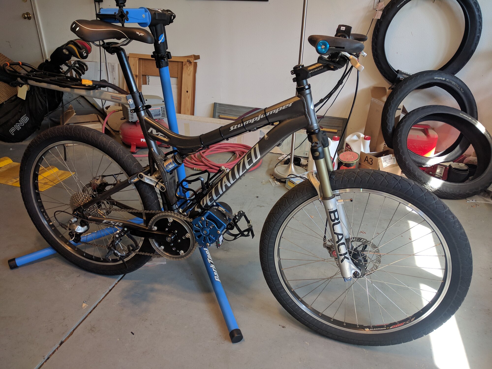

And... the orange bike uses the same wheels as the black bike, but it is a 190mm frame. I removed the 165mm freewheel motor core and replaced it with the cassette version, which allowed me to put on a SRAM 9 spd cluster. A spacer on the brake side let the brakes fit the original motor casing.
