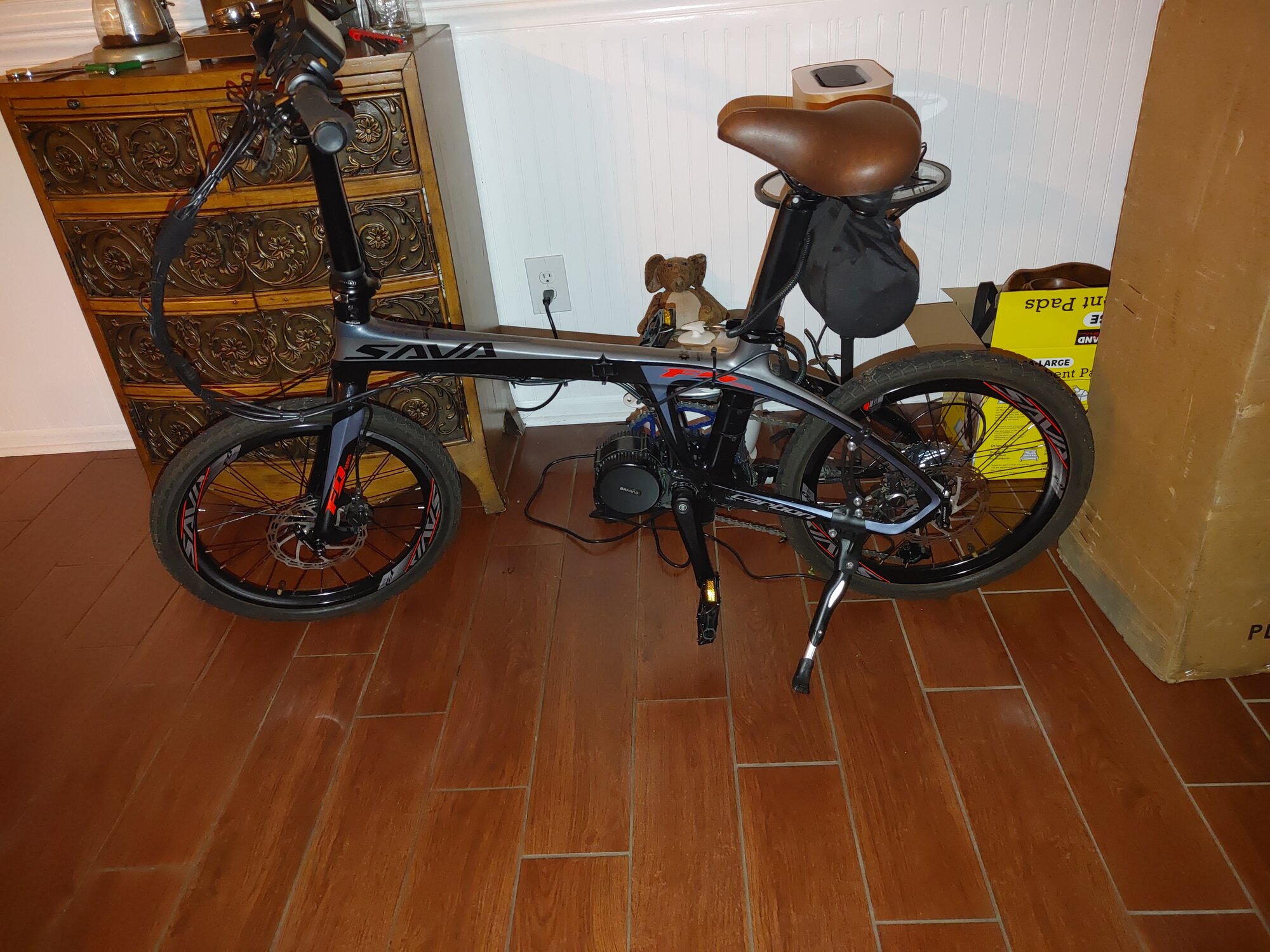

I was saying if I move the left throttle in just 1/2 way the bike will jump up off the ground like a wheelie and throw the rider off , it has that much torque
the bike weighs about 22kgs with 120nm of torque using just the saddle bag battery
QFT. Um, so the bike weighs nothing? FFS a battery typically weighs 10lbs and most motors 7lbs so your frame and accoutrements weigh 3lbs? Me thinks you need to retype…
My apologies the bikes weighs about 33lbs total which is about 14kg , I was thinking kg and not lbs
I'm using a 6AH saddle bag battery under seat which only weighs 3lbs
The donor bike is a SAVA carbon fiber at 22lbs , stock OEM , all gears , brakes everything
the bbso2 weighs about 9.5lbs
the samsung battery weighs 3lbs
I have a shark pack also which you can add to frame via a magnetic mount it weighs 9lbs (which would bring it closer to 22kg)
If I scrap the seat for a ligher one and the pedals and scrap the kickstand I may shave a pound or two

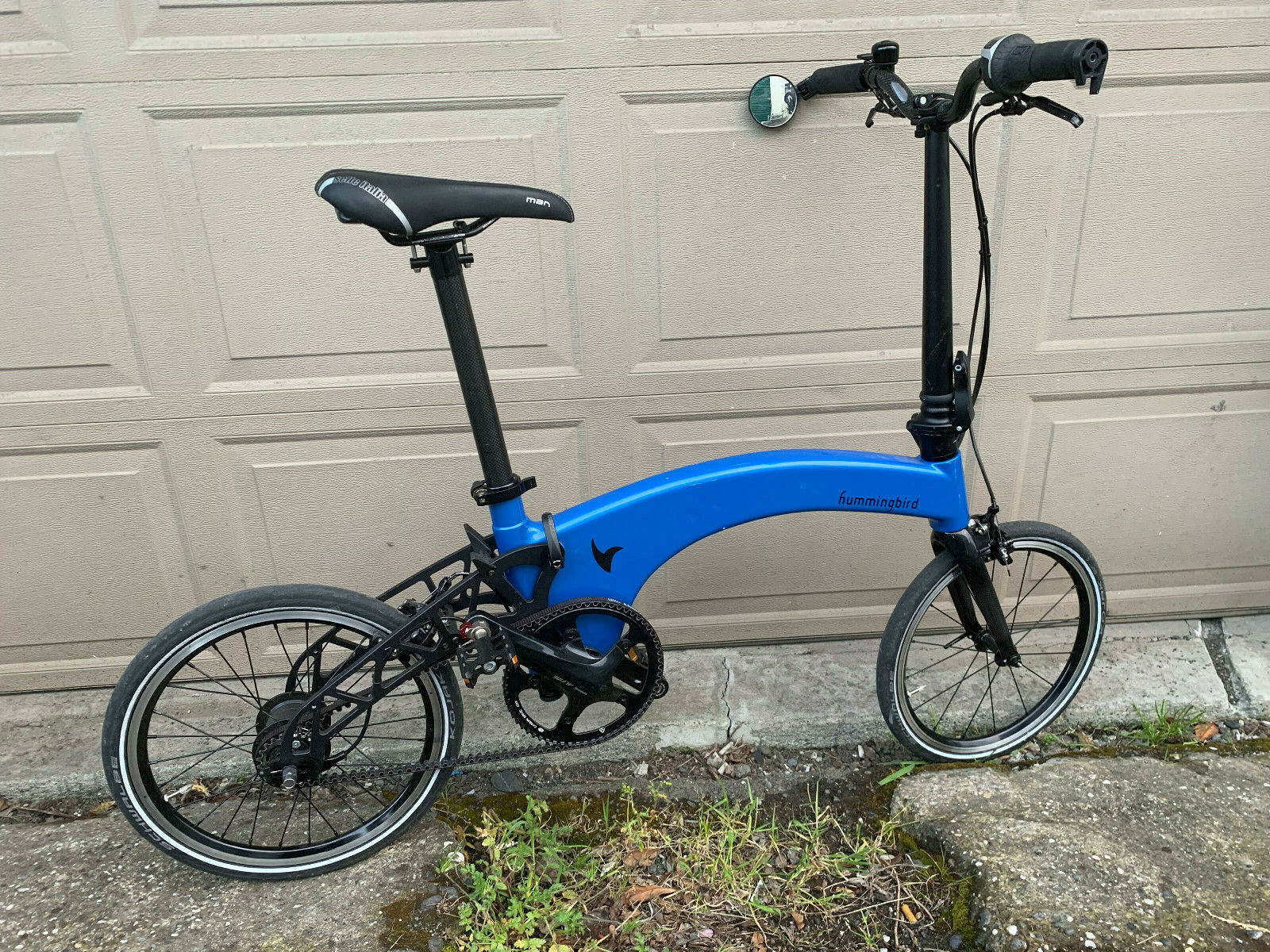

My next build I'm planning on using the 18lb hummingbird folder (18lbs) blue bike

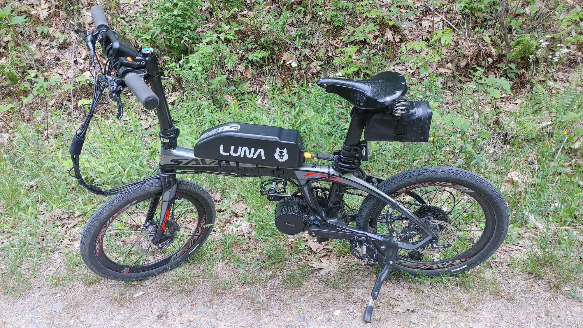

Okay, now I understand. That SAVA bike appears to have very little weight on the front, so I can see how it would pop a wheelie rather easily. That would contribute massively to a feeling or impression of high acceleration, obviously. In comparison, my ebike weighs more than 50 lbs and the battery is near the front, so it can't pop wheelies that way even though my motor has nearly as much torque (100 nm). I'm going to guess that if we were to hang 20 lbs from the SAVA's handlebar it wouldn't feel so fast at takeoff, because the rear hub would not be allowed to spin up as quickly; it would be forced to push the entire bike straight forward rather than allow the front to resist forward motion and rise up (the path of lesser resistance).
This was how it was when I sold it recently I put a Luna battery on the frame (see picture) that helped with front wheelies. Although it will still wheelie if you hit full throttle at a stand still. The bike was still fast. Top speed of 36mph with me on it weighing about 220lbs.
