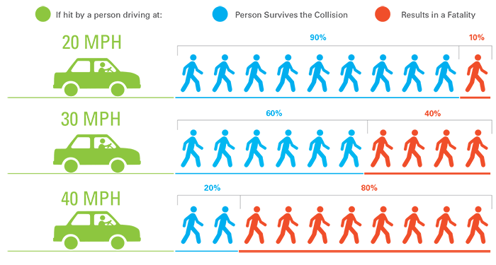

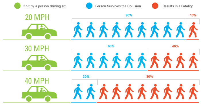

That is cool when you catch a little air launching a cargo bike! If you try the 42 ring, first try it in the lowest gears. If that looks, feels promising, then remove links from the chain and try it in all gears. I think you are right about doing 28. The idea sounds better than it is in reality. 18-22 mph is nice. I saw a collision speed/mortality chart for pedestrians hit by cars. The same would apply to hitting a curb, parked car, or USPS mail box at speed. I don't want to be in an emergency room. My buddies go 40 down hill on rural roads with rusted barbed wire at the side of the road.
