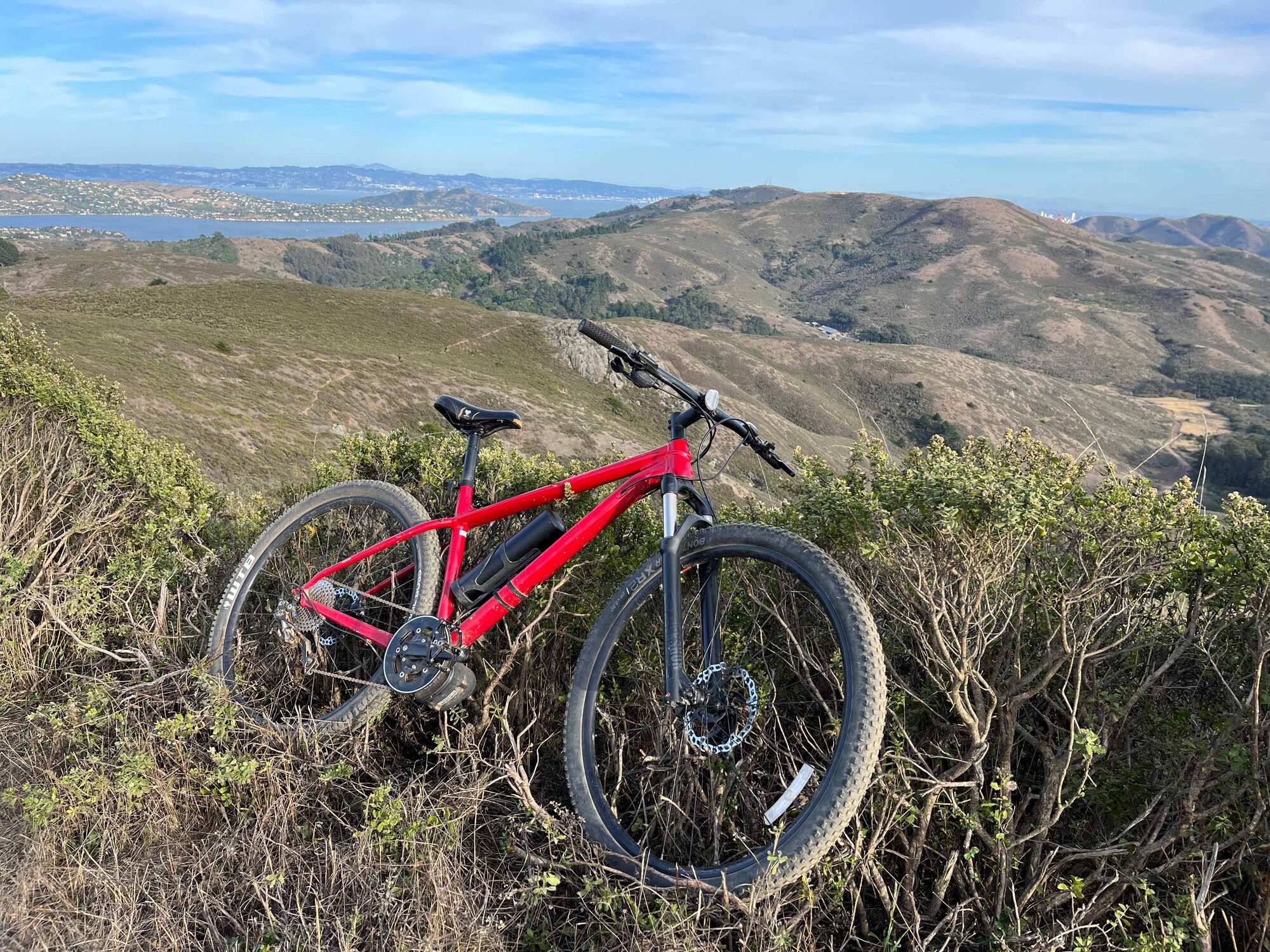

SOLVED!!!! The clunky pedaling was due to the 52T front chain ring. I put the original 42T back on, shortened the chain (stock bike was 52T) to fit and it works beautifully with no clunky pedaling no matter the cadence! Thank you all for your suggestions!!!!
I added a Tongsheng mid drive to a Tern Short Haul bike- its a 20" wheel, changed to a 52 front chain ring and 155 mm straight cranks. Not using speed sensor or brake cut offs.
This is my first ebike, first mid drive.
Noticed "clunky" pedaling from the start. The best I can describe it is- some resistance then feels like it slips when pedaling=clunky, on PAS 1 and 2.
At a higher pedaling cadence, it improves somewhat but still feels a bit "clunky".
I thought this is how it just is but very recently tried PAS 3 and 4- what an amazing difference! No more clunky pedaling no matter the cadence. Just smooth pedaling and incredible bionic legs!
I understand PAS 1 is minimal assist and imagined I would mostly be at PAS 2 with occasional 3 and 4 for boosts but the pedaling is so smooth at the higher PAS levels I don't want to go back.
For those with stock Tongsheng experience- do you experience some pedal clunkiness on PAS 1 or 2 too and just ride at higher PAS levels?

I had the original 170mm cranks initially and the same clunky pedaling. I switched to 155mm straight cranks b/c the stock angled cranks wide q factor and offset right crank was too wide and uncomfortable. Plus my other 20" bike has 150mm cranks- I'm short and the smaller cranks make for easier pedaling.
The PAS 1 is almost nothing and honestly, just kept it at PAS 2. PAS 2 I feel something and hear the motor but I have to pedal super fast to try and overcome the clunky pedaling which makes it feel like I'm not getting any assist at all if that make sense.
PAS 3 and 4 I found the assist to be smooth and powerful no matter the cadence.
Maybe I'll try swapping out the 52t for the stock...
