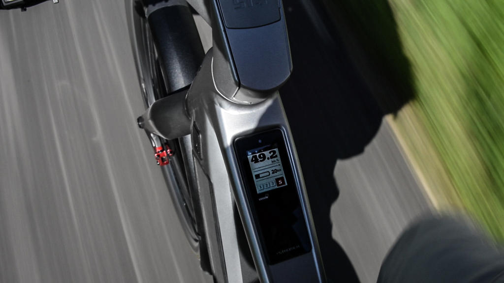

A question for this group: There’s virtually no information in the ST5’s manual about S mode. Does anyone know what the S support mode actually does? There’s 1, 2, 3 and S. Is it simply a “4,” with more assist than “3,” or is it doing something else?
As mentioned above (3) is already to strong for only keeping 45km/h. But in a situation as shown in the video, the extra power of (S) would be useful. Or simple if the road goes somewhat uphill or the wind comes from the opposite direction. There is the nominal power (eg. 850W), the average power (maybe 600W) and the peak power (above 1kW). The (S) mode raises the average power.

With the ST5, the problem is not to be too fast - then if you do so, you're in the fade out range of the motor. Then, you need much more own force then if you keep the speed slightly below (not more than 45 km/h). However, it was not so difficult for me to accelerate on an open road with one hand at the handlebar while the other hand holds the heavy camera.

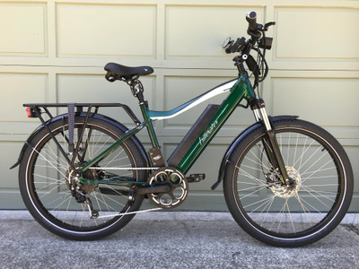

2 other ebikes that are much faster but imo lack the nice looks :
