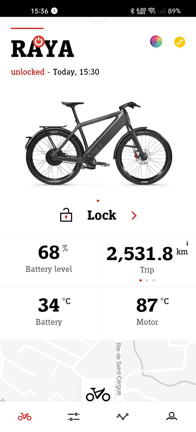

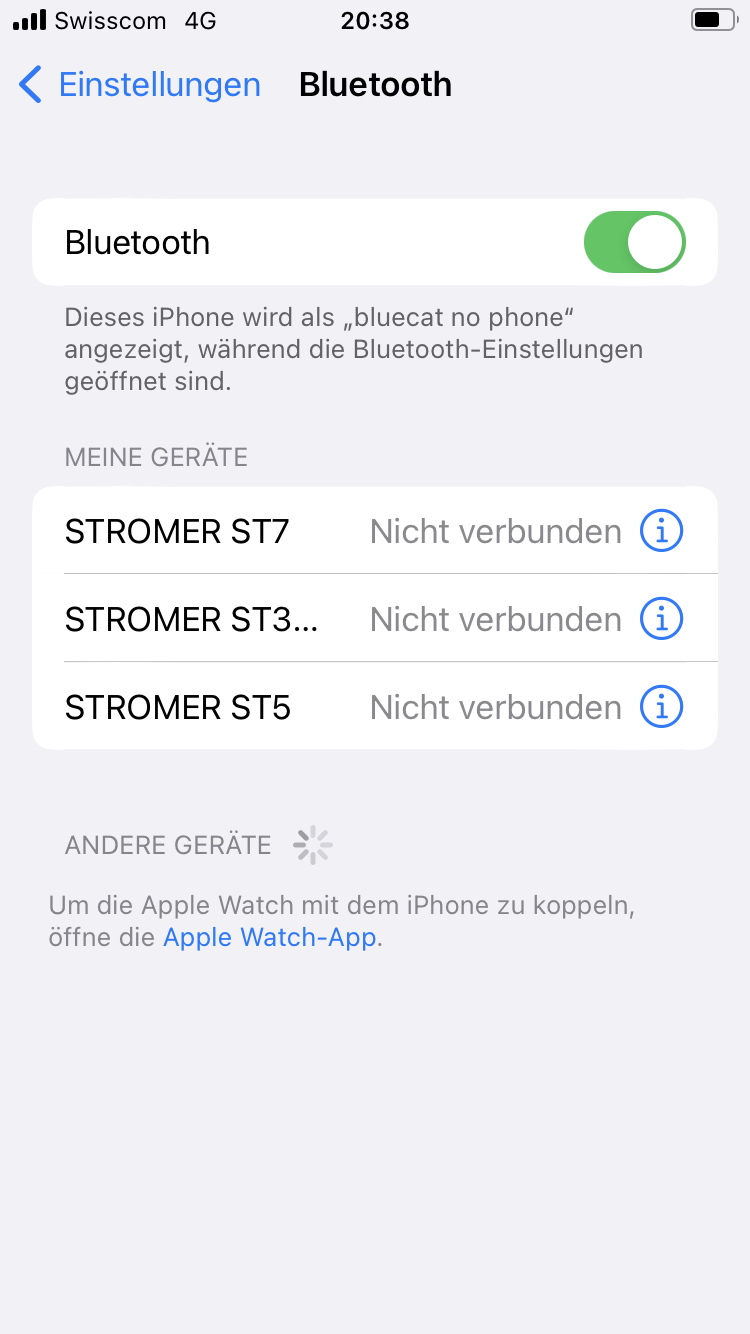

Thanks. It's all a matter of preference and, for me, there is a VERY good "reason for Sports-Mode on the flat":- it's fun. I do not find that using only Gear 3 is sufficient for my speed/acceleration sensitivity requirements to warrant paying 2-3 times more than other S-Pedelecs. Once I have had a taste of Sports Mode on the ST5 and now, for 20% of my ride, on this ST7, i cannot do without it. I will even stop and unecessarily rest the bike (wait 15 minutes and reboot) just to get the S-Mode back again mid-ride. Anyway. Here is my bike's Omni screenshot - straight after an S-Mode overheat. Does yours get up to 87 CELSIUS? Thanks Bluecat

Does anyone else have an ST7 where the motot heats to 87Deg C (190F)? I am taking mine back to the shop to plug in to Stromer HQ for checking. I think my motor is faulty............ ?

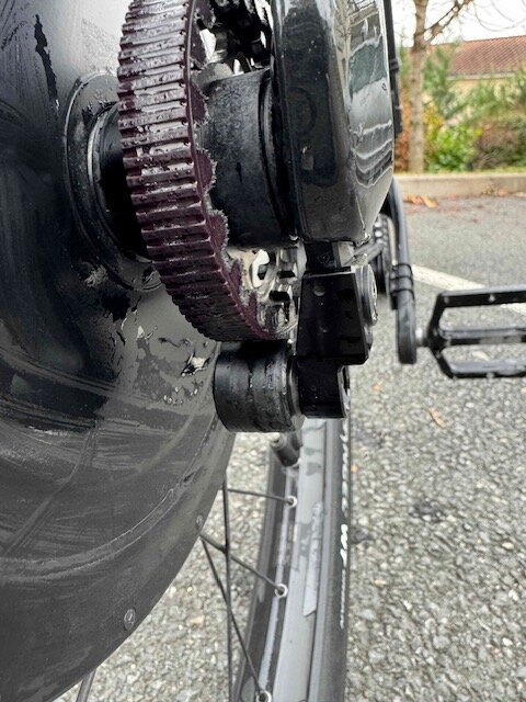

Stromer made a little a little useless but essential enhancement on the ST7 ARBR: they add a little belt snubber on the little derailleur hanger at the bottom of the TMM sensor (see picture).

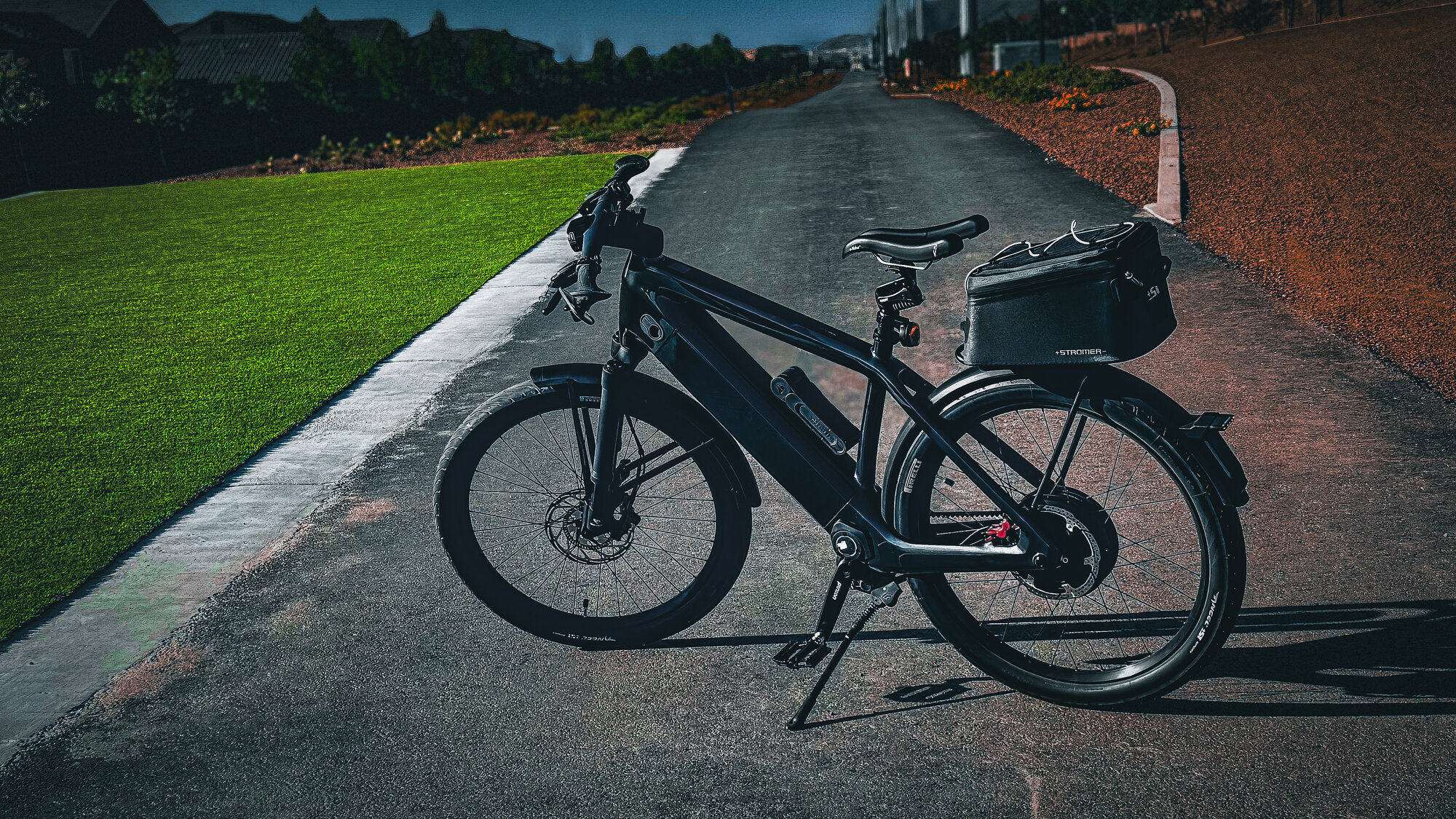

Let's have a look on my hometown in the warm morning light. Stopped my commute on "Mittlere Brücke"
Still love riding this..
