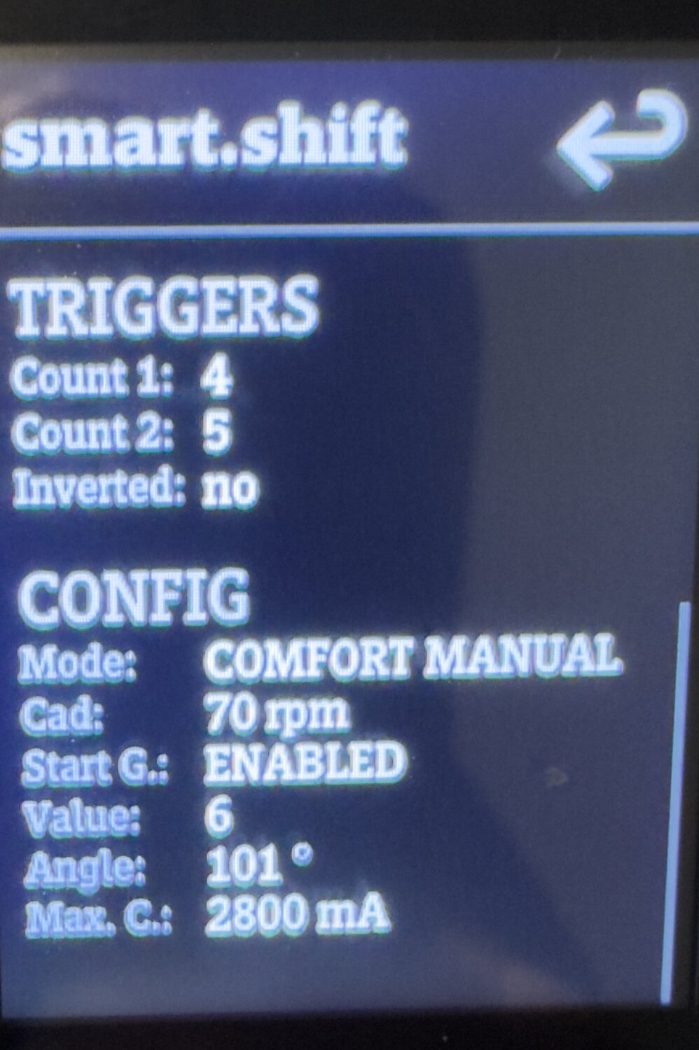

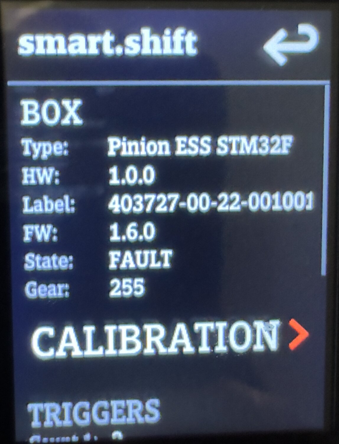

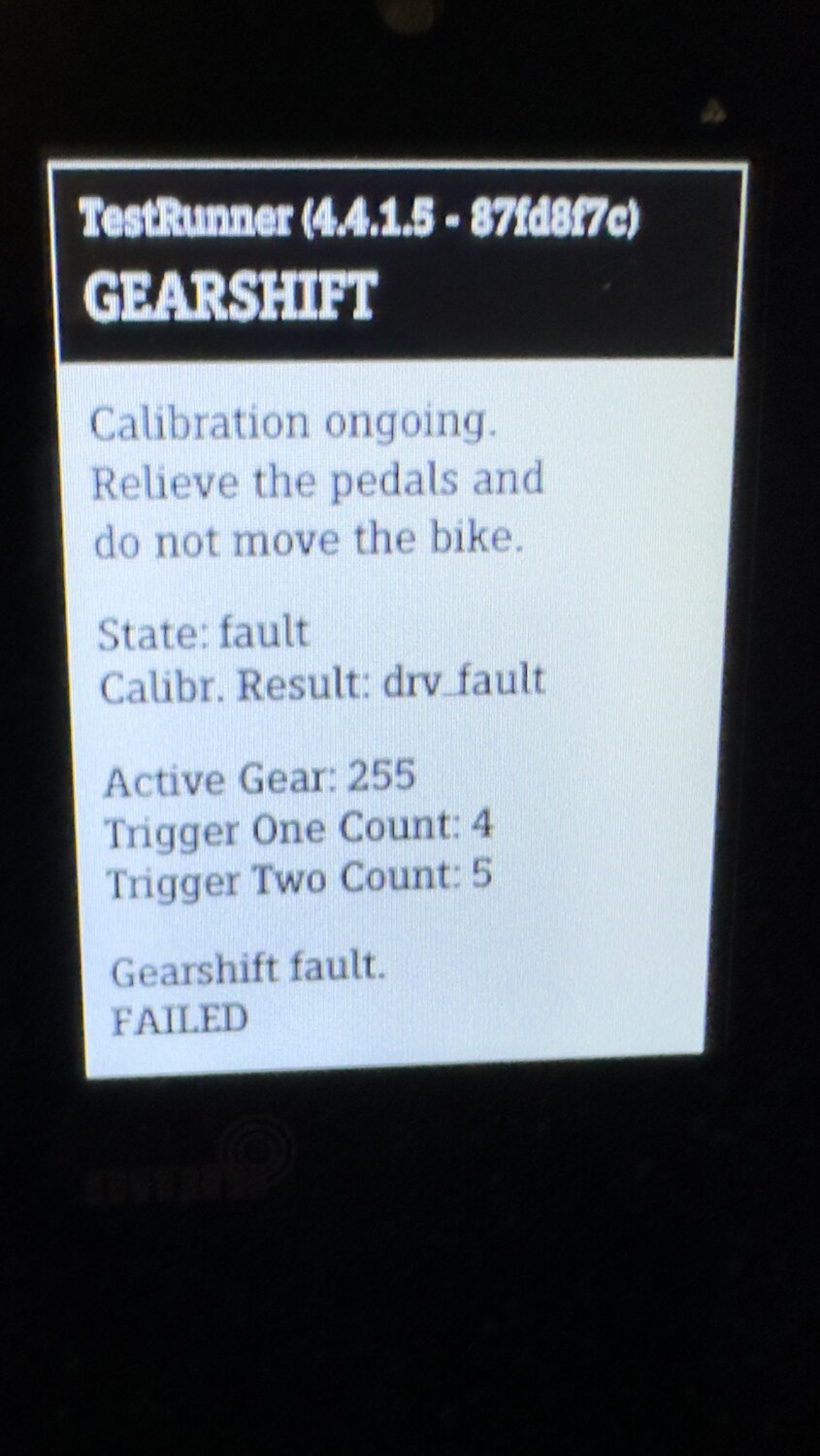

Thanks, Abe,
Still no luck..
The calibration instantly fails

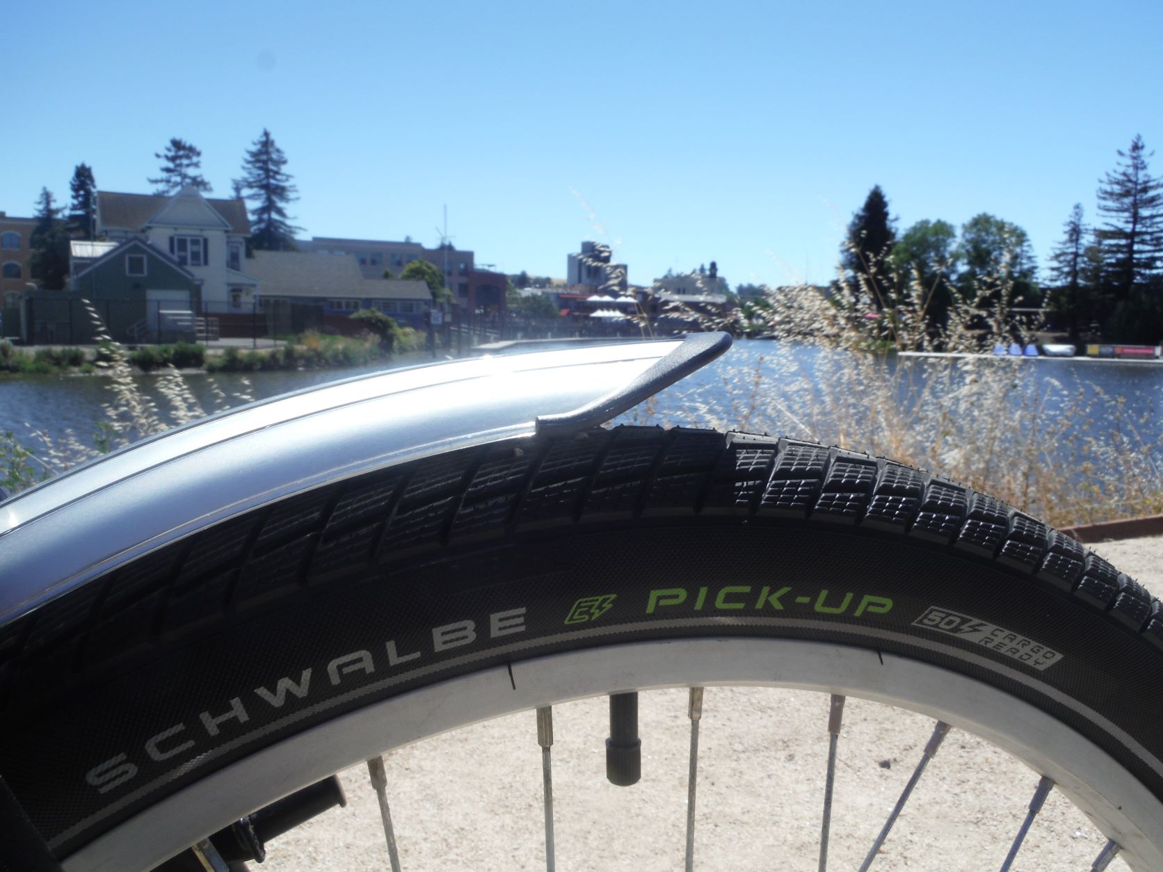

Here's a nice tyre to replace the Stock Pirellis which are both VERY prone to punctures (hoof nails etc) and double the price. I am very impressed with the Schalbe. Don't know if they are avail in the States etc:- https://www.galaxus.ch/en/s3/produc...35-60-584-bike-tyres-16183059?supplier=406802
I really like the Schwalbe Pickup cargo tires. I have installed them on five bikes, three cargo bikes and one 40+ Kg bike. No flats on any of those frequently ridden bike in over one year.
