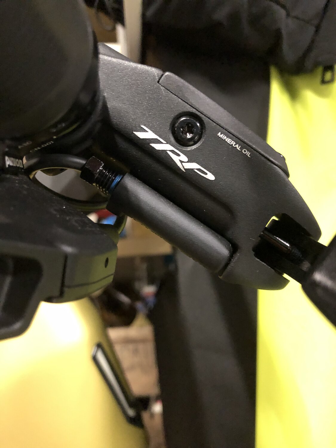

I’m a proud French owner of a ST7 since January and this is my very first post.
I’ve been riding about 500 km, mostly for commuting and I’m still learning to know the bike.
I also had some issues with the brakes, or more precisely said, with the recup mode.
As you, I experienced that strange feeling of fighting the regeneration force, that being confirm on the screen while pedaling (when the power regenerated appears on the bar scrolling from left to right). I noticed that always happened just after braking, even at short speed.
My dealer helped me to fix it without any software update.
In fact, when you use the brakes, it first slightly starts the regeneration mode (maybe for half a second) and then, the brakes work. There’s a sensor on the base of the brake lever, that sensor being controlled by a simple screw. When you get your bike, this screw might be too tightened and your ST7 continues considering that you are braking even after having released the brakes, and still continues to help you braking.
To fix that problem, slightly loosen that screw on both levers upwards (maybe half a turn or one turn). Find the right balance and that should work 😊. Notice : you’ll need to loose a very small security screw that blocks the main screw with a small Allen screwdriver.
I hope your bike will work fine when you get it back.View attachment 152770
The screw is the one with some blue on it.
Wow - thank you for this great post. I haven’t gotten my bike back yet but will try this as soon as I do.

Hello,

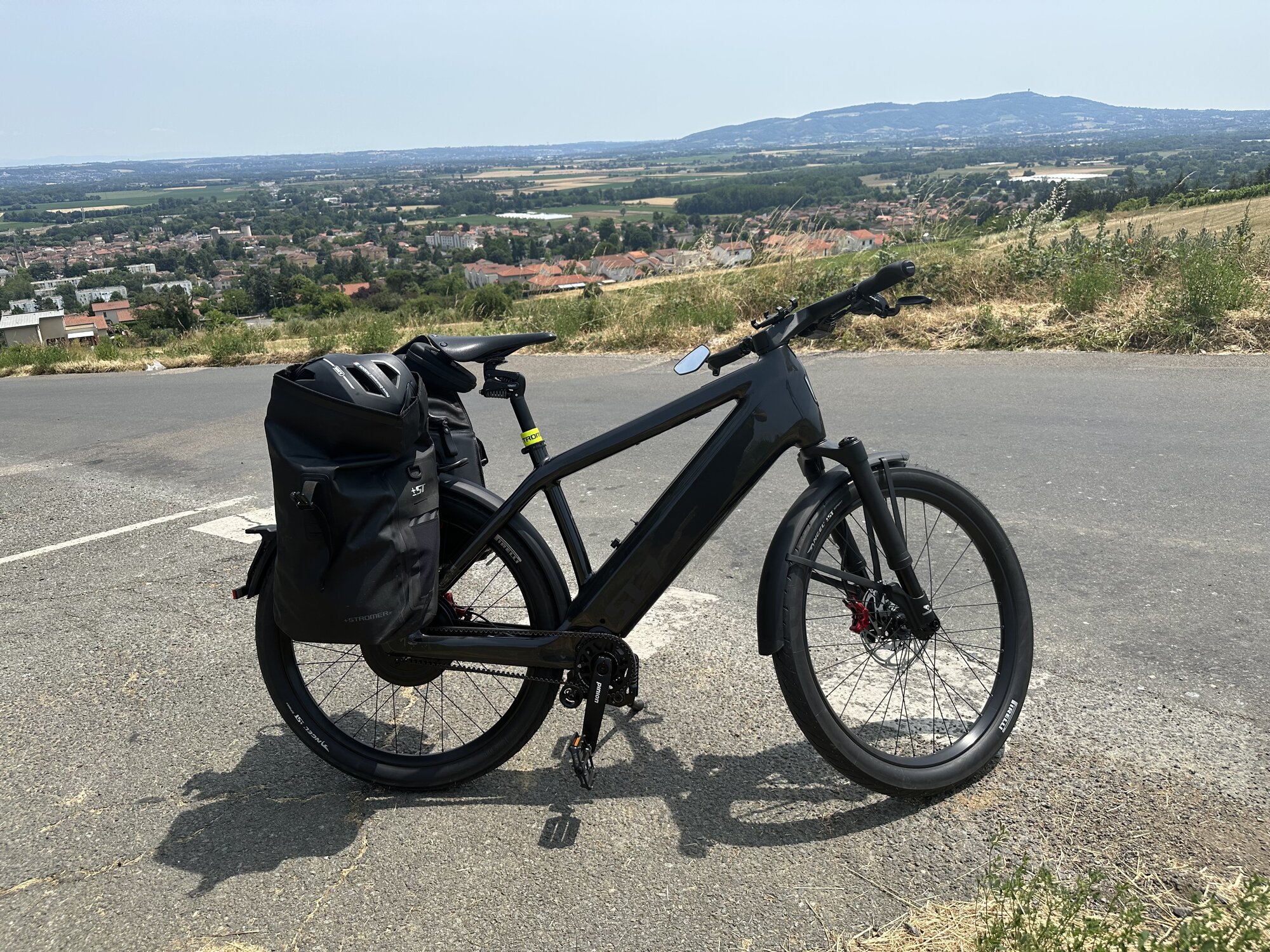

Hello,
I am a proud owner of a ST7 since yesterday from France.
Except that I experienced the same issue you described after 100 km.
While I was climbing an hill, the regenerative function never stops !
I had to stop and that a break !
It allows me to that this picture bellow ;)
Then, I finished the climb with the move function (thanks god !).
I’ll try the fix you described and report the issue to my dealer !
Happy riding !

Hello,
Happy riding !

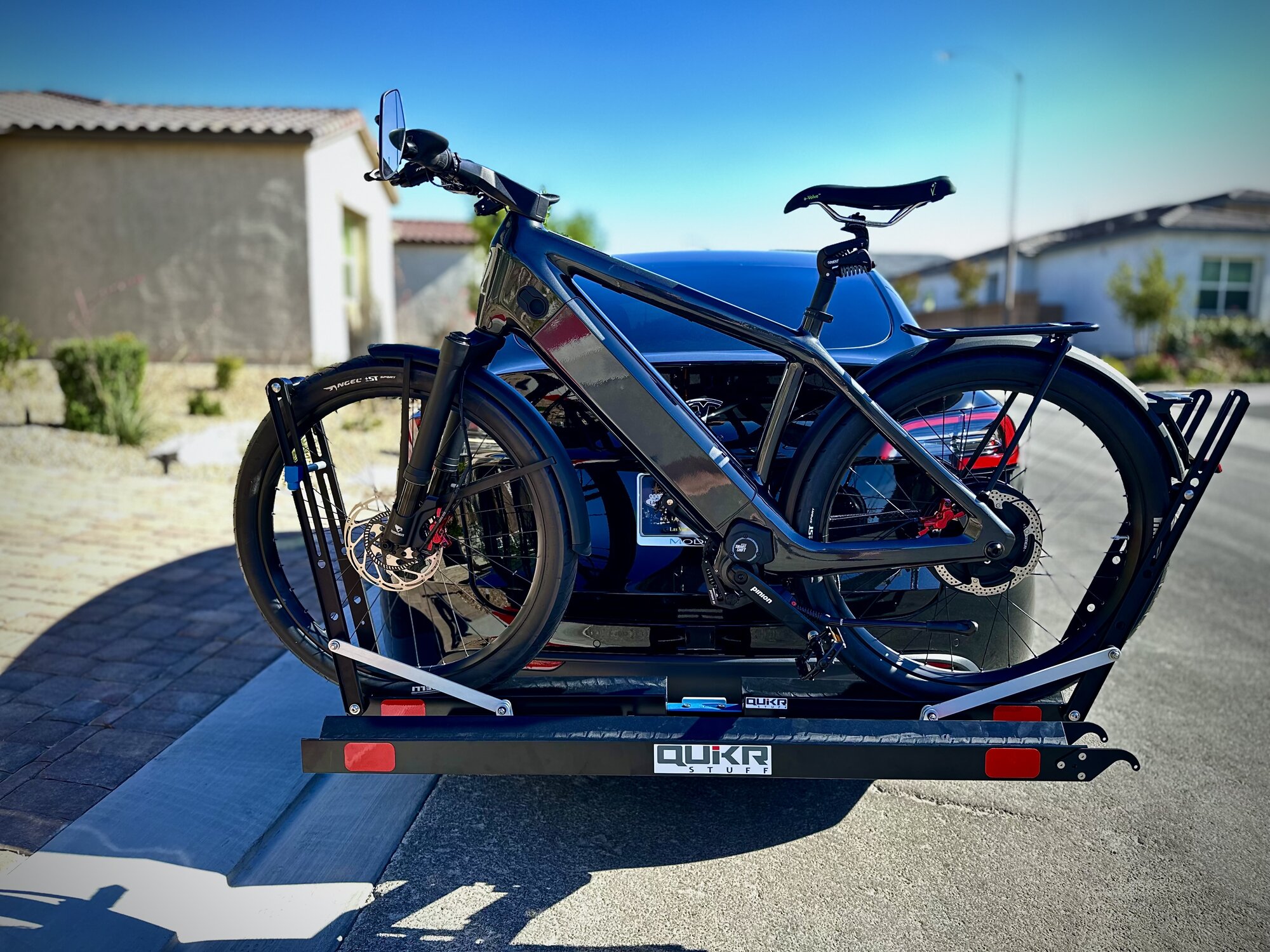

This was my first time using a bike rack... I did a lot of research, and this one seemed the best. Being new at this, I did not know what to expect, and there was a lot of trust involved especially picking up the bike in UT and driving it to Vegas. The pros of the rack are it is super simple to install with zero tools and folds up for storage. It is built like a tank with quality construction. I can get it on and off the car in less than 2 min. .. what I don't know if this is normal or not is the amount of wiggle (front to back) the bike had on the back of it. This could be because of the shape of the bike hitting the air or that I did not remove the battery, but the bike was flapping on the back of the rack; however, it was super secure, and there was no way it was coming off. I think I was more concerned about damaging the rack. Next time I use it, I will take out the battery. I think weight-wise, you are probably good with both bikes. According to their site, it looks like two bikes in a 2in receiver will max out at 240 lbs. I think the ST7 has such a large surface area that was causing a lot of resistance. I still highly recommend the rack, however. Also, get the ramp.
Thanks for the quick response! What looked concerning to me in your photo is this rack appears to grip the bike just by the tires. Is that secure enough to keep such a heavy bike stable (vs. the Thule which grips the frame of the bike)? Also, does the ST7’s front or rear fender get in the way of securing the bike to the rack?
The front fender seemed to clear with no problem... the rear had to be adjusted down to clear the tail reflector. This rack is totally held to the bike by compression on the tires. (or even Fenders. There are a few videos from Quickr that probably do a better job of explaining it. I am going to reach out to them as well to see if there would have been a better way...
I reached out to Quickr; They looked at the pictures of how I loaded the bike and the video of the shake while driving. Here is what they said "
As far as loading goes, this looks like it is set up well to me. There is a bit of movement while driving, which you can't ever completely eliminate, but i have some suggestions. Two things come to mind - first thing is make sure you are really pushing into those spools that contact the tires while loading. You want to push those in with about as much force as you can. The tighter those arms are sandwiching your bike, the more stable it will be.
You could also use a Wheel Strap on the back wheel, which we typically recommend for e-bikes with fenders. You could use ours, or if you already have a Voile strap at home, that will work just fine. It will add a bit of stability and peace of mind that the bike won't go anywhere.
Your overall weight rating is well within the range for our tray (120 pounds), so I wouldn't expect any issues, but both of these are small things I would look at."
They were super responsive and helpful. I think I am just new to transporting a bike. I am going to try it without the battery next time and maybe less weight will be less stress on the rack as it moves.
