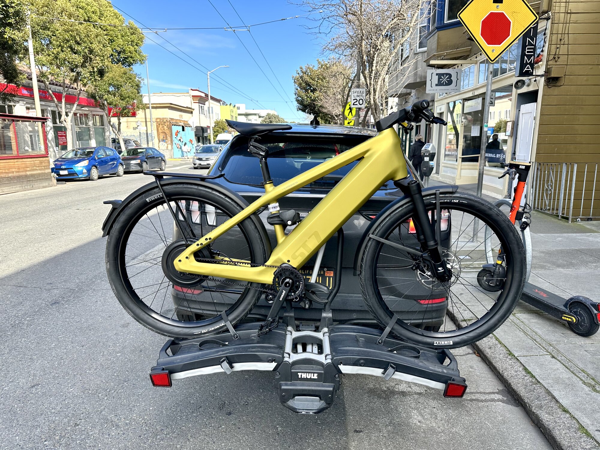

I got my ST7 today! It is a very nice bike, and I only had time to take a short 5-mile ride to adjust the seat, and get a feel for the bike. A few initial reactions:
Compared to my ST5, it is a predictably different experience, given the obvious differences in drive train. But it is just as much fun to ride, and it feels similarly powerful (not more, not less). It is just as quiet, and the shifting is just as smooth once you get used to the rhythm of the pinion system.
The one thing I don’t like, compared to the ST5, is that it feels like the regenerative braking kicks in at weird times. When I start to pedal from a stopped position, it feels like there is regenerative braking resistance fighting me for about one second before it releases. When I stop pedaling and just coast, the regenerative braking kicks in, quickly slowing the bike rather than just coasting. Also, when I engage the brakes, the regenerative braking seems to kick in for a moment before the real brakes engage, and when I release the brakes, the regenerative braking stays engaged for about a second after the real brakes disengage. All of this “feels” wrong. Hopefully a software update will address this. Or maybe I need to try a different sensitivity setting for the brakes. Right now I have it set at 100%.
Another issue is the bike arrived with no side mirror. The dealer’s demo bike did not have one either. This despite the US Stromer ST7 website stating that a mirror comes with it. I was thinking of moving the mirror from my ST5 to the ST7, but it does not appear that can be done.
That’s all I have to share for now. Stay tuned for more updates.

Hey Abe ! Congrats on your new bike. I would definitely play with the brake sensitivity until you find the right balance that works for you. It's a little unnerving as I've always had it set at 100%, just like you , on my ST5; but I'm sure you'll figure it out.
As far as the ride feel, I agree with your initial assessment but I suspect that the increase in power and torque is mainly there to compensate for the added mass of the bike.

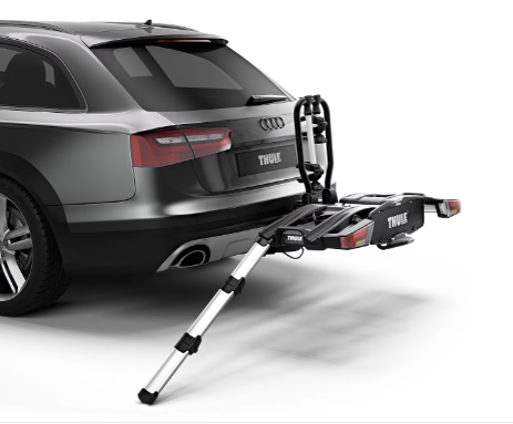

How's that Thule bike rack thing handling the weight and did you manage to get it up there by yourself?

Thanks, Petro - yes, I’ll try adjusting the brake sensitivity and hopefully that will work. Just as you would expect, as soon as I got my bike home it started raining and hasn’t stopped for two days. I’m planning to do a 30-mile ride tomorrow to really put the bike to work!
The Thule worked great, though to be safe I removed the battery (about 20 lbs of weight) from the bike. Tomorrow we’ll load it up with my ST7 and my wife’s Riese & Mueller Homage. Even with all the batteries removed those bikes will be pushing the max weight on that Thule. I need to start researching alternatives to the Thule that can handle more weight. I found this so far:

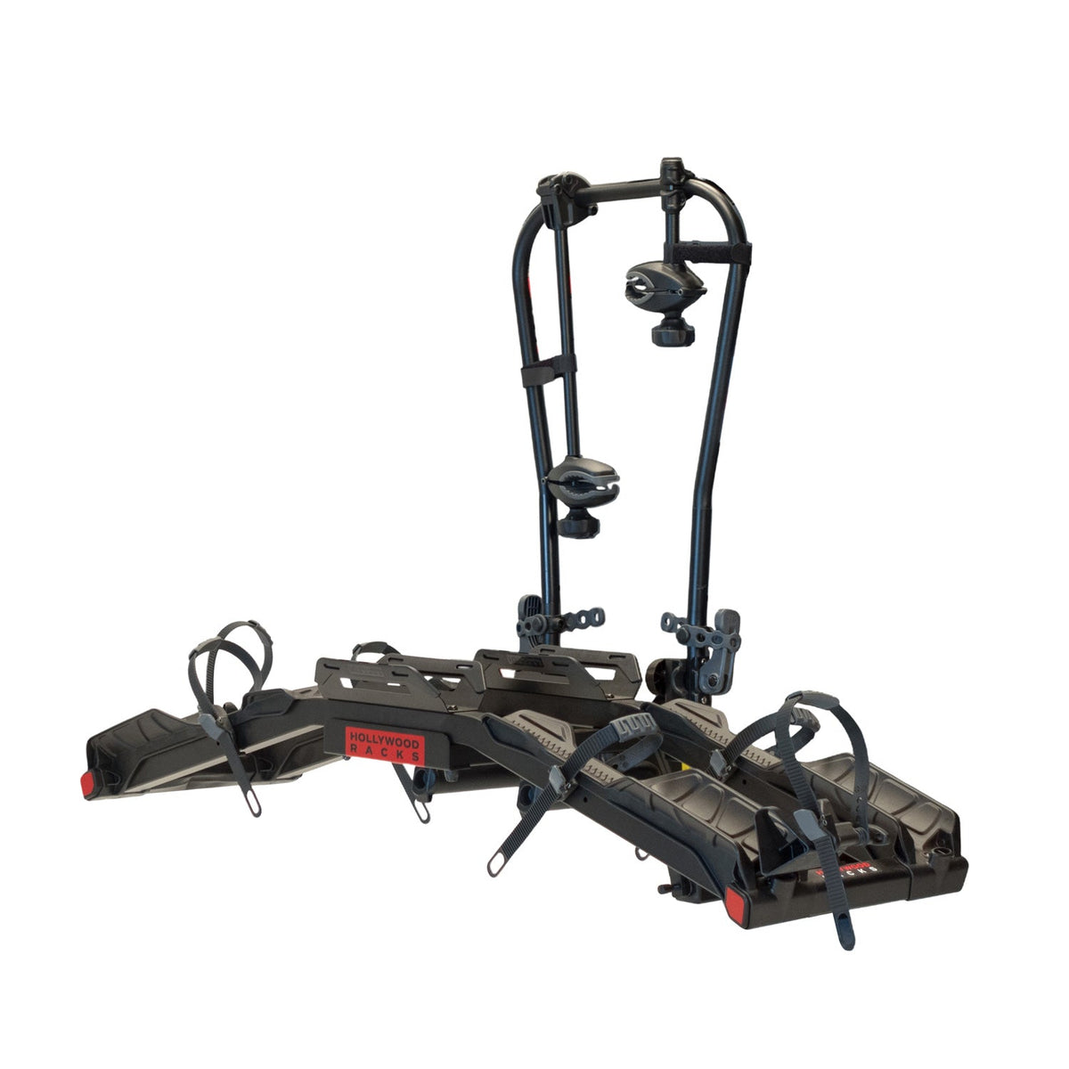

Congratulations on your ST7. I cannot wait until mine arrives. I went down the rabbit hole on bike carriers and ended up ordering
https://quikrstuff.com/
It looks like it might be a good option given the weight of the ST7, and it seems to be the least evasive on transporting the bike.
