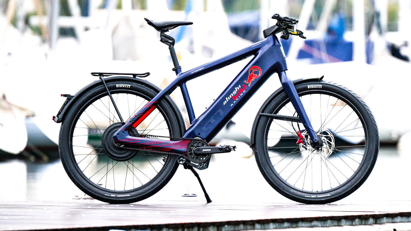

The all new official vehicle for the world famous Red Bull Alinghi sailing team:
Alinghi.
This name has an aura in Switzerland. Since alinghi, Switzerland is ranked on the seafarer list. Last year, Ernesto Bertarelli announced to challenge the cup together with Dietrich Mateschitz. The Alinghi Red Bull Racing Team was born. Today, Stromer is presented as the e-bike partner.:
The news of the day will delight bike fans: Stromer joins Alinghi Red Bull Racing as official e-bike supplier!

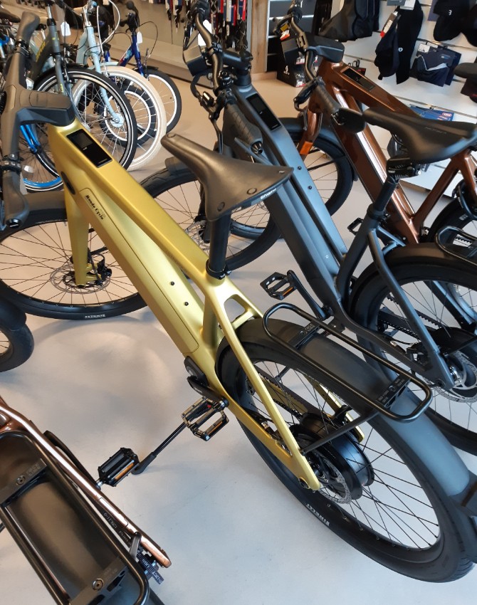

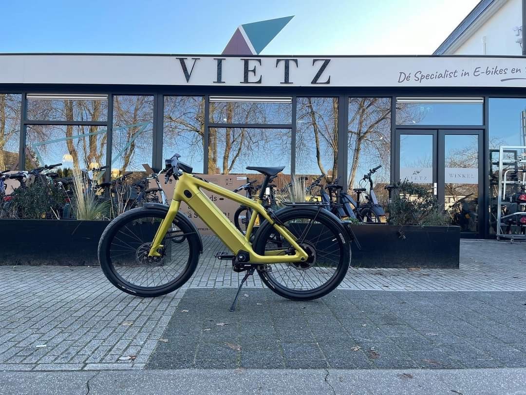

Hi Abe, the first deliveries were made to the Dutch dealers the day before yesterday!!!!!20221216_151150.jpgFB_IMG_1671038562210.jpg
