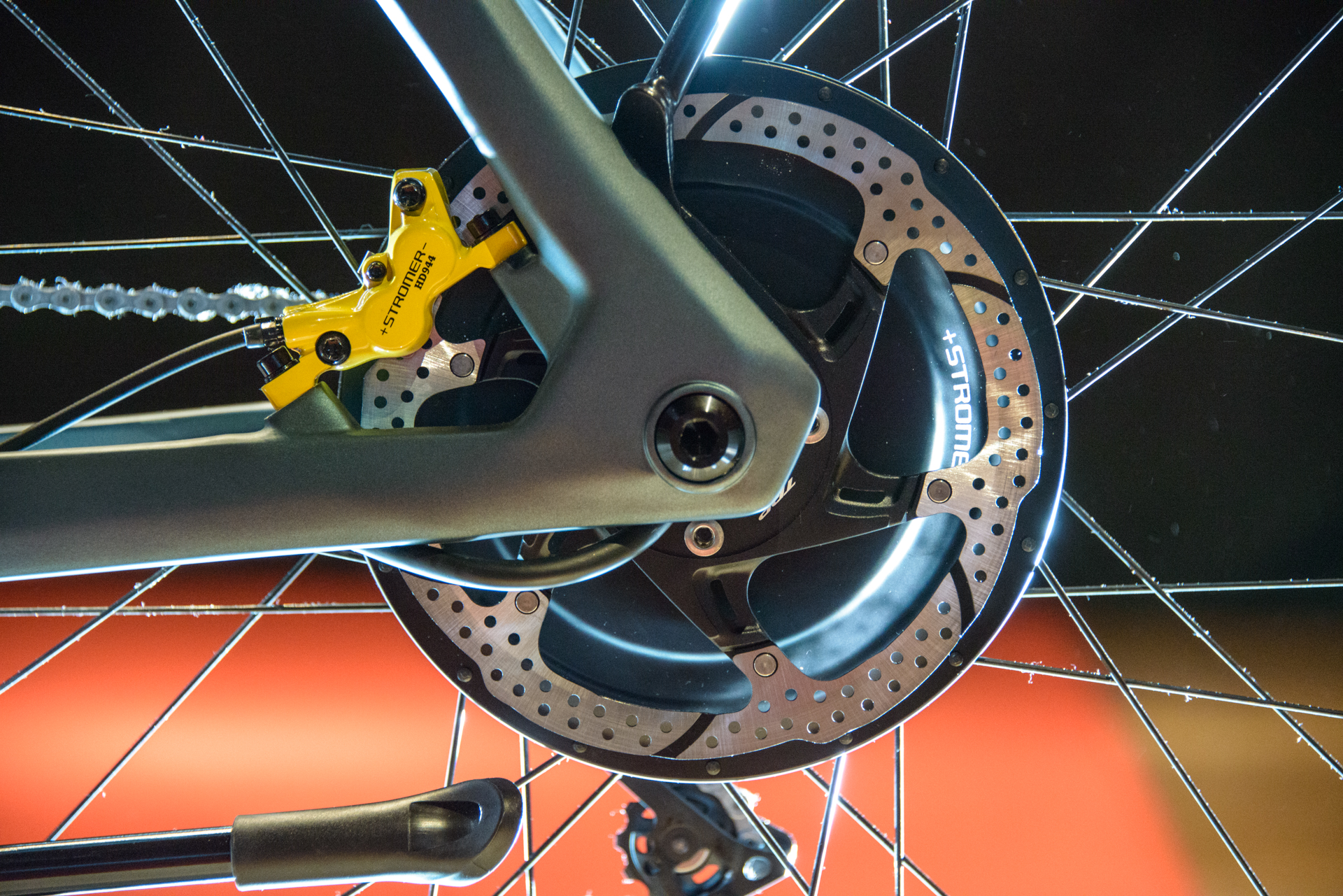

TRP four piston pads I don't know which ones they use though. A bleed kit for TRP should work.

I wonder what brand pads it uses? also what bleed kit do you need?
Tektro / TRP are made in the same factory.
These HD944 uses Tektro Hydraulic Hose Kit Brake Disc HYD Hose Kit Draco/Auriga Comp-ws 1800mm
The HD944 has a open vent reservoir I haven't seen anything that can interface with the vent cap.
Shimano makes a very expensive kit to bleed these type of brakes.
Shimano TL-BT03 Disc Brake Bleed Tool Kit (3rd gen.)
I just pushed fluid through the bottom until it leaks out through the top reservoir vent hole.
Same pads as Shimano Saint BR-M810 Zee BR-M640
There's no need to buy THE $25 versions... can be had for as cheap as $8 a set. (I'm running those.)
I tried 4 different brands to try to cur down on the squealing, but ultimately I had to reface the brake posts.
The factory posts were not square and could not achieve perpendicularity with the axle.
(Now I own the tool Disc Brake Mount Facing Set.
