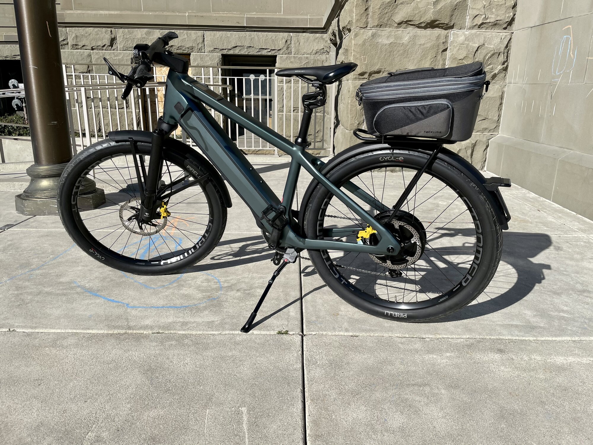

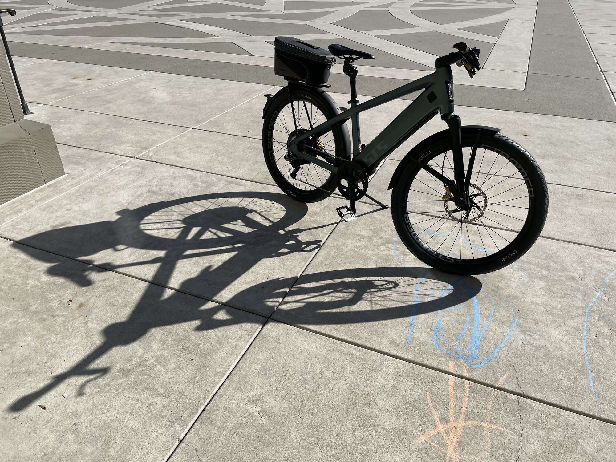

Took a few extra days before I got the bike, but here it is - a beautiful new ST5 Limited Edition on its maiden voyage!
Looks very cool!
I see the New Wheel sticker and I guess they recommended a great bike for you to complement your Superdelite. They provide great service to their customers and you should have no problem keeping both of those bikes for several years.
Perhaps you could share your experience in a different thread under the Stromer forum.
It also feels great to ride, E shifting is precise, crisp, tires are grippy, feels very stable at high speeds and is truly silent.
