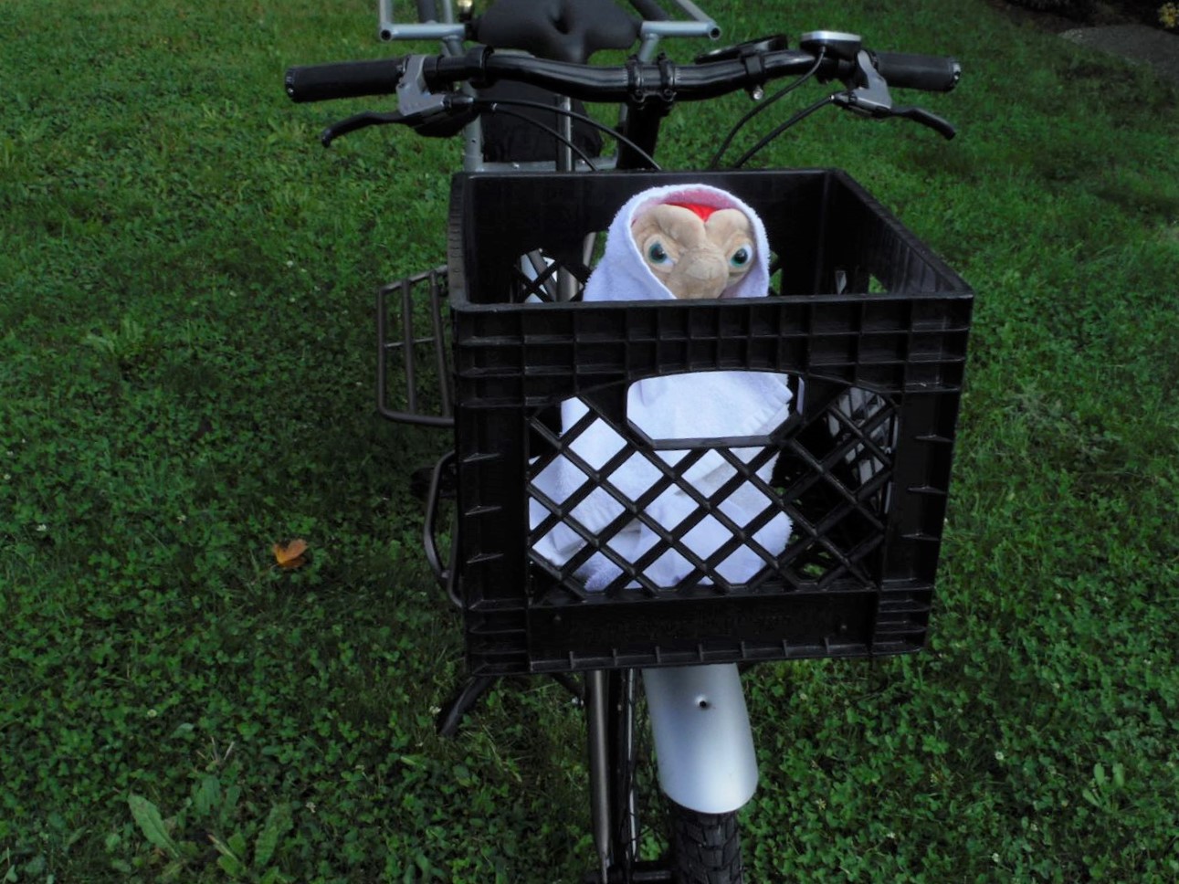

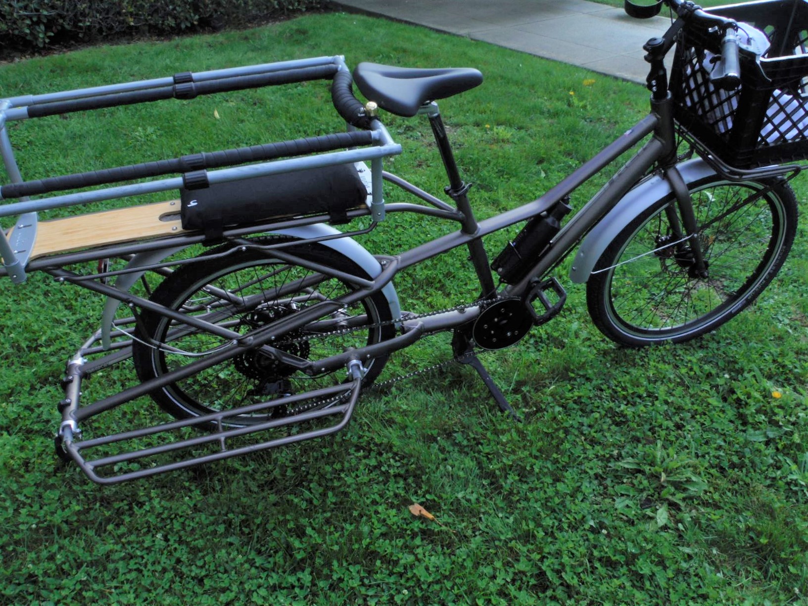

Some cargo bikes suffer from aerodynamic drag. Today I was able to turn that situation around.

If you want to change the game, you go to a mid drive. On mine, on steep hills in my area I climb them at 12-15 mph. This is working hard on the pedals and letting the motor have at it on max pedal assist. If I want to let the motor do the work, I can do that too and just hit the throttle and take a break. On the steepest road in town (Prescott Lane in Monterey CA, just before the turnoff to the army base) - so steep people almost don't believe it when I tell them I can go up it, I am at about 8-10 and my ass is beat at the top. A hub bike has no hope trying this and I have seen Rad Wagon riders who give up as soon as they get to the steep part and go down to try and find another way over (they are available for rent here).
This bike has a 36T front chainring, which really does make a big diff since a mid can use the gears. 11-46T in the back and I can't use the big 46 thanks to the fat tires. But the 42 just under it gets the job done. A hub bike with a cargo load wouldn't have a prayer of conquering the same terrain.
