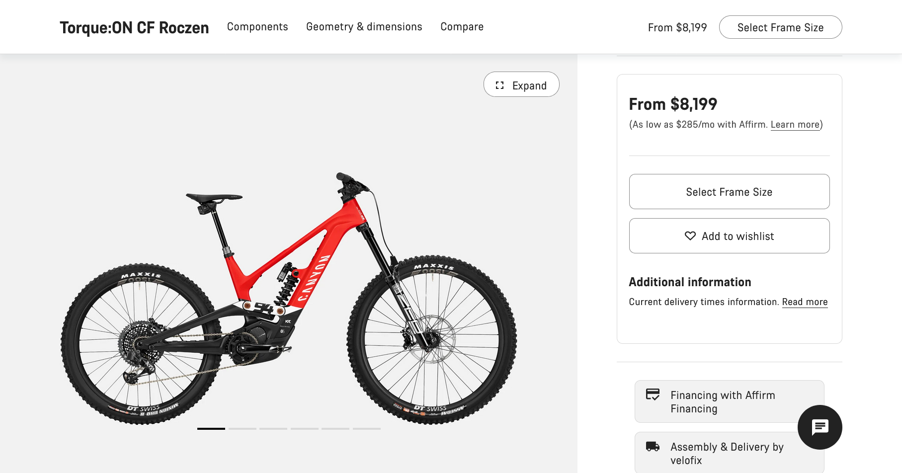

DO NOT buy that bike until you have gone home and thought about it. The first taste of an emtb is highly addictive. But it's worth sitting back and comparing options - both specialized and giant have discounts on last years models. You can't go wrong with either, but it's still smarter to buy a non motorized hardtail first. Enjoy that estance.
It has been a mystery to me why he chose to become a Santa Cruz Heckler endorser...
PDoz, have you heard of Mondraker e-MTBs? I ask for a friend in Norway, honestly.
