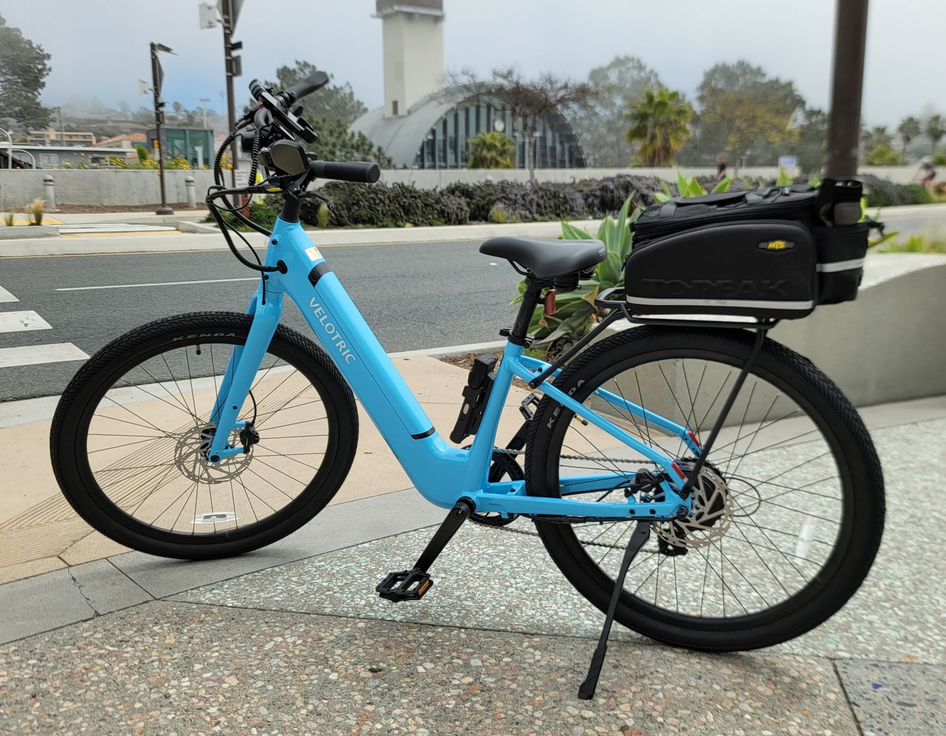

Welcome aboard! Look into the Velotric Breeze 1 — a 50 lb, 750W, 65 Nm hub-drive step-thru cruiser with a throttle. Recently bought this one for my 5'6" wife. It's light for an ebike but not small.

Importantly, the Breeze toggles between torque-sensing and cadence-sensing sensing assist on the fly with a single button press. And the cadence-sensing mode lets you ghost-pedal — i.e., get full motor power just by turning the cranks, no real effort required. That effectively turns the pedals into secondary all-or-nothing foot throttles.
My wife's not a strong rider. She generally prefers torque-sensing assist for the added power control and more natural feel. But she finds cadence-sensing assist much more helpful on bigger hills. Your wife might benefit as well.
My early impressions of the Breeze here. Velotric's nationwide dealer/service network is a big plus.

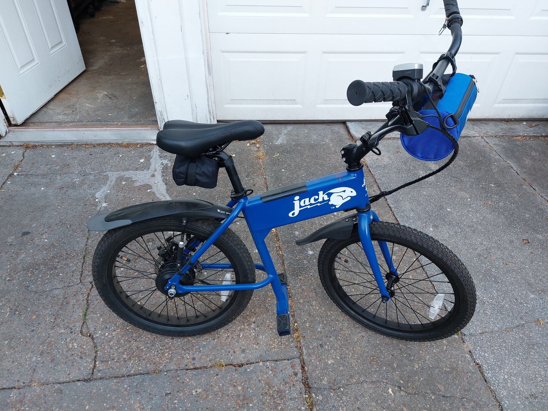

If you're looking for a small and light hold-over till she gets better and can manage the Rad I'll loosely suggest a JackRabbit. I have one and it does everything I ask of it. Been stone reliable, idiot proof (I haven't broken anything) and is just care free fun.
