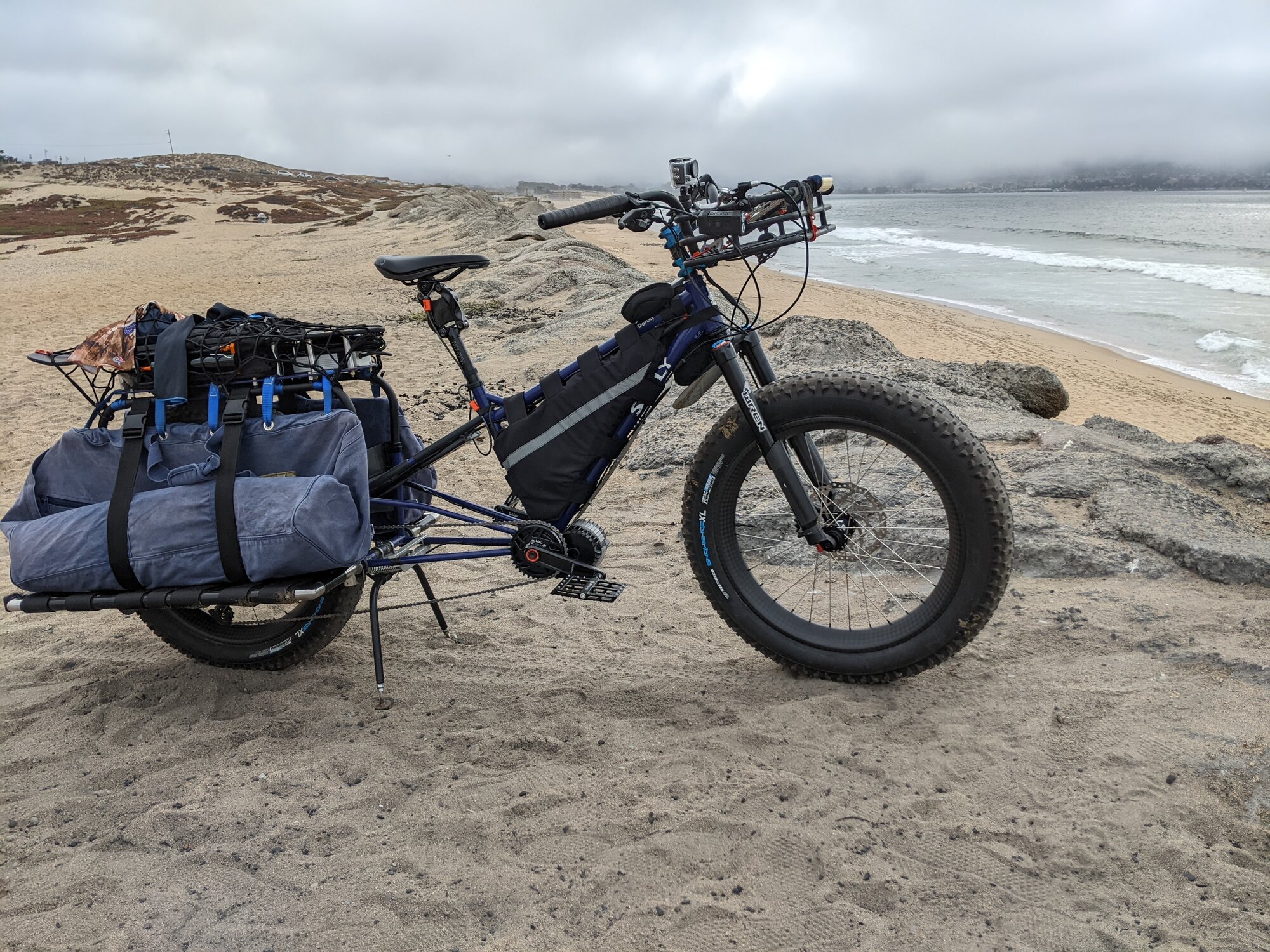

The bike can take anything on the street, but to do the dunes I have to have a 2wd bike to keep the front from submerging. This was the one/only day I took the BFD out into the sand.
Yeah I have to admit once I made it up Prescott, then did it a second time, I decided thats it I am not going to risk my chain any further. I take David back up. On the other hand, going down is a thrill ride and I do sometimes take it down, turn in at the path, onward to Costco or Home Depot etc. Gets me past a lot of tourist traffic. I took these a couple weeks ago
View attachment 139757View attachment 139759
