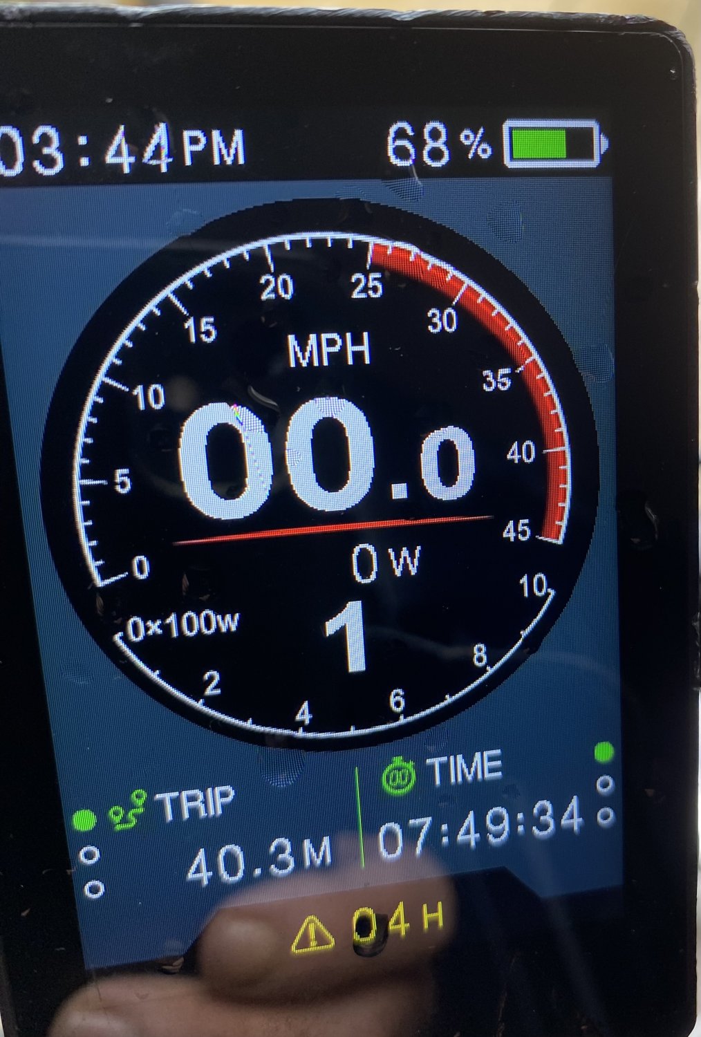

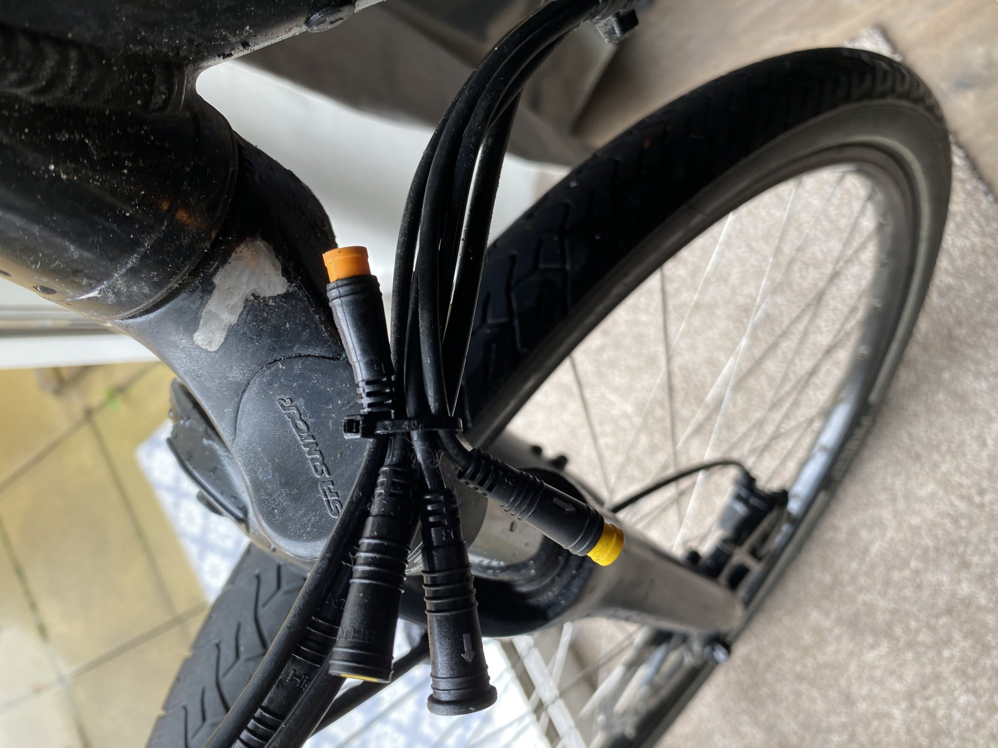

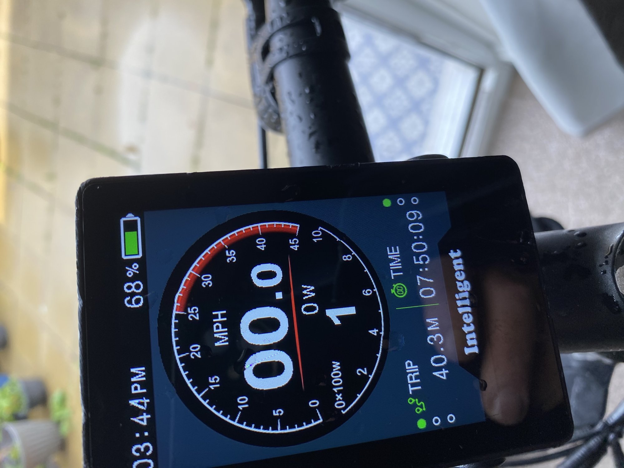

Ordered my bbs02 bafang thumb throttle came today tried in the only male cable coming from the main harness and nothing happened apart from an Amber looks like a warning light came up on my controller screen I’m gonna send you some pics of before and after I’ve plugged in the throttle
Here is the pics I promised before and after plugging the throttle to the mail cable coming out the main harness. And here are the cables I have left near the handle bars

04H is a throttle error.

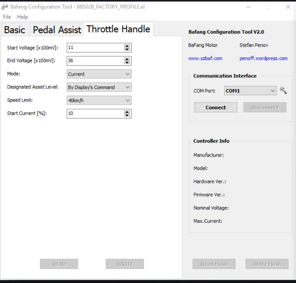

More than likely the programming parameters are out of line with the particular throttle you have. The high and low throttle limits need to be matched and set up correctly.
Start Voltage (the probable culprit, set too low) and then End Voltage for proper full range.
You'll need the programming cable we linked to earlier if you want to fix it.
