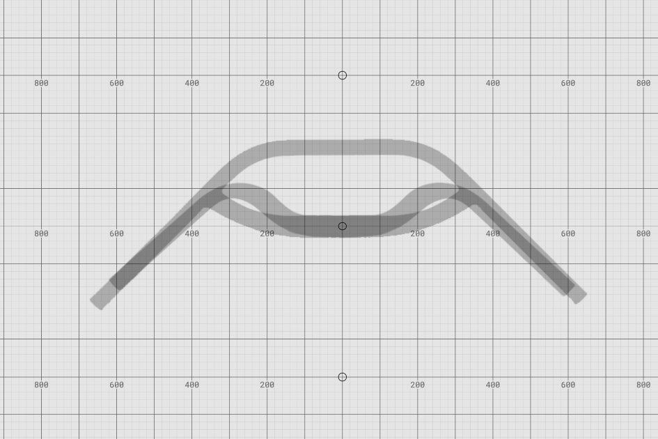

You may already be aware of this, but WhatBars (https://whatbars.com/) is an awesome website for comparing handlebars. You can select the FSA Metropolis and compare sweep, width, hand position, etc. by overlaying any other handlebars you wish to select. For example, the FSA Metropolis and the Jones h-bar loop have very similar sweep and hand position profiles:

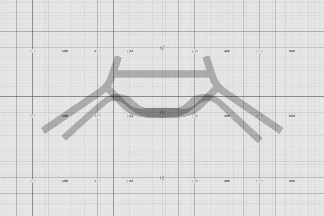

While the moloko has less sweep and wider hand position (when compared to the FSA):
If you really want another FSA metropolis, it seems it is still widely available in the marketplace despite reports of it being discontinued. For example, a quick Google search returned the following options (and many more) from US retailers (I'm not sure how widely available these bars are outside of USA):

Great app... thanks for sharing!
