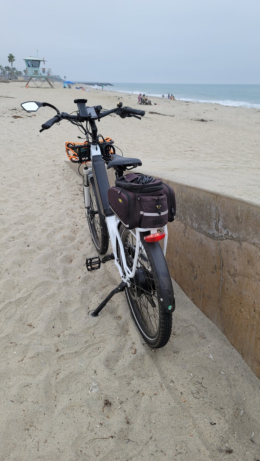

Q1. Most commonly, walking my 70 lb bike with 2.3" hybrid tires across unrideable stretches of beach gravel or loose sand.
Thick layers of loose sand are also common on inland trails here — as are steep slippery or rutted pitches that I'm too chicken to ride. No problem with walk mode. It also comes in handy on stairs and steep driveways and ramps — including the ramp on my Thule bike carrier.

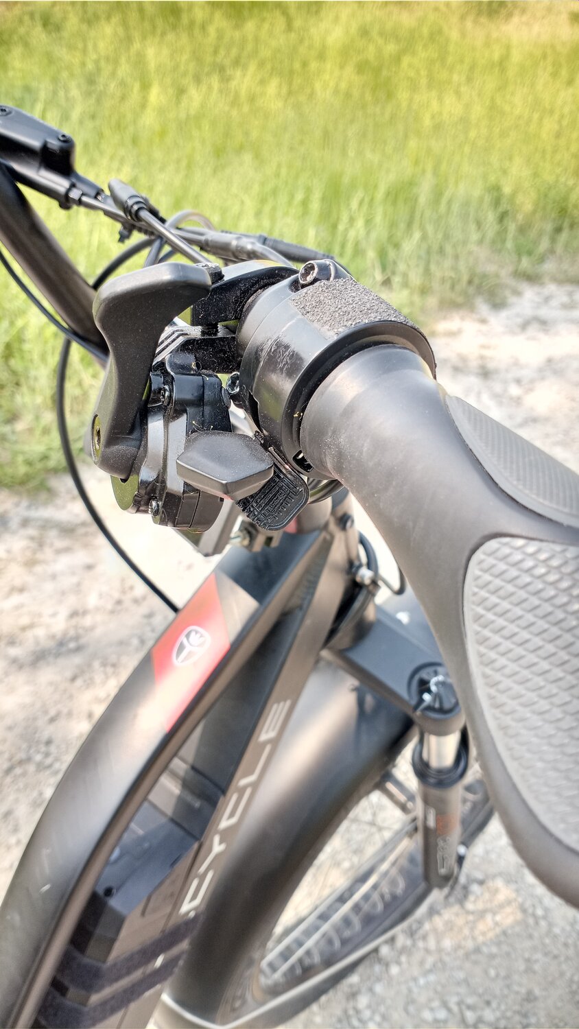

Q2. Press and hold the [-] button on my handlebar control. Works on or off the bike.

Either of my e-bikes has a dedicated button on the handlebar remote. The Walk Mode is implemented perfectly on my Vado SL, where a push and hold on the "foot" button immediately activates the motor. I need to push and hold the "+" button on the Vado 6.0 remote, and the motor activates after a noticeable fraction of a second (it is probably a safety feature to not activate the mode inadvertently).
