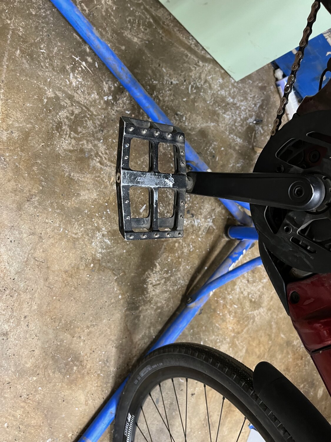

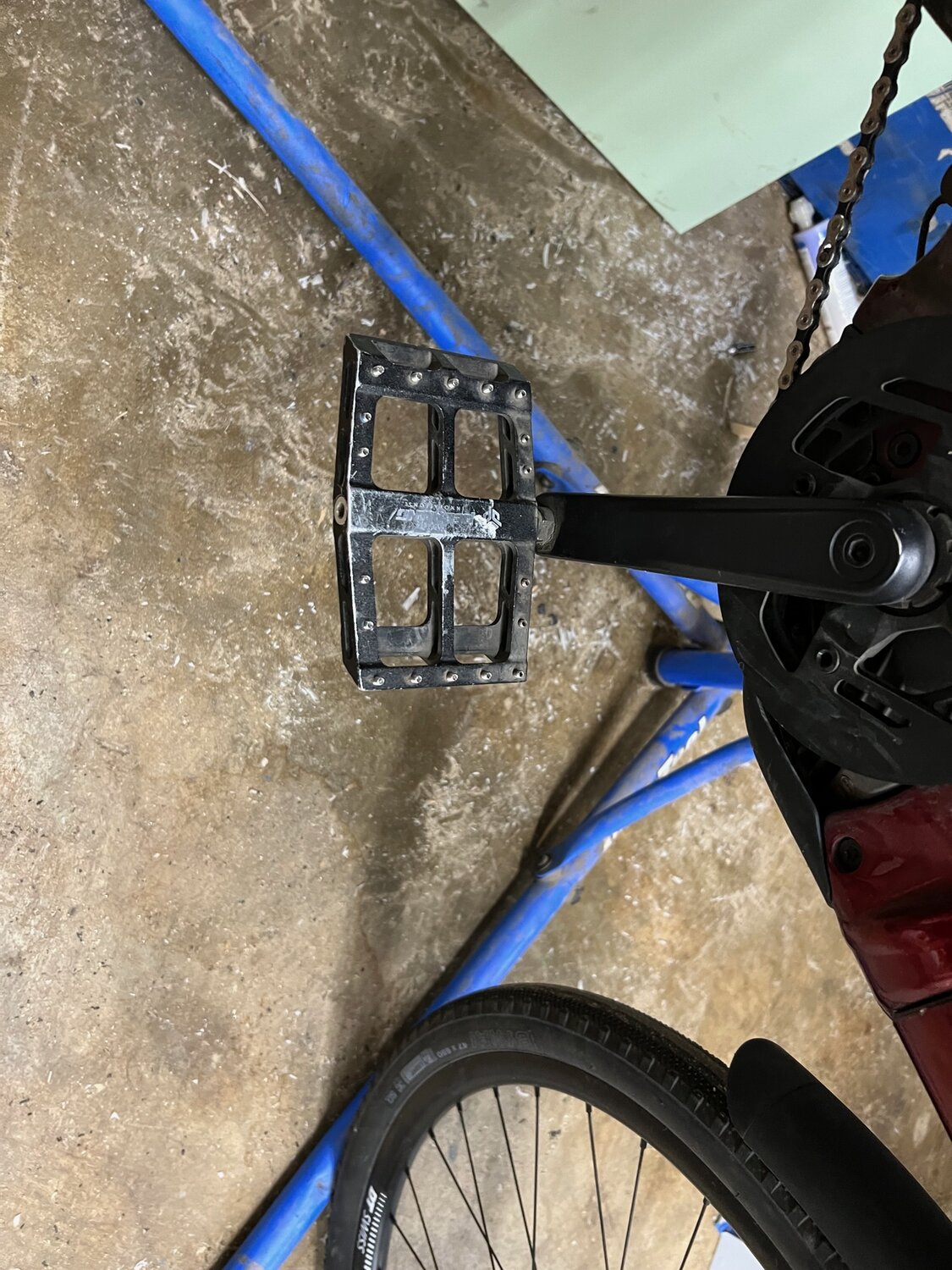

Which pedals are these?
go to their webpage and look at the large size. for feet 13 and bigger.

Sorry, not from that photo.
Wait, can barely make out part of logo. Wasn't aware that Catalysts come in more than 1 size.

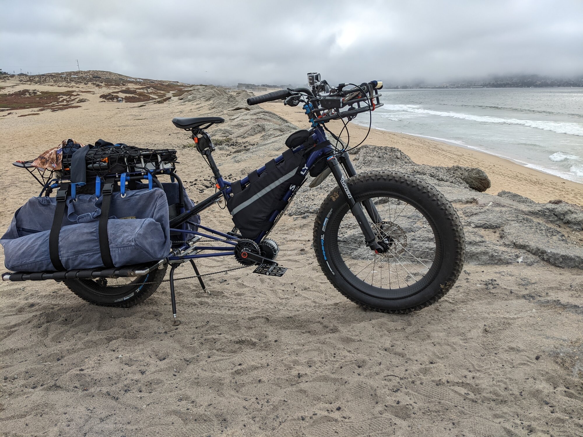

I have been using Catalyst pedals for years. They are the only platform pedal I use when I am not cleating in. I was one of the early adopters of their use on street bikes.
I have a few sets of the 'normal' size, and for my Surly I decided to try the really big ones even though I do not have a Size 13 foot. I prefer them.
The use case for me was foot pain due to the unsupported arch. Being able to plant the full arch on the pedal is a big deal comfortwise. And you really do use different muscles as the reviews say you do. You'll actually feel weak and tired in the beginning because you are changing the muscle groups you use. But you will also be applying much more power to the pedal stroke. When I first tried them out, it took a while to adapt my pedal stroke. And I did not feel particularly good about them or their benefits. Then after awhile I rode a bike that didn't have them and was floored at how much I missed the things and how much they actually gave me, now that I was able to directly compare. Thats what sold me. Also pedal strikes on the front or rear can happen if you are swooping into corners hard on the street. But otherwise not a problem. Its never caused a crash, just stained underwear.
So: Two benefits: Support for the full arch and much more powerful pedal stroke due to the different muscle groups employed. They are totally worth the money.

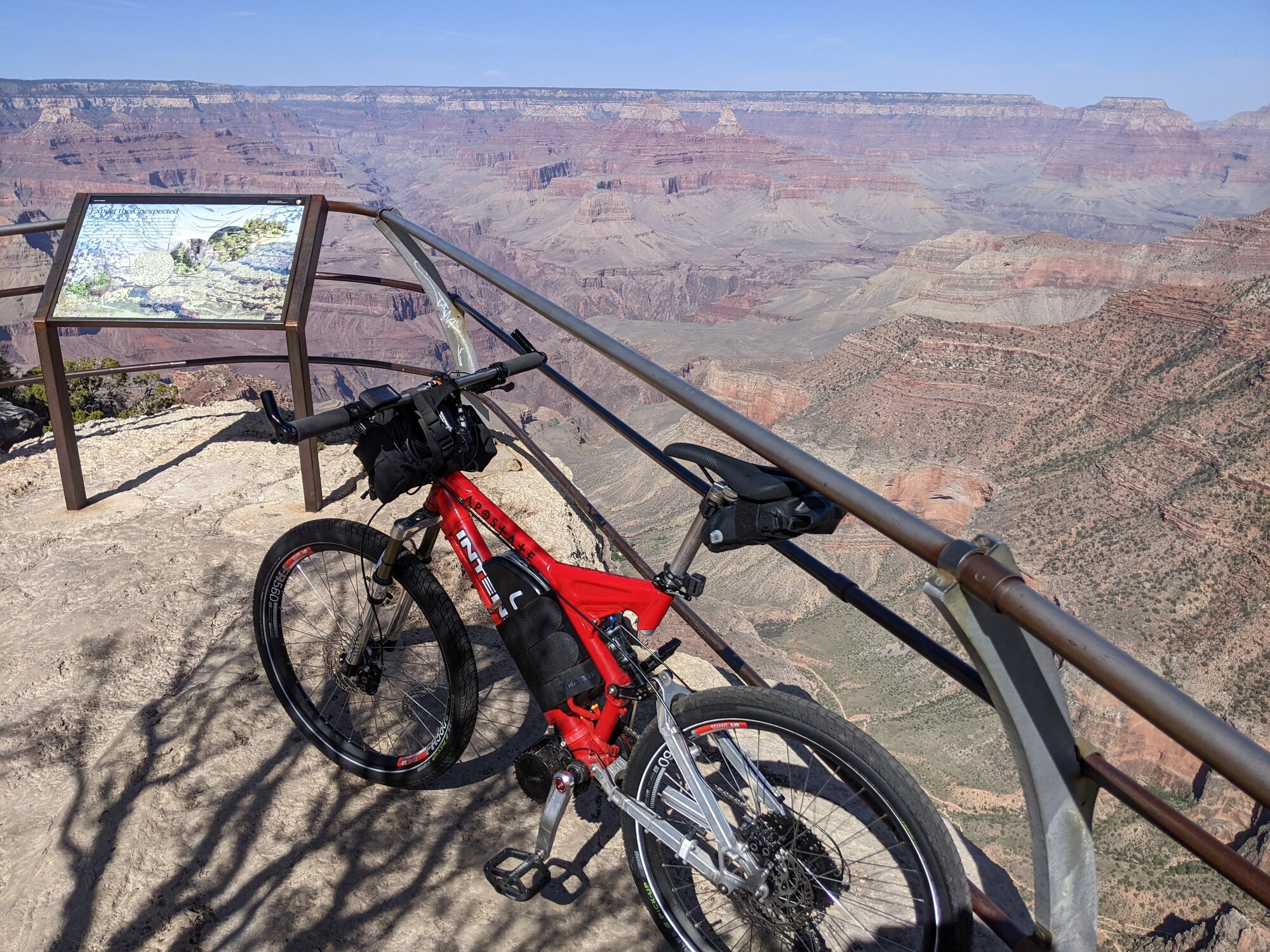

'Small' size on a bike whose pedals are low to the ground
The bigfoot size
Normal size again. I've got more :)

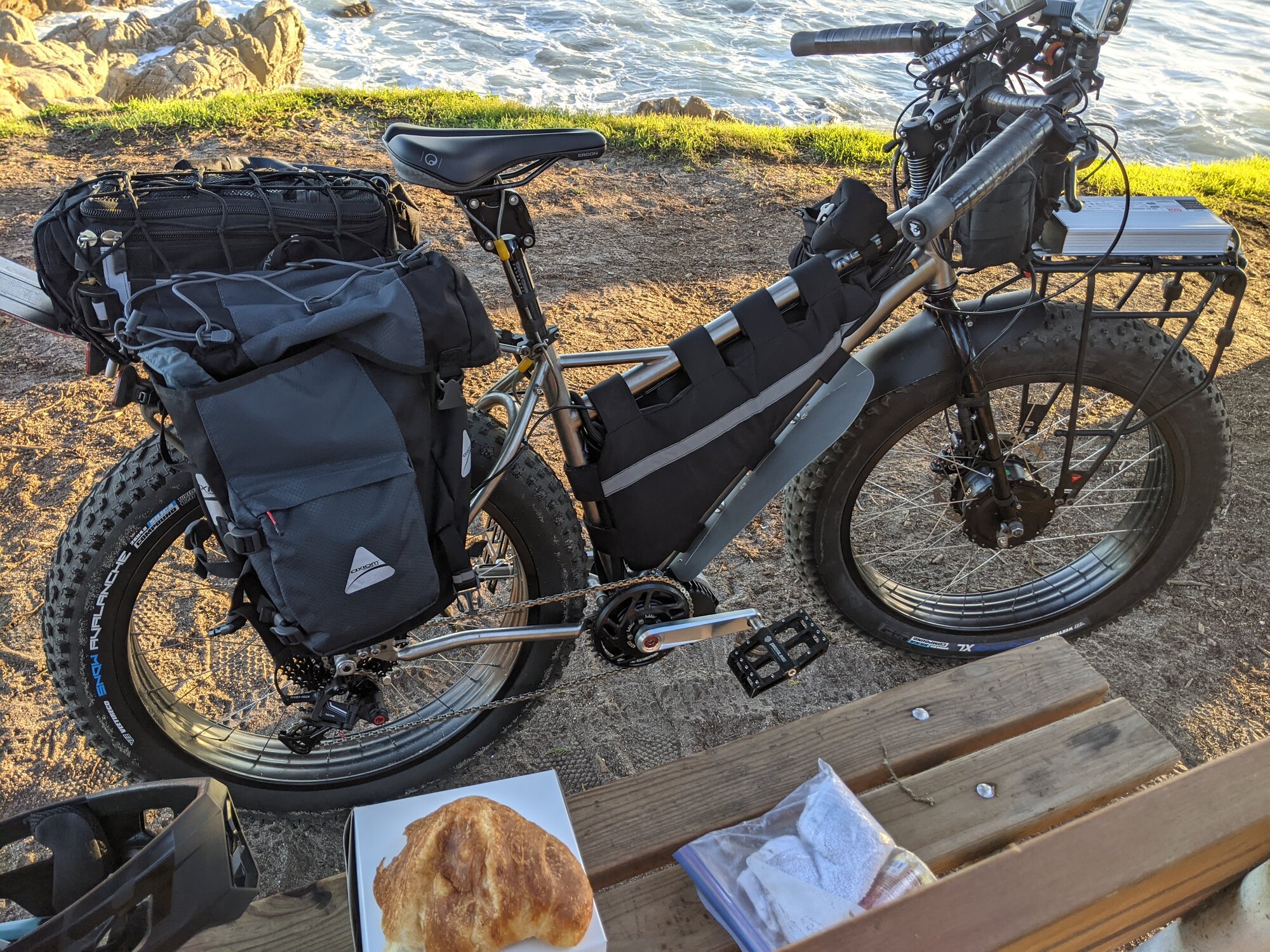

By the way these are the next-largest.

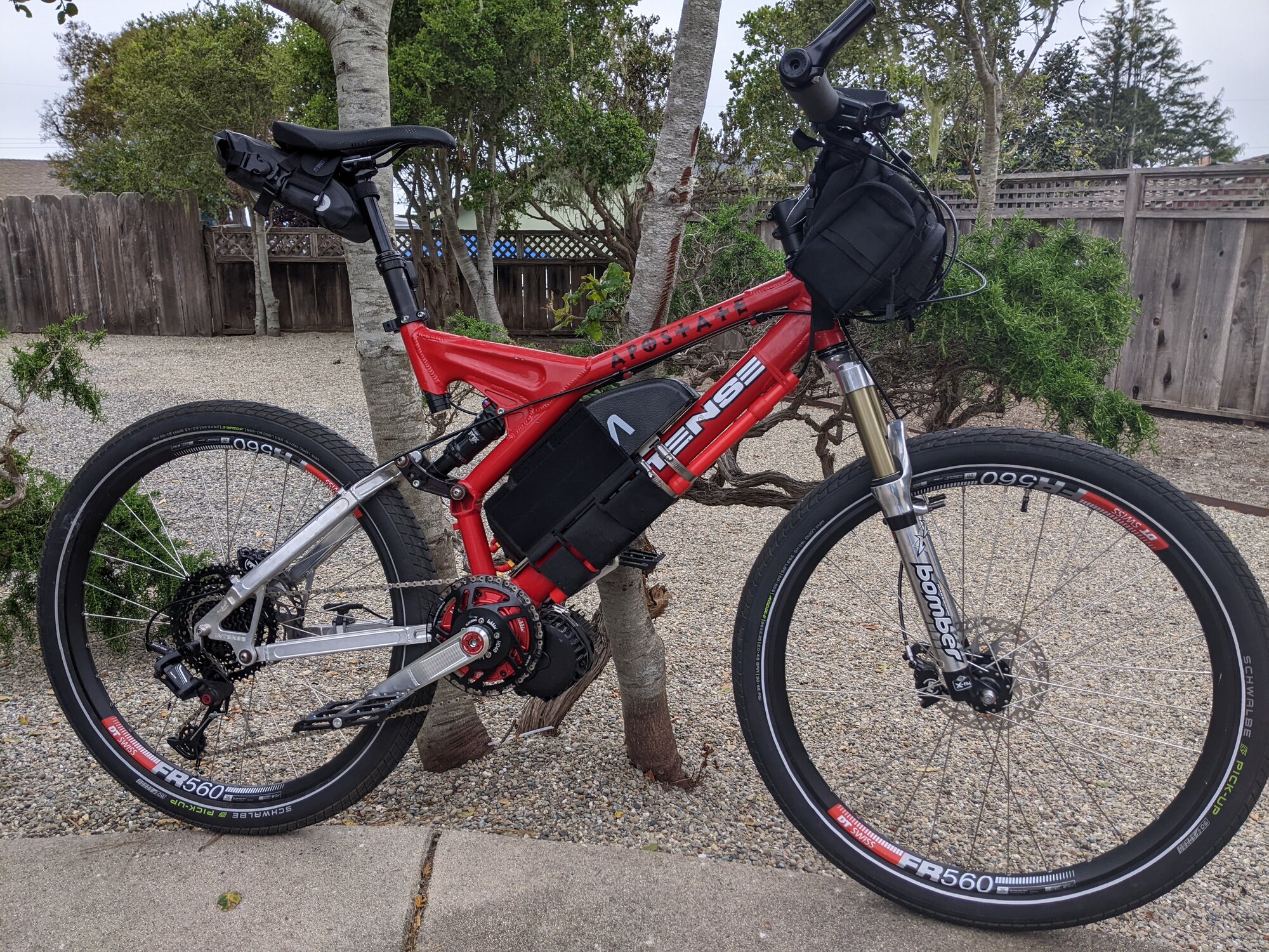

I have had one break after getting whacked really hard. But since its a $25 set of pedals no big loss. Here they are on the same red bike as the previous post. they came off in favor of the Catalysts. These pedals are big - barely big enough to do a mid-foot position. They are sized comparative to the other 'big' pedals on the market and are an inexpensive way to go big and stay conventional. But the Catalysts are better and in a size league of their own.
