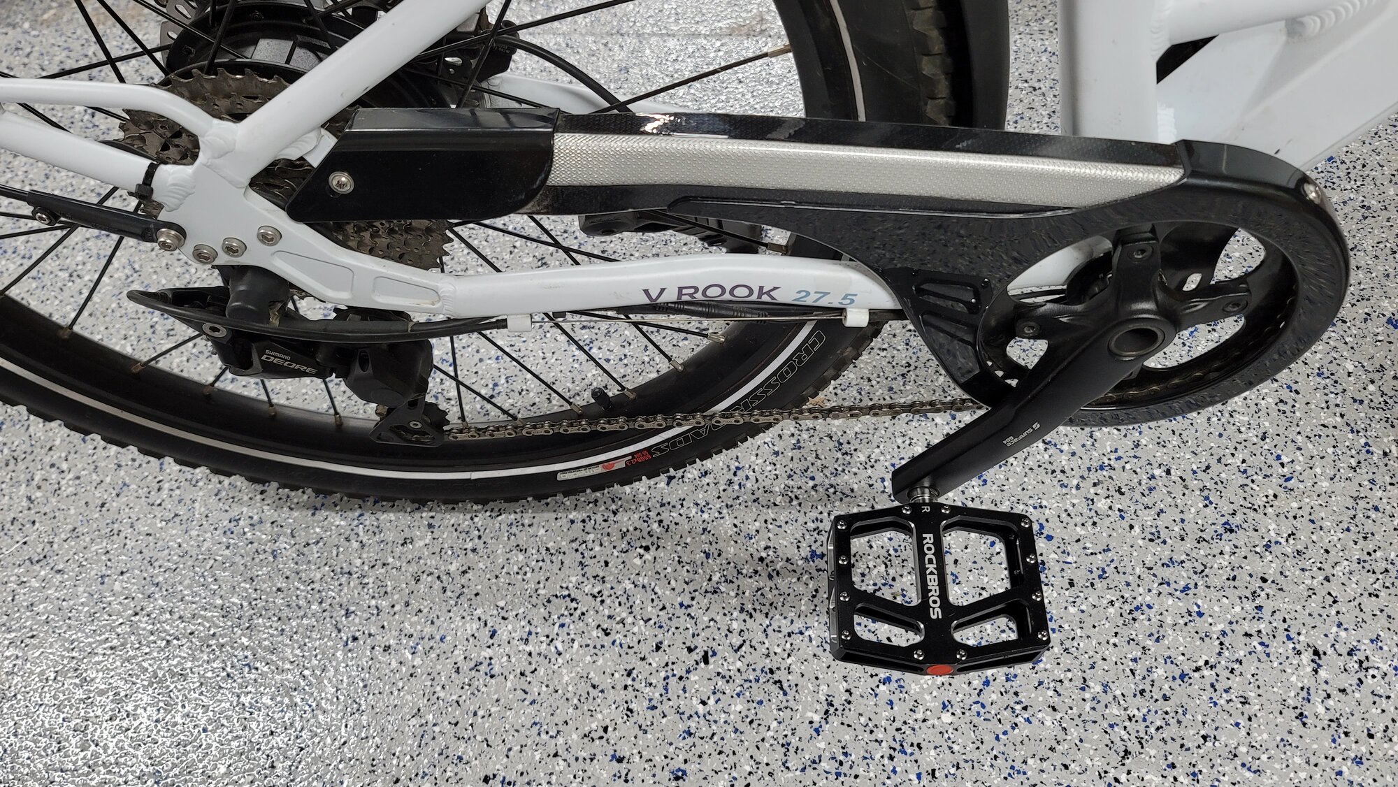

New ROCKBROS "wide" alloy platform pedals arrived today. Impression after the first test ride (14.3 mi, 573 ft): Heck yeah!

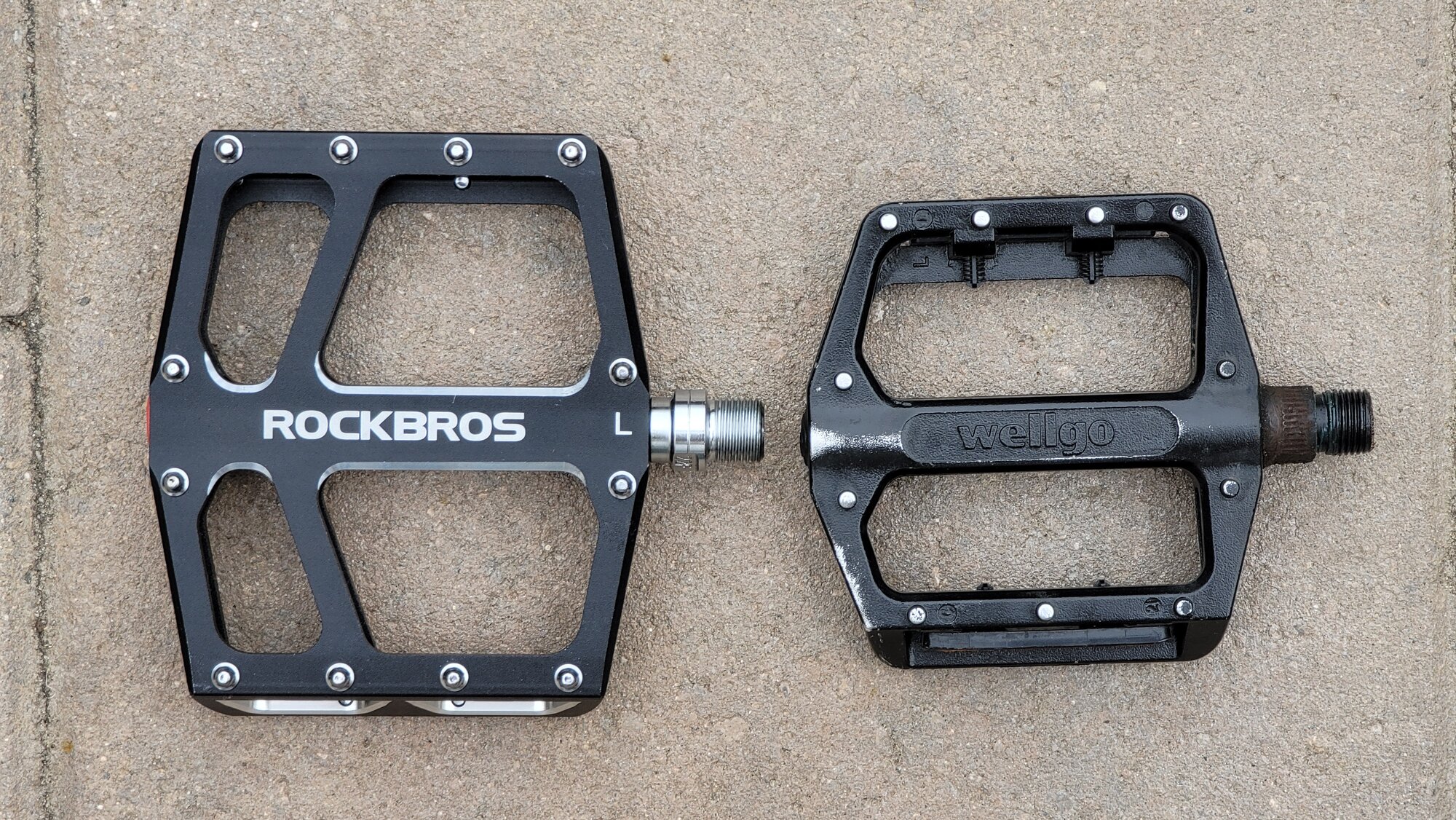

The new pedals (left) are nominally 120x104 mm (LxW), but the foot contacts actually measure 118x105 mm. The foot contacts on the stock alloy Wellgo pedals are only 90x97 mm by comparison.
That makes the new foot contacts 28 mm longer and 8 mm wider, but the size difference looks and feels even bigger. Weight feels about the same.
Grip's now MUCH more secure, and it's easier for my ground foot to find a good spot on the pedal when starting out. (Brain doesn't track my feet like it used to due to peripheral neuropathy.)
Tried the mid-foot position (spindle under arch) that the even longer 143x95 mm Catalysts were designed to support with very promising results. Hard to be sure, but the Catalyst claim of better hip extensor recruitment with the mid-foot position may be more than just hype.

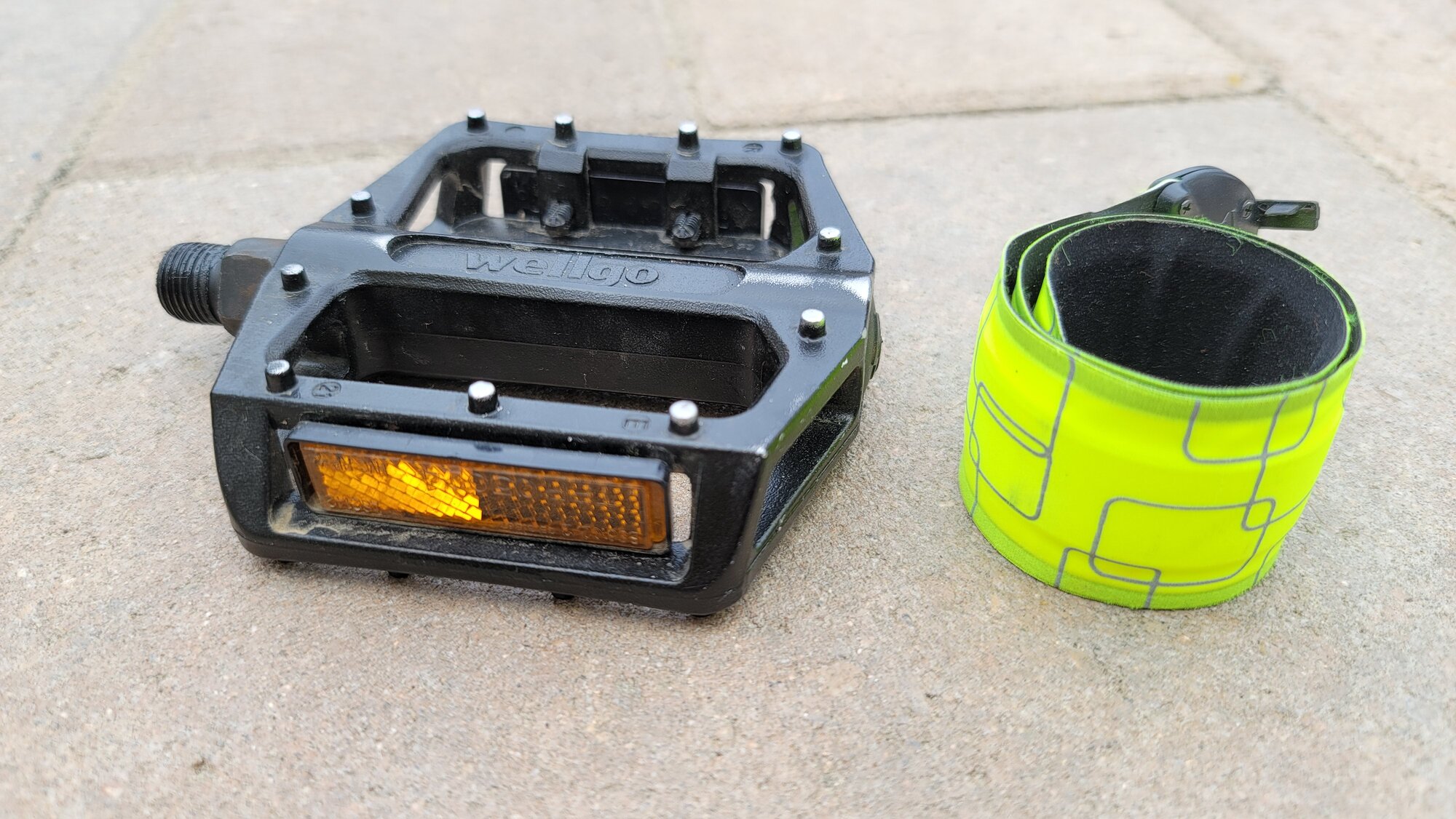

Would have peferred pedal reflectors for night rides but can wear one of these LED slap bands on one ankle to get back some of the lost visibility.
