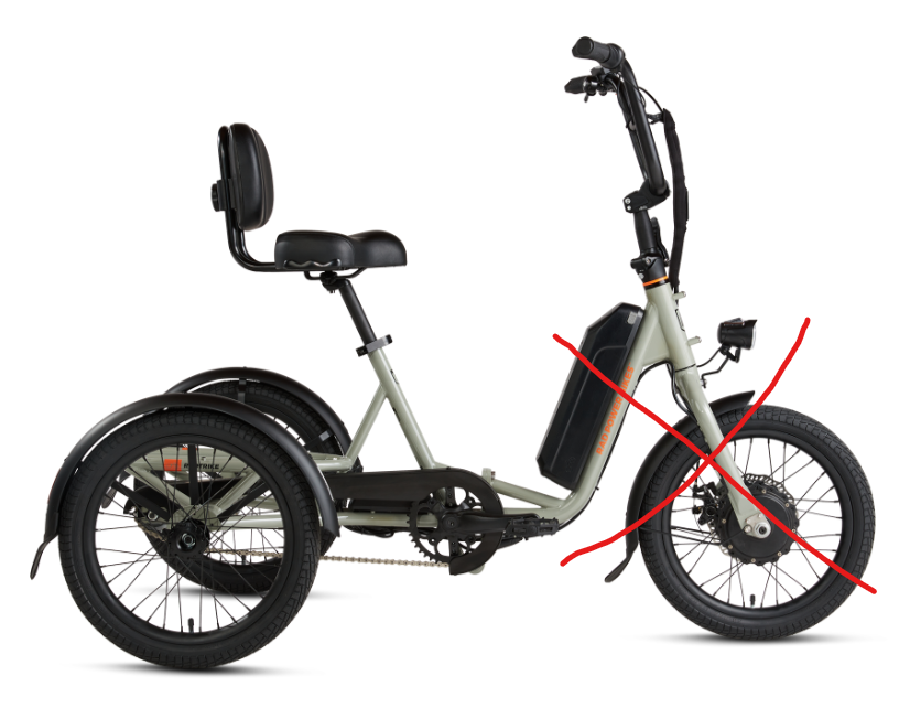

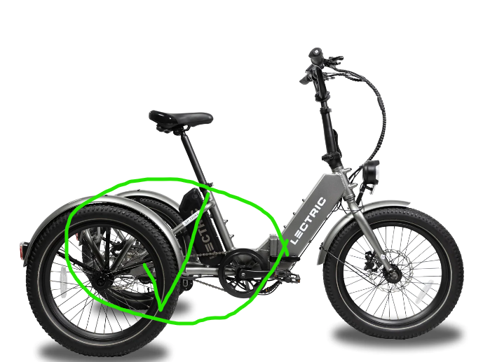

Honestly that new Lectric ticks a ton of the right boxes overall. One key detail that I haven't seen mentioned here related to the potential for tipping - the Lectric's battery and motor are both low and behind the rider - putting the weight there between the back wheels should definitely help keep it more stable and less likely to tip. Anything with a front motor/battery is going to be putting a lot of weight in the worst position!
Also nice that it is driving both rear wheels - front hub motors are definitely at the bottom of the totem pole for a reason - they don't handle nearly as well as a rear hub or mid-drive, since you're combining power output with the steered wheel, it increases the possibility of loss of control.

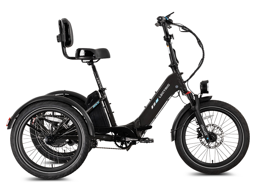

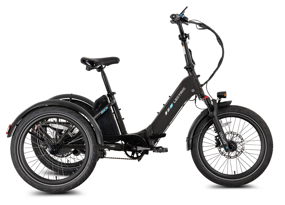

Folks are receiving their Lectric XP Trike these days.. I'm looking forward to receiving mine on FRI.
Here are some pictures from the FB group:
