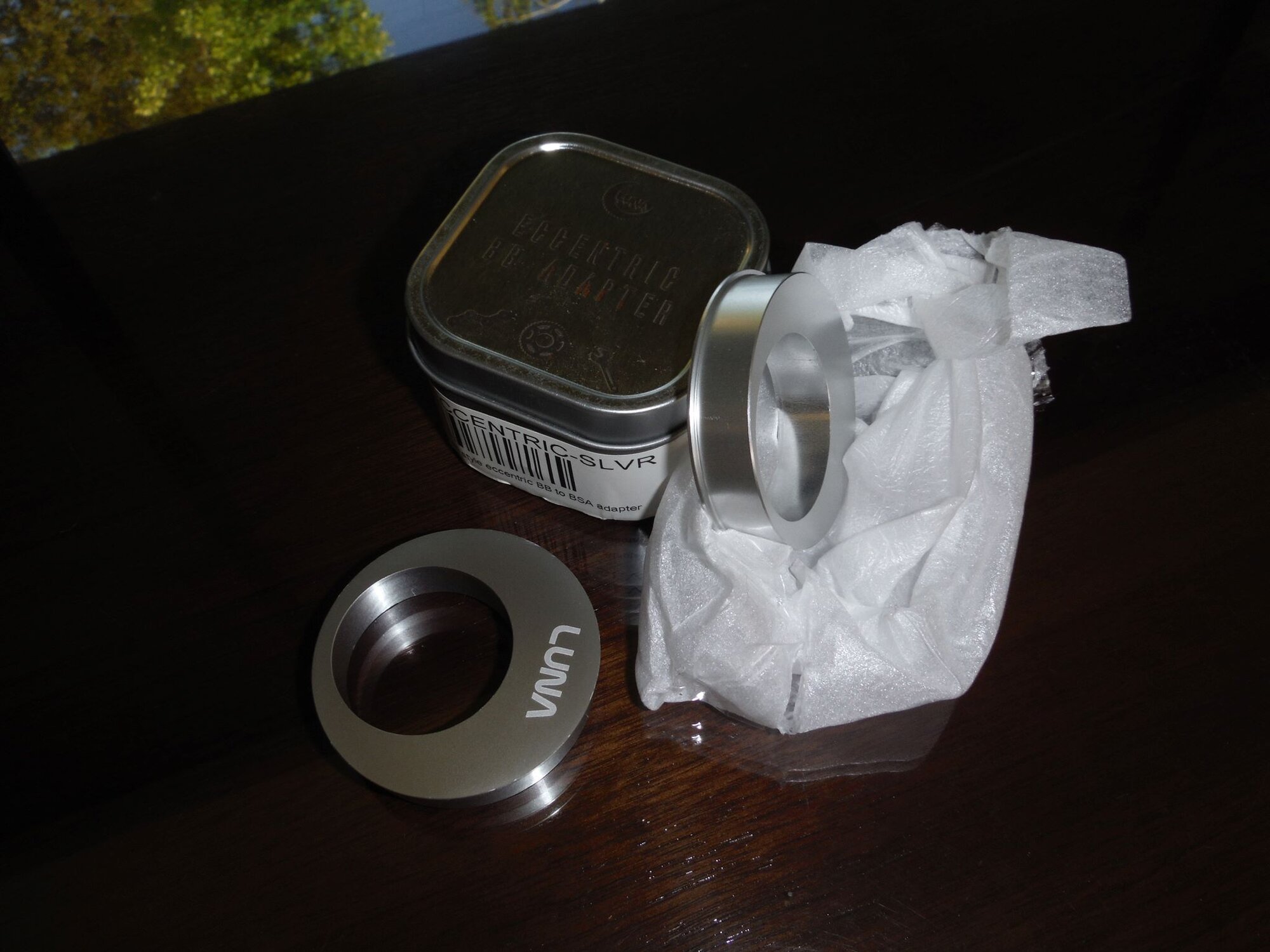

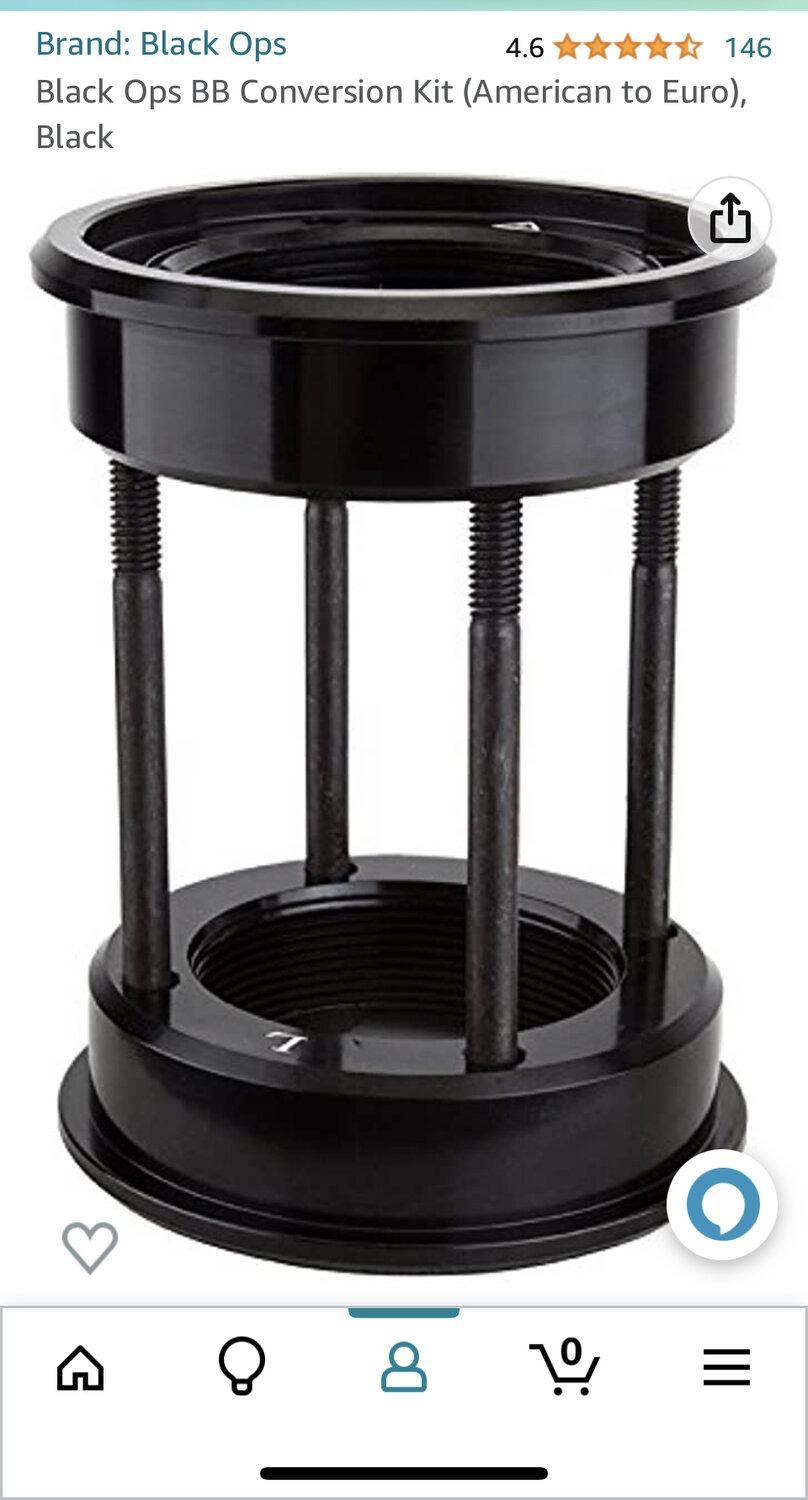

I believe there is a conversion kit to replace the one piece crank, some of the older members may be able to verify.
Kevin,
There is and they look like this. The adaptor must be eccentric (off center) and convert from an 'American' bottom bracket to 'English.'

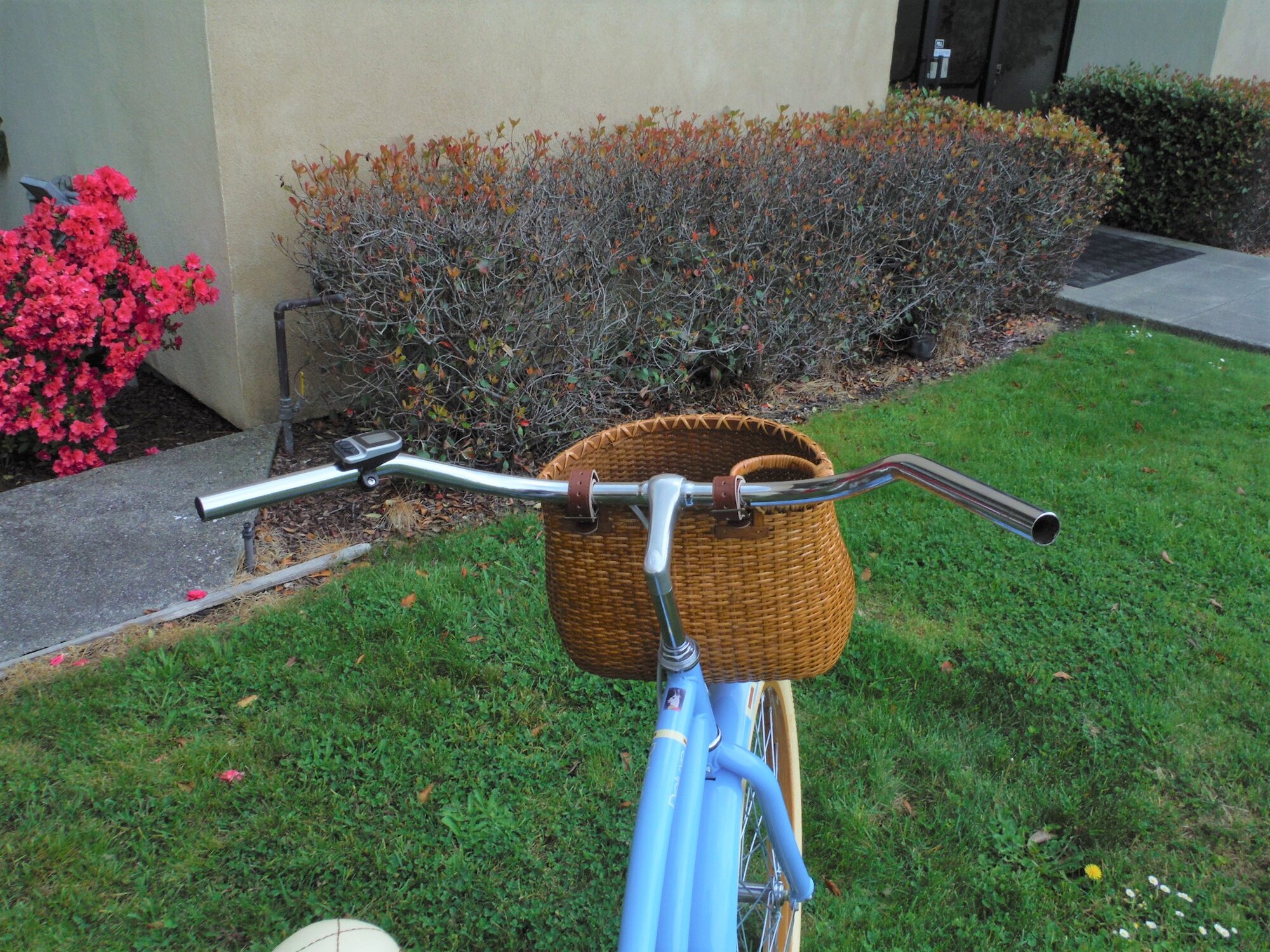

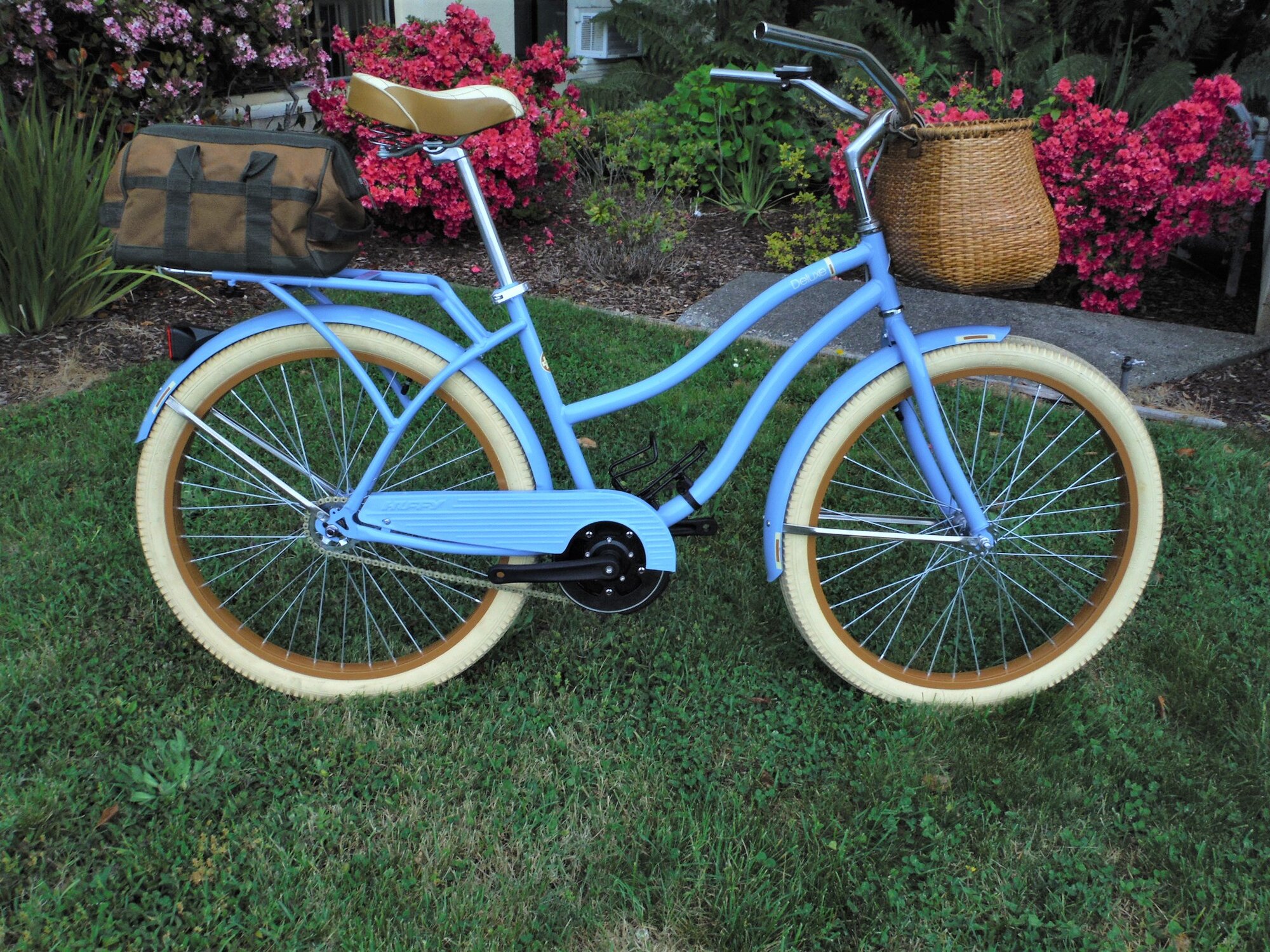

I used one last week when I converted this nine-year-old Huffy. It was a free bike and sold Saturday to a Fashion Designer. The matching grips, nice saddle, and brown pedals arrive tomorrow. She says it is the most beautiful bike she has ever seen. I staged it with flowers in the basket's cupholder. The single piece BB weighed as much as a sledge hammer. This is what a clean build of an electric bike can be. The battery slides into the bottle cage.

That is so true, so be carful. The distance from the bottom of the frame's BB shell needs to be very close to the motor, 4 or 5 mm max, the thickness of two nickels to clear. That factor does not come into paly if you are installing an analog English BB. That can be centered. A conversion requires an eccentric adaptor.
