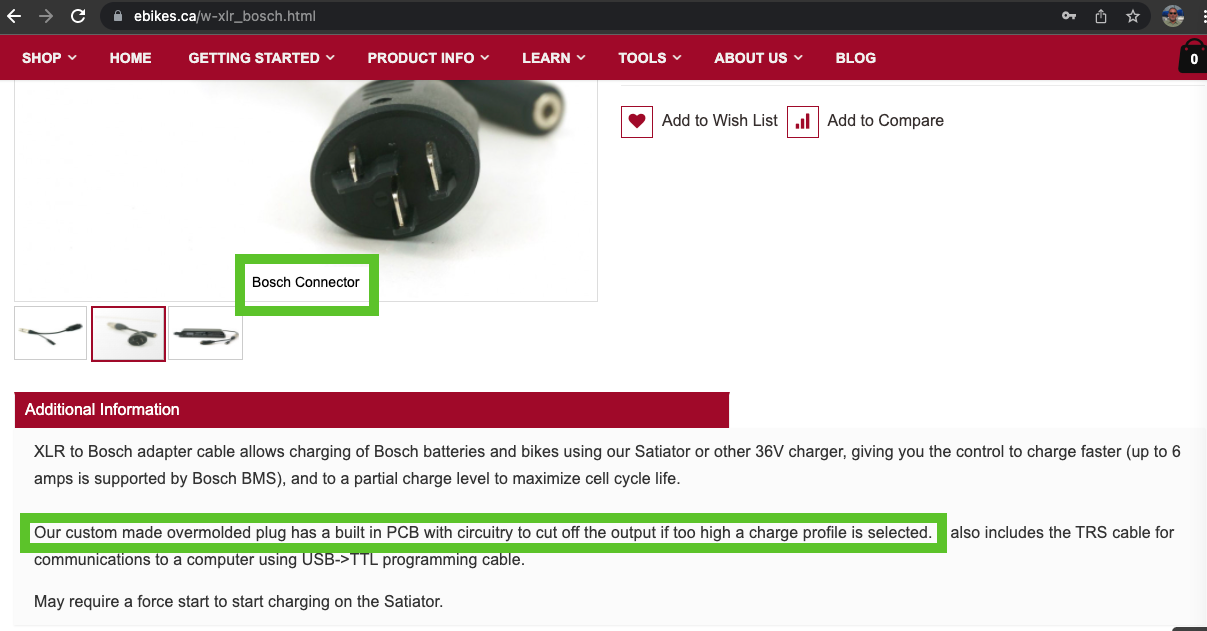

No one is trying to change your mind or convince you. But that doesn't make you right. FOR ME the Satiator works. Multiple batteries and voltages with a single charger. Obviously you don't know Grin very well.
