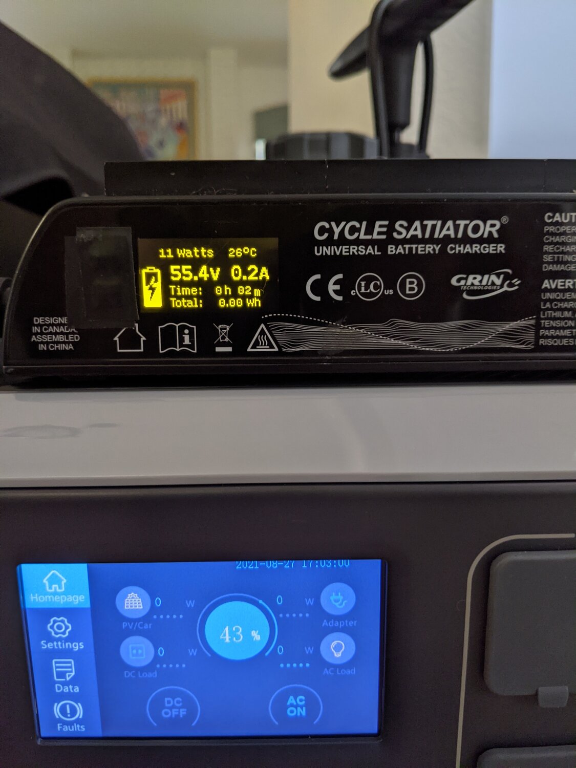

It's built into the software, but the sensor is not, you have to DIY add it to the cable as specified.
My Satiator does display 🌡 on lithium packs , but I did the custom work on the cable , had to cut the cable from the original cheap and inferior 4A charger and solder those 3 20AWG cables to the Neutrik gold XLR connector , so yea now i realize how the thermistor was created...thx !
It did almost 3 years already , 300+cycles with no issues, GRIN TECH should build an ebike, the knowledge and parts r there.
