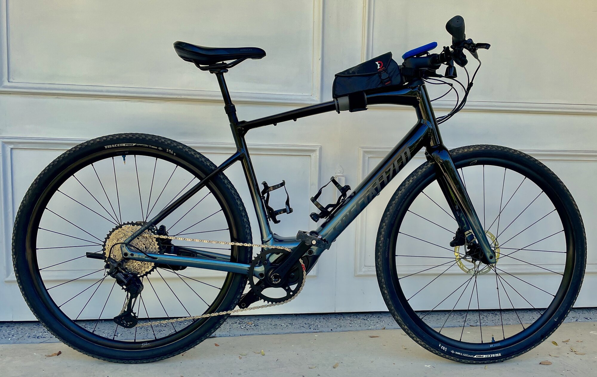

We decided to convert Mrs levity’s Vado SL EQ to a GQ, i.e. make it a gravel bike “fit for a Queen”.
We used bits we’d saved from her previously modified Vado 6 and Creo to customize a new Medium sized SL:
EQ parts: Remove the lights and fenders since we’re fair weather riders in southern California. Keep the kickstand, it rocks!
Handlebars: Replace the OEM bars with Answer carbon 20/20 bars (20mm rise and 20° sweep for hand and wrist comfort). Bars were shortened to 700mm wide, but are 20mm wider than the OEM bars providing more control leverage.
Handlebar height: Lower the bars to a more aggressive position by flipping the stem down and inverting the bars to give a further 20mm drop. This put the grips level with the seat. Removing the stem spacers and using the 15mm shorter “duckbill” topcap was not enough. A pad was installed on the top tube in case the lower handlebar controls hit during a crash.
Dropper post: PNW 90mm dropper internally routed with Wolftooth bar remote.
Wheels: Light Bicycle carbon rims, i30mm, DT Swiss 350 hubs.
Tires: Panaracer GravelKing SK 27.5 x 1.9. These measure 53mm (almost 2.1”) at 30psi on the i30 rims and have plenty of clearance in the fork, seatstays, and chainstays.
Seat: Ergon Core Prime for the ultimate in comfort.

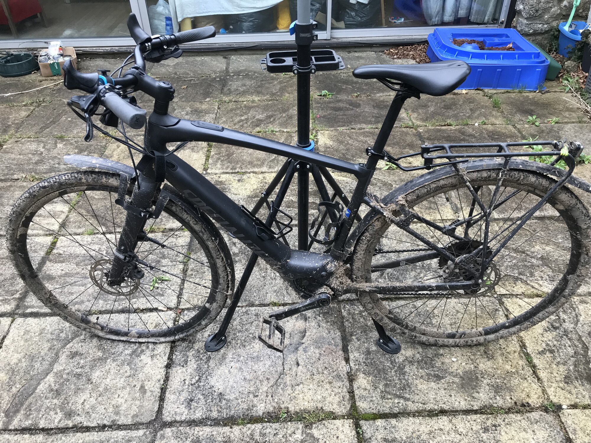

The pic below is of the bike the morning after a particularly muddy winter ride, just about to clean it!
Plus my first puncture in a year and a half. Luckily it was a slow one, didn't discover until that morning, was a tiny thorn in the sidewall.

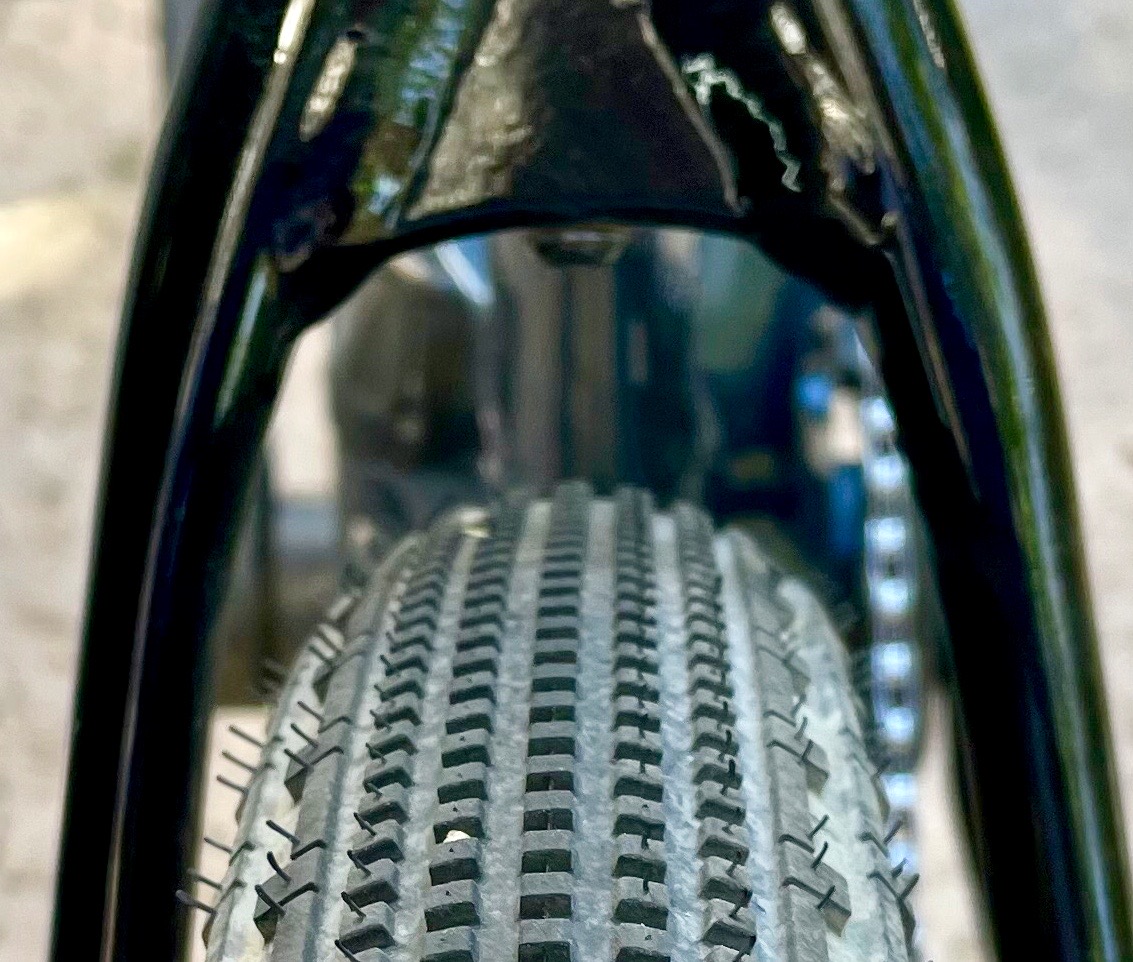

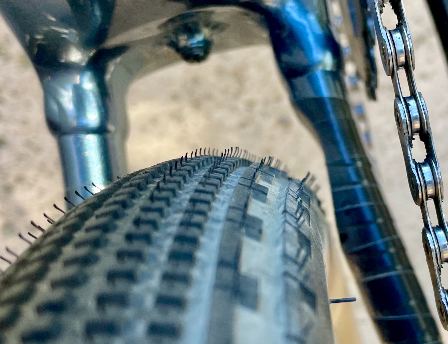

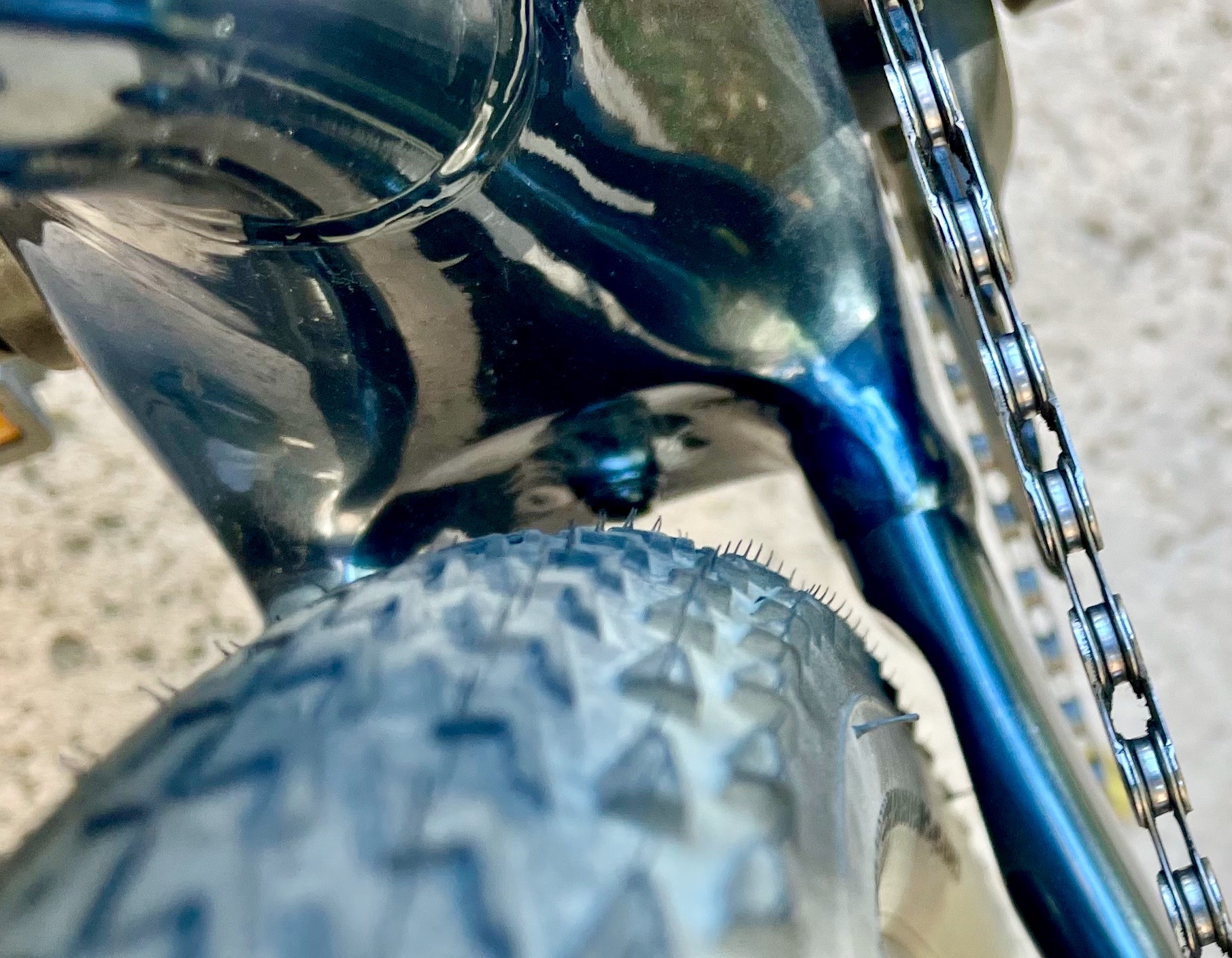

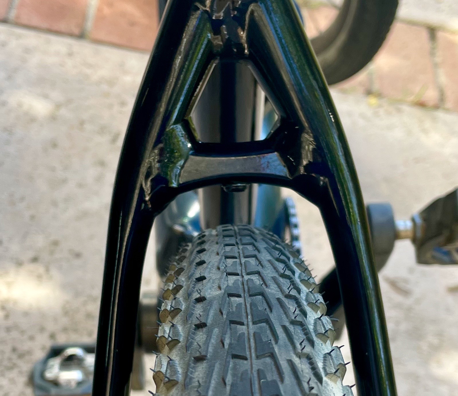

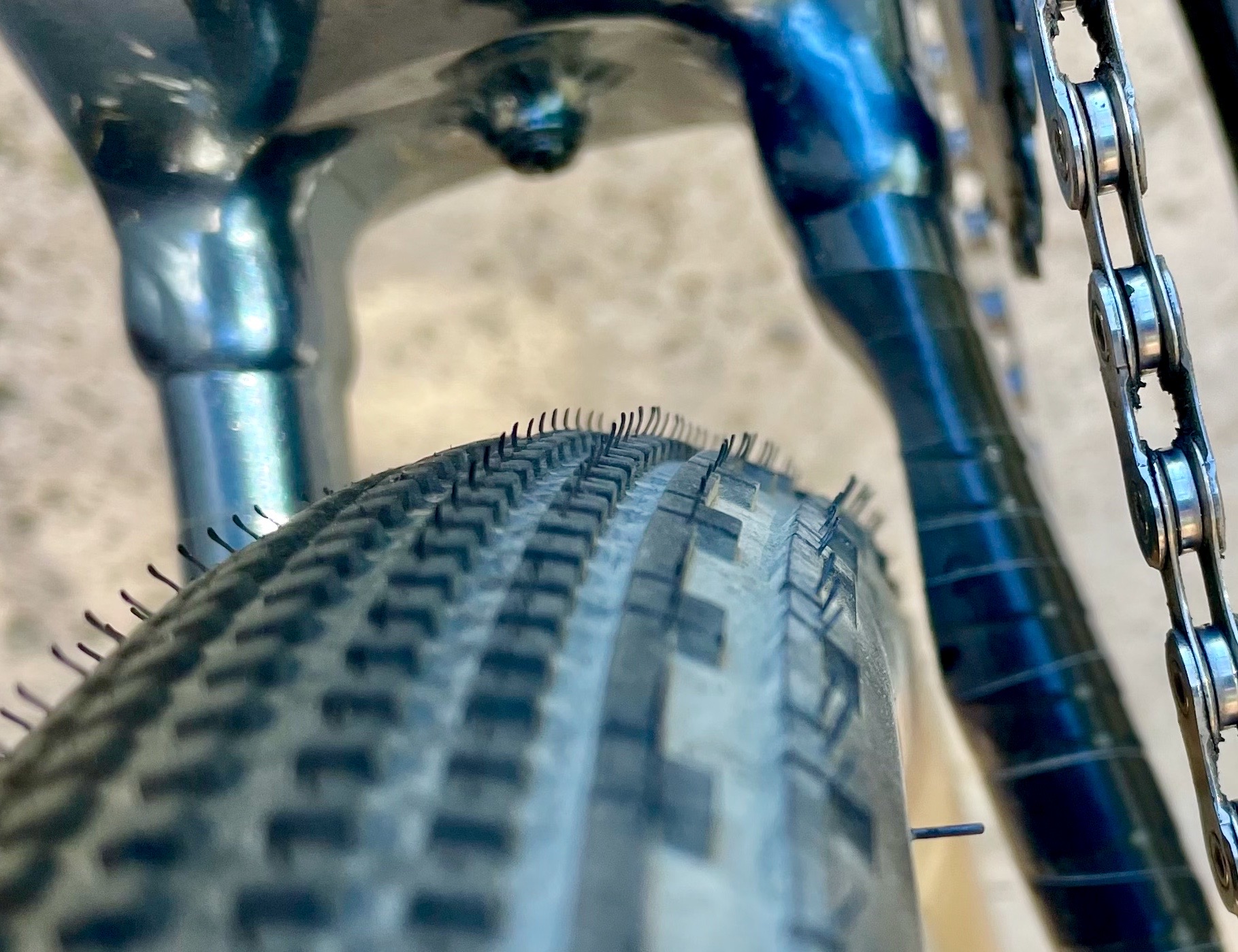

Here are some pics showing the rear tire clearance (click to enlarge):
Mrs levity’s SL with the 27.5 x 1.9 GravelKing SK rear tire has ~8mm clearance at the seatstays and 3-4mm clearance at the chainstays
The 700x47 Tracer tire on my SL has ~8mm at the seatstays and 4-5mm clearance at the chainstays
View attachment 114267 View attachment 114268
View attachment 114270 View attachment 114269
Great pics thanks. Surprising amount of clearance at the stays. Thats great to see. Which model is in the pic with the seat stay bridge? Is that a creo?

@Rás Cnoic - The pic above with the seatstay bridge is my Large Vado SL 5. The seattube on the Large size is longer than on mrs levity’s Medium, so the seatstays are longer and attach higher up allowing space for a separate bridge.

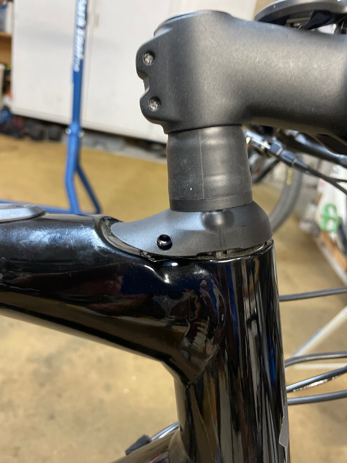

and here’s a close up of the stem/headset area with the short duckbill/5mm spacer combo that I now use:

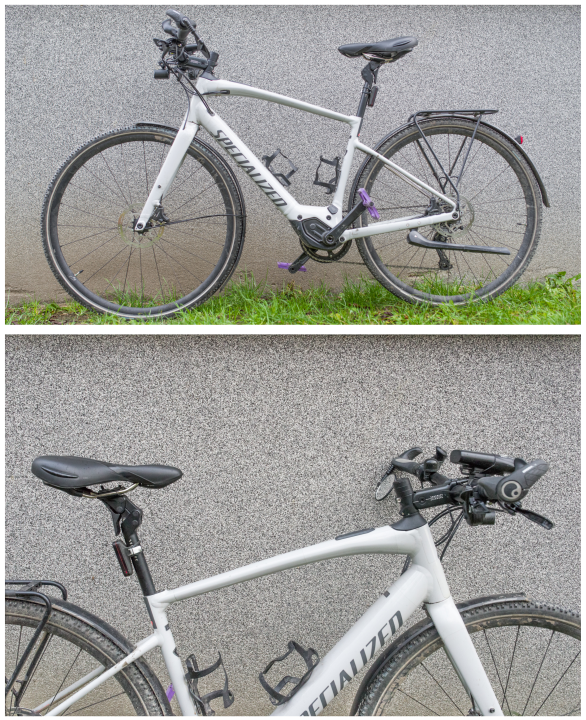

A 700x42 Pathfinder tire will fit in the fork of the SL with fenders. However, we found that the largest tire that would fit in the back with the stock rack and fenders was 700x38 due to contact with the small bolt in the center of the rear rack that attaches it to the fender. If you remove that bolt you can fit a 700x42 in the rear. Mrs levity rode it like that on a few rides before she switched to 650b wheels & tires. You may be able to use a shorter bolt or nut.

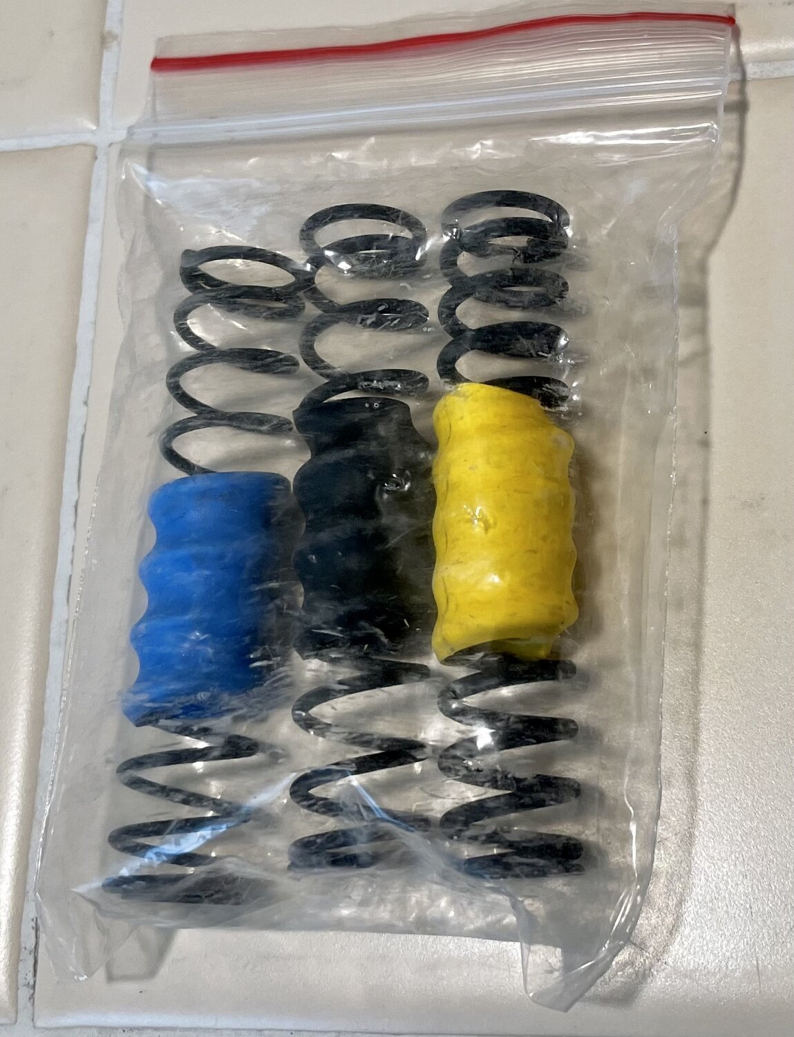

re Future Shock 1.5 springs – You’ll have to check your bike. Neither of our bikes came with any spring at all! When I asked our LBS about this they gave us a couple of kits that came with other Specialized bikes but had not been used. You might ask your shop or just buy a kit on eBay or from Specialized direct. Mrs levity uses the soft (blue coded) spring, and I use the mid-firm (black coded) spring. These seem to work fine so we haven’t bothered to experiment.

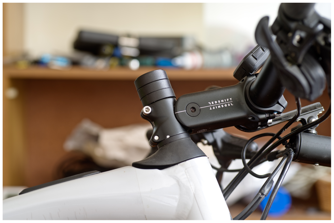

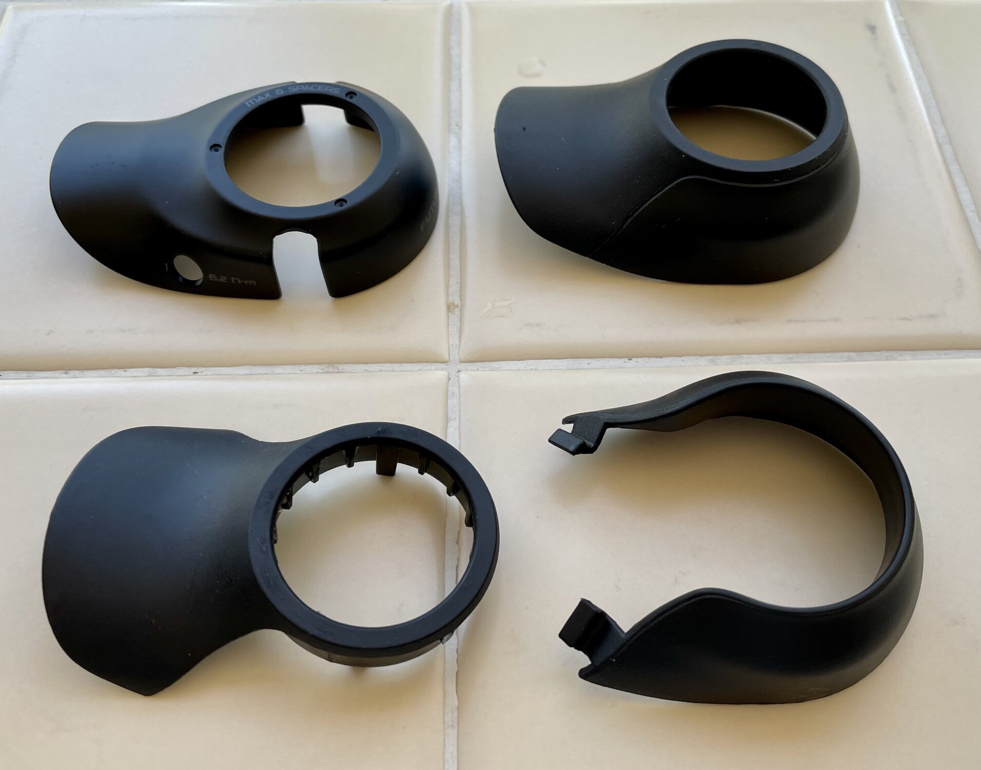

The “duckbill” is the plastic topcap spacer that sits on the base of the Future Shock just above the frame. The photo below shows a short duckbill, a tall duckbill (15mm taller), and a tall duckbill snapped apart. The short version has a hole on the drive side to allow direct access to the 4mm hex bolt that clamps the future shock into the steerer tube. The tall duckbull has to be snapped apart to gain access to the bolt. Specialized bikes usually come stock with the tall version installed, but you should have received the short version to enable you to lower the future shock/stem/bars.
All you need to do is loosen the 4mm hex bolt and pull the future shock/stem/bars out as a unit together. Then you can switch duckbills and remove any spacers. Keep some weight on the bike’s front end when doing so. When you reinsert the future shock you’ll need to make sure the bars are aligned correctly, then tighten the 4mm hex bolt to 4Nm (same torque as for a stem or handlebar). Easy, breezy.
If you lower your bars make sure none of the controls hit the top tube when the handlebars are rotated full lock. It they do you could damage the frame. We zip-tied a pad to the top tube of our bikes to protect it (see photos in posts above).
I can't make out what has been done to the Future Shock that usually comes on the Vado SL 5. Looking at the top photo you posted above it appears that you may have replaced your future shock with some sort of extension (?). Whatever it is protrudes out too far judging by the 3 large spacers above the stem. I recommend lowering the extension/shock so that the top cap is flush with the top of the stem to get rid of the spacers. The system will be stronger with the extension/shock inserted further. IIRC, Specialized recommends using no more than three 5mm spacers between the tall duckbill and stem to insure that the future shock is inserted enough to hold. Your bike appears to have three 10mm spacers above the stem. Thus the extension/shock may be as much as 20mm too far out and could come loose or fail. I realize that your stem is actually lower giving less leverage, but the section protruding above the stem could injure you in a crash.
I understand. Vado SL 4.0 comes with the duckbill but without the Future Shock. I wouldn't touch the part. My only concern is whether inverting the bars might lead to some unpredictable or inconvenient results.
