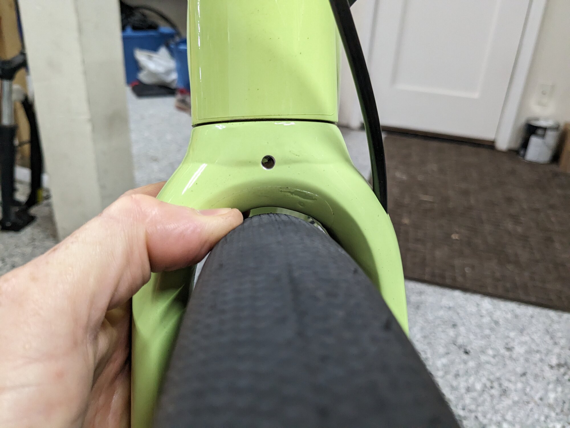

Minor fail on the 1st item on the fix of agenda. 50mm G-One speeds, which are a supple comfortable tire and are a spot-on exact 50mm, fit rear but not front with acceptable clearance. On front there is basically an eighth of an inch all around the tire at the crown of the fork. If you got badly out of true or if the wheel flexes it's going to rub.
In the back not so bad. Quarter inch right at the top of the tire, more around the sides. Not ideal for mud or whatever, but it's not a mud bike.

A few general observations as I start to work at upgrading this bike. It seems very likely to me that when specialized does a generational upgrade to the Vado SL, there's going to be more clearance for wider tires. This frame was designed in the late 2010s, basically right before most bike companies went away from the tight frame aesthetic and started prioritizing more tire clearance. Next generation they're going to make wider.

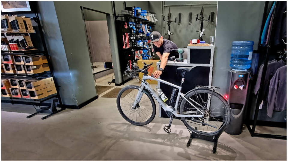

My Vado SL exactly 2 years post-purchase with all mods.
