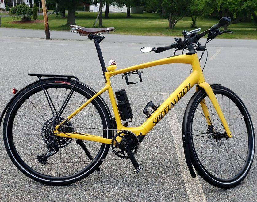

I have a 2022 Turbo Vado SL 5.0 EQ with large frame. I have modified it with an SRAM XD driver freehub, SRAM GX1275 10t-52t cassette, and Wolftooth 46t chain ring, all of which are a bit lighter than stock. The seatpost and handlebars are carbon fiber. I have augmented the cockpit with a Garmin Edge Explore 2 and added blinking headlight and taillight to improve observability. The saddle is a leather Selle Anatomica H2 with aluminum frame.This bike now has a dry weight (no RE battery, no water bottles, no rack bag) of 38 lbs. This compares with the equivalent weight of my old 2015 Turbo (big GoiSwiss direct drive rear wheel) of around 55lbs.
As you can see, I often ride with the range extender battery, 2 water bottles, and I have a rack bag that can carry a 2nd battery, tools, spare tire, wallet, etc.
On a recent long distance trip, my maximum all-up weight (bike only) was around 54-55 lbs with RE battery, 2 water bottles, and rack bag with spare RE battery, charger, spare tubes, tire changing tools, miscellaneous emergency supplies, and some quick energy food.

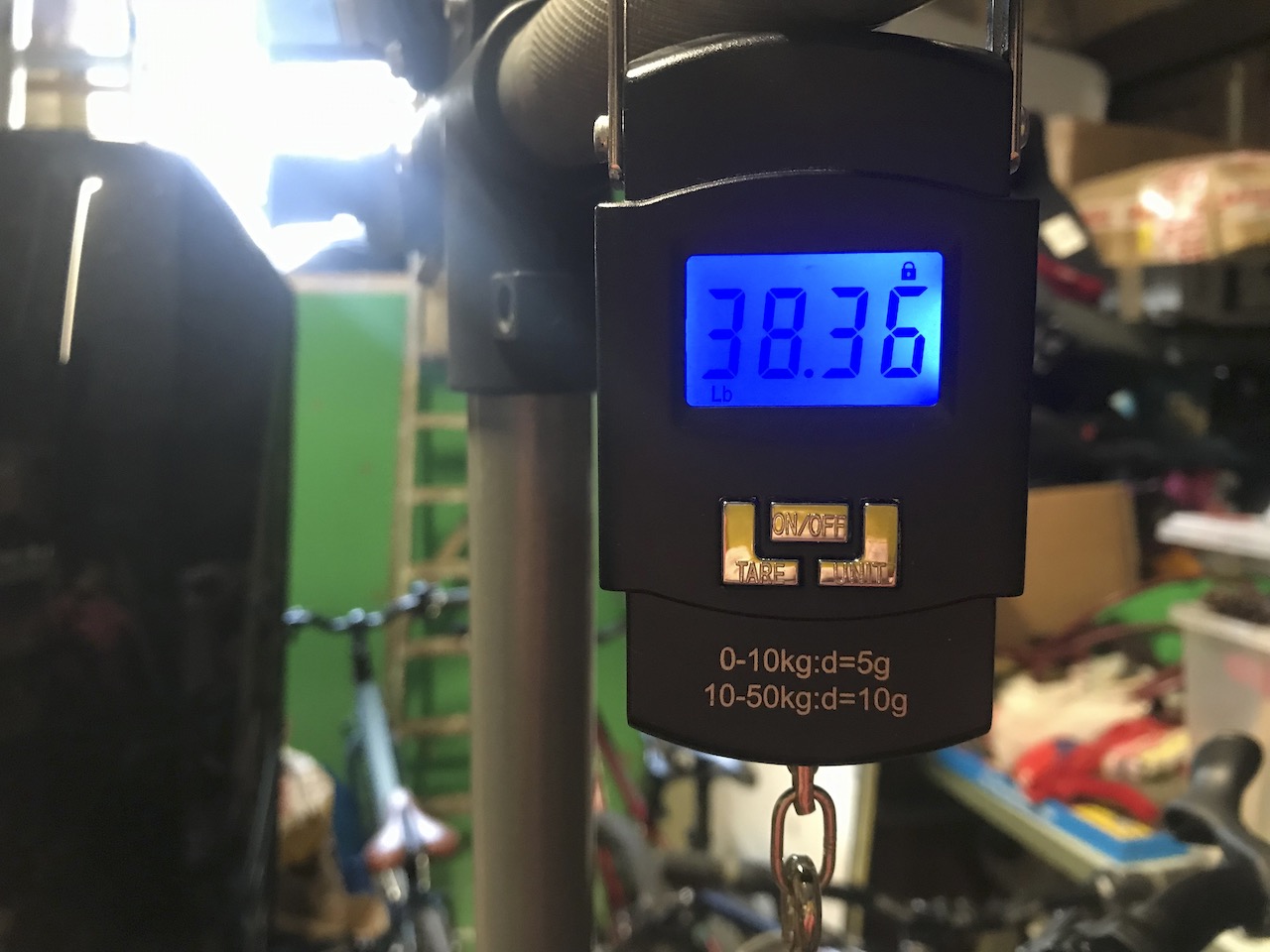

So my SL comes in at 38.36lbs which is disappointing. Had it in my head it would be around 36lbs. Size medium. It has a rear rack and mudguards not stock, both feel pretty light. And a KlickFlix handlebar adapter for a bag. Cassette is an 11-46 so probably heavier then the stock 11-42. I guess all the bits add up. Not sure what the WTB Byways weigh either. This is without saddlebag with mini tool spare tubes etc and without water bottles.

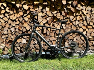

My Vado SL 4.0 EQ size M has the label "17 kg" (37.4 lb) and it actually weighs 17.15 kg (37.8 lb). Not much a difference.
Mods:
  • Shimano Deore CS-M771 (10 sp, 11-36T) cassette
  • Redshift Shock Stop suspension stem, 100 mm, +/- 6 deg
  • Redshift Shock Stop Computer Mount
  • Redshift Shock Stop Utility Mount
  • GoPro camera mount (for the Lezyne headlight)
  • Redshift Shock Stop suspension seatpost
  • SQlab Innerbarends 410/402 and SQlab handlebar grips 710 (short)
  • Mirrycle mirror
  • Two Specialized Zee Cage II
  • Crankbrothers Stamp 3 pedals
  • Removed the front fender and replaced it with an AssSaver
  • Removed the rear mudflap
  • Replaced the tyres with Pathfinder Pro 2Bliss 38-622 (tubed)
Funnily enough, all these mods did not significantly change the e-bike rated weight. If I removed the mirror, my Vado SL would be at 17 kg as advertised.

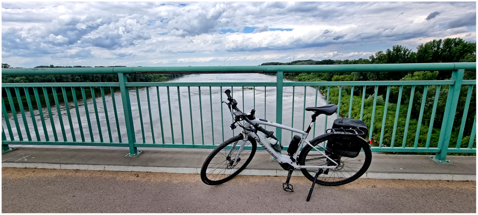

From a 122 km (75 mi) ride of yesterday.

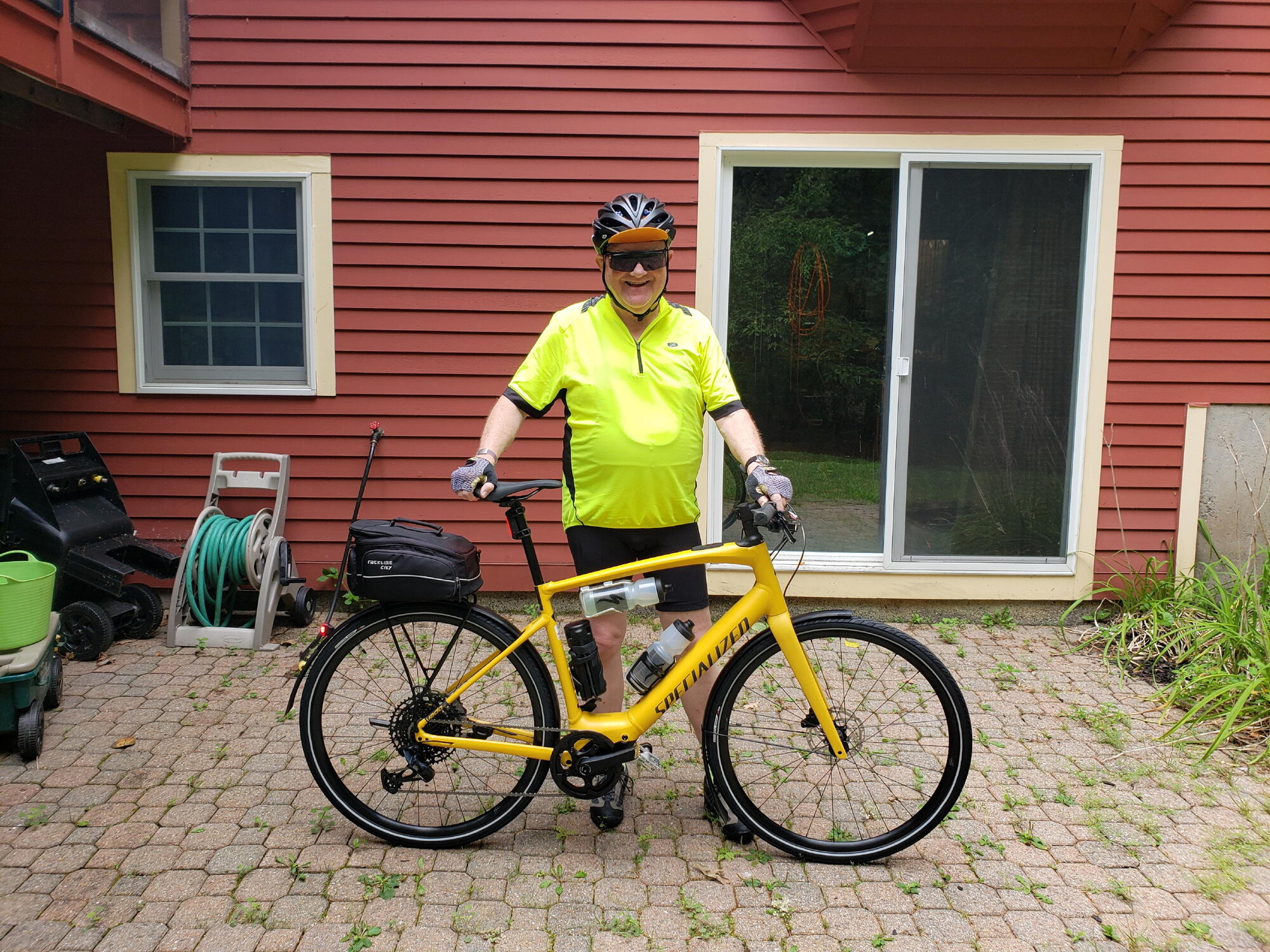

An update...I have resurrected an old under seat bag for spare inner tube, tire levers, Co2 bottles, inflater, and universal tool. This saves over 4 lbs compared with my Racktime trunk bag. I also removed the kick stand. My dry weight is now 37 lbs instead of 38 lbs, Weight with seat bag, extra flashing taillight and headlight, and Garmin Edge Explore 2 is around 39 lbs. All-up weight with one range extender and water bottles will be around 45 lbs. This is fine for 40 mile(ish) day trips at a brisk pace and 50 mile at a reserved pace. Adding the 2nd range extender and the Racktime bag ups this to well over 50 lbs and extends my range to 60+ miles with a larger carrying capacity.
