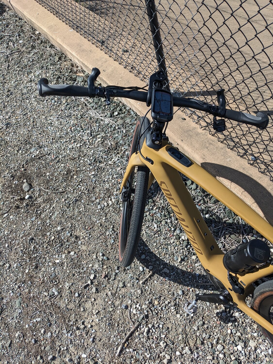

Skitch was (and is still not) available in my size. So got a Creo 2 comp, swapped out the handlebars and brake/shifter levers for a flat bar, flat bar brake levers (same as on my Tero) and an AXS shift pod. Added Ergon GP2. And the Skreo was born :). Turns out the additional parts still kept the Creo 2 conversion to about the same cost as the flatbar Skitch AXS would be. Only have a couple hundred miles since the conversion but I am really liking it. Downside is the Skitch's Fazua motor seemed a bit more powerful as well as having the fun boost option., Upside is the 1.2 motor is still pretty good and much improved over my 4 year old Vado 4.0 SL motor, I get to use the range extenders I already have and the future shock along with the fatter tires make the ride more comfortable than either my Vado SL or the Skitch that I tested. I also like the stock specialized assist bips and the added AXS shift pod more that the controls that were on the Skitch. And I would have added the Ergons to the Skitch anyways. Only thing I really didn't like about the Skitch was the stock round grips.

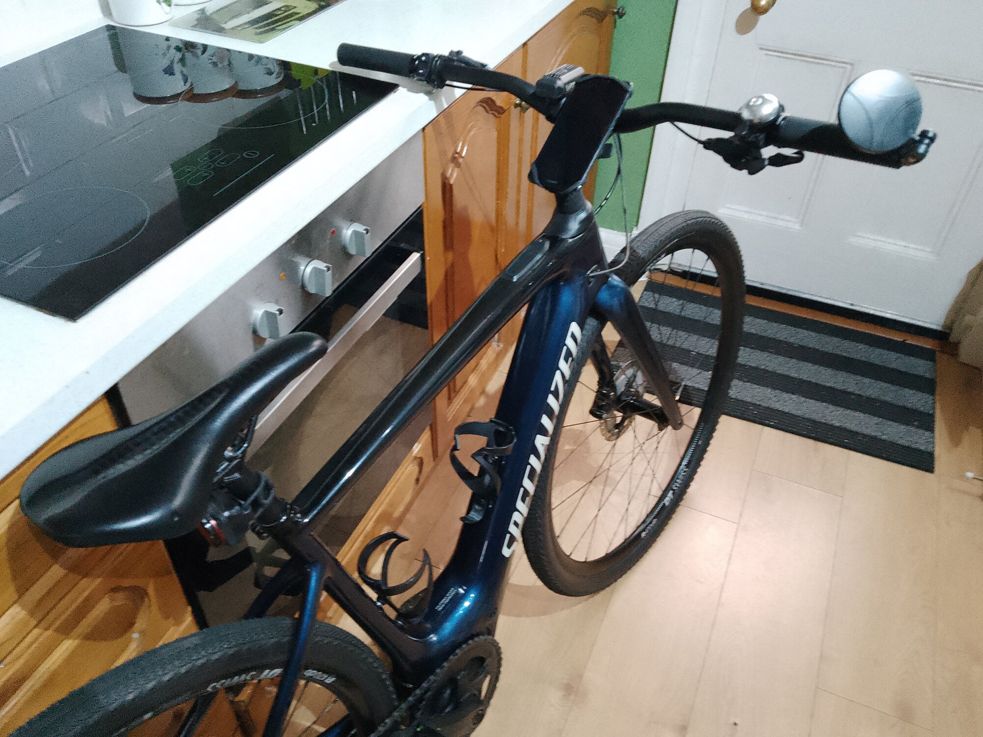

Nice, I have really enjoyed the Creo since I flat bar converted mine, it was a great bike before but back problem forced the issue, after 4 yrs of ownership I feel I have got it exactly right for my use.
