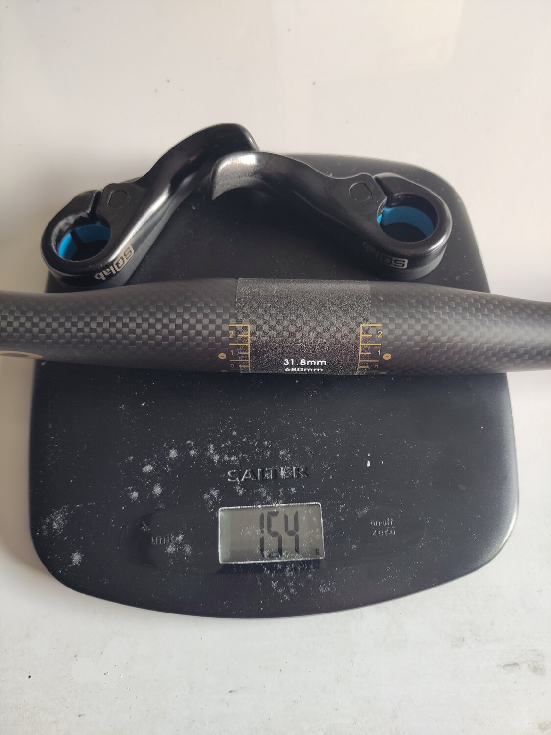

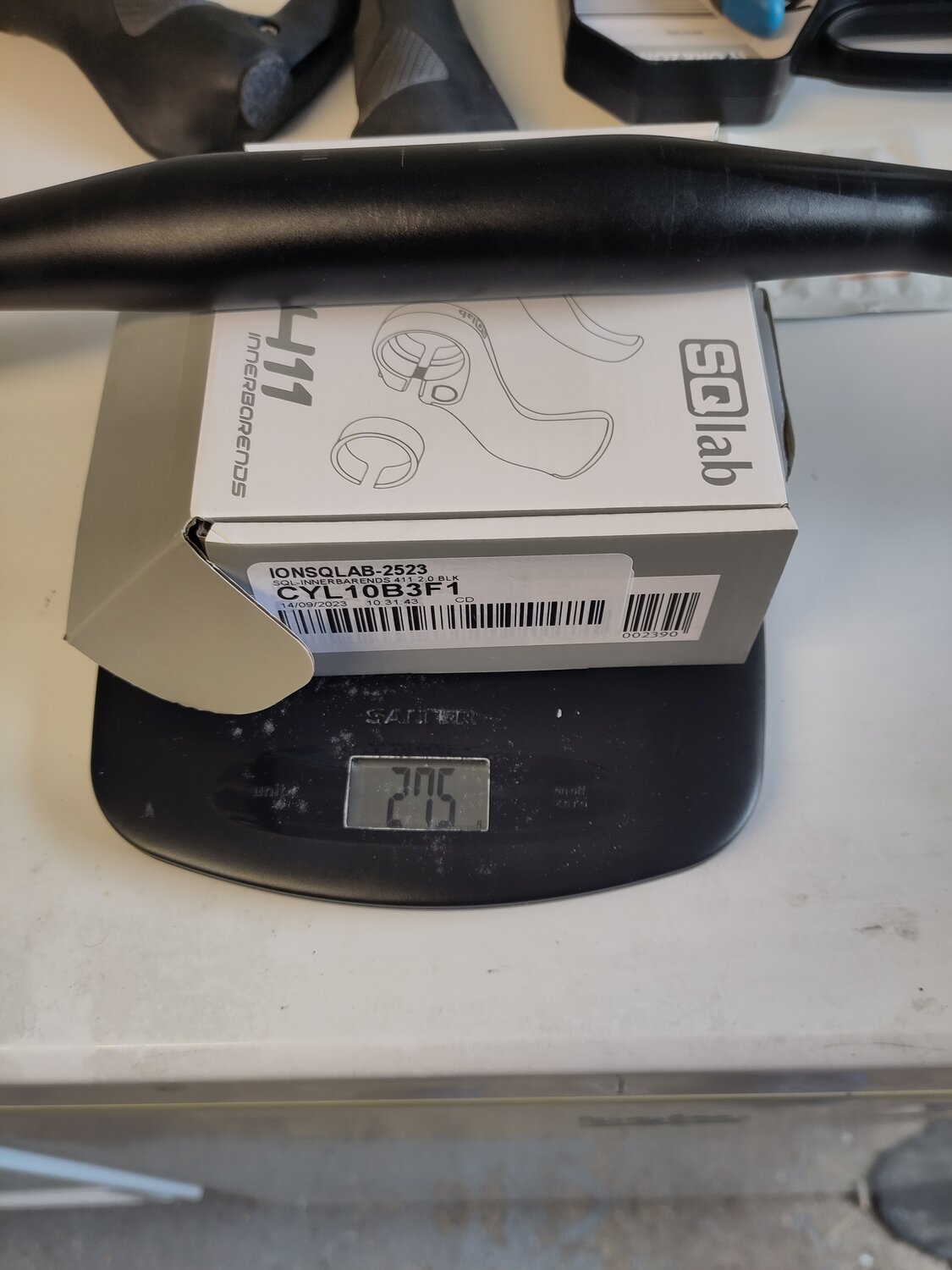

I'll be interested to hear your thoughts. That bar looks like a 'dead ringer' in form/shape/sweep when compared to the OEM Vado SL bar....BUT CARBON!! Shweet.
And a great deal lighter too!
I'm a fan. I've had them on a few of my gravel/city bikes and love the ability to get another hand position with straight bars. Good on long rides. There are cheaper off-brand ones available, but I have some other SQLabs stuff and am happy with it.

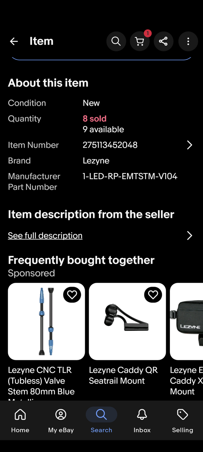

Important Note To Consider: Your front headlight mounts to your OEM stem and is handled via a Specialized plastic mount which affixes/slides into a 'notch' which is part of the bottom portion of your OEM metal stem. Once you remove your OEM stem to replace with the RedShift stem you lose the mounting notch and you will need to find an acceptable solution to re-mount your headlamp. I pondered many of these solutions which can be found here at the forum....some more sophisticated than others but few satisfactory to me. I came across a Lezyne (the manufacturer of your headlamp) stem mount part number 1-LED-RP-EMTSTM-V104. Surprisingly this part is not so easily available via retail but I found it here on ebay for $20 https://www.ebay.com/itm/275113452048 While I waited for this to arrive....I simply zip-tied the headlamp to my RedShift stem.
This Lezyne headlamp stem mount arrives with everything that you will require to smartly mount the headlight along with your RedShift suspension stem. It will mount to your choice of the front top two stem mount screws or the bottom two stem screws....whichever works best for you (I used the lower screws). I had posted some photos of my installation here somewhere.....but it results in a clean, smart looking, and very secure way to re-mount your headlight....in fact better than original in my opinion.

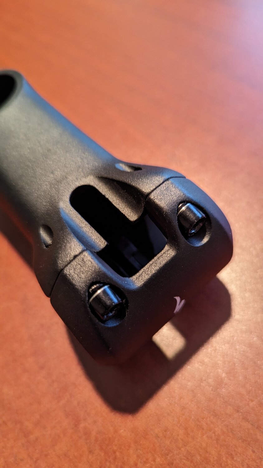

Here is your OEM stem uninstalled from the bike.....bottom view....and this 'notch' or cut-out is where the plastic mount atop your headlamp slides into the stem for mounting purposes. Once you give up the OEM stem you also give up this method of mounting the head lamp.

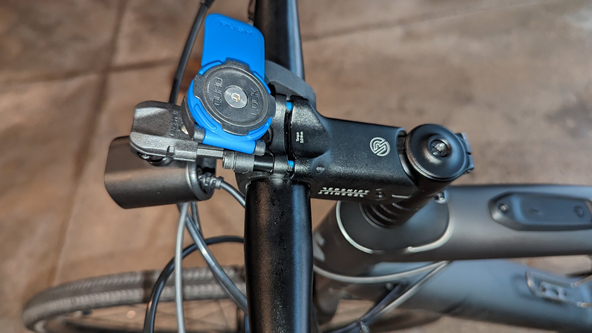

and here is a photo of the headlamp mounted with the Lezyne stem mount along with the RedShift stem:

I bought this https://www.ebay.com/itm/2751134520...URtwDhNRru&var=&widget_ver=artemis&media=COPY

The part number is up there. Made by Lezyne
