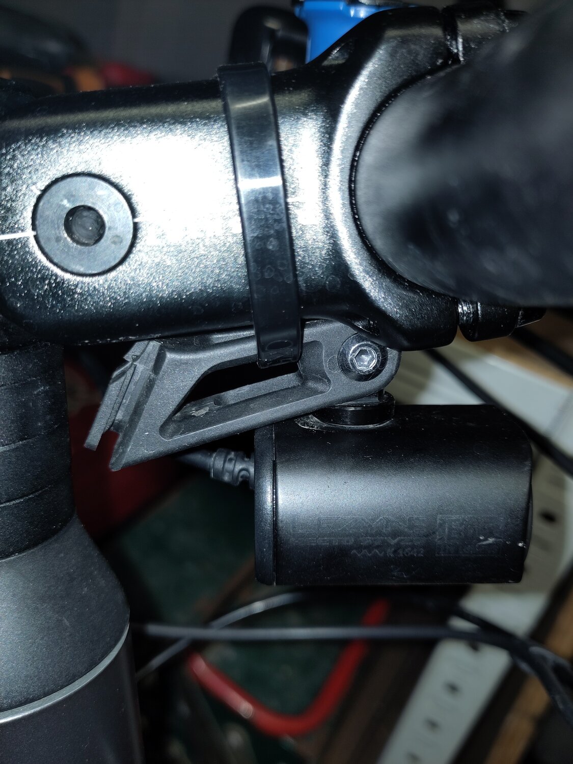

Additional issues are the location of the Garmin/TCD mount (if you need it), and especially relocating the headlight. I eventually went the hard way (the Redshift ShockStop Wahoo Computer Mount as well as Redshift ShockStop Utility Mount, and a GoPro mount installed on the latter for the headlight).

What will you do to relocate the headlight?
