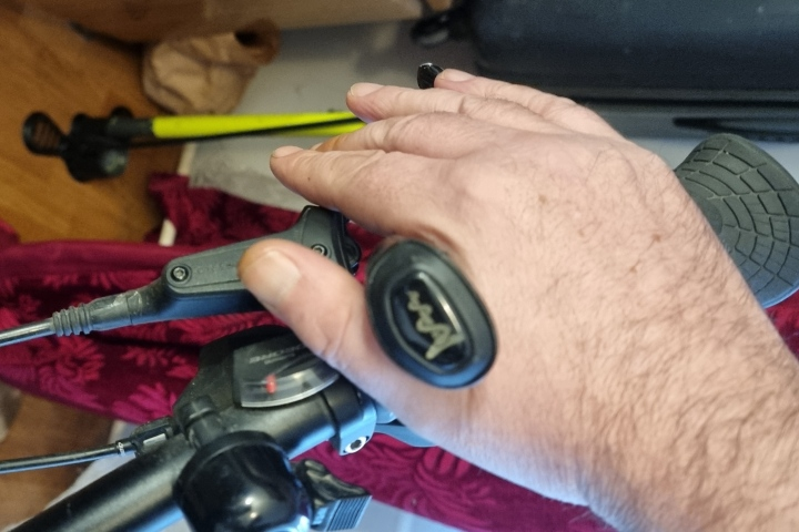

Often I will place my fists (or wrist) on the bicycle with thumbs faced upwards. In practice do innerbarends offer better comfort than this?
In the proper position, an Innerbarend is just a supporting point for your hand but it is not a grip. You hand actually rests loosely and relaxed with a big portion of it still resting on the regular grip, and the fingers delicately supported on the brake lever. The latter makes the access to the brake instant (helping save a kid that suddenly appeared in front of your e-bike, for instance).
I was thinking of Innerbarends on my latest Vado SL ride in really harsh terrain: it was a dry dirt road only consisting of deep bumps (made by tractors). I could have kept the regular grips but no, I noticed riding in the Innerbarends was giving me total confidence! It is only good to ride in gloves (fingerless ones for the warm season) for long distance as the IBE is hard; no need to wear gloves on relatively short rides though.
It is crucial to tweak the Innerbarend angle. In no case you should feel pressure or stress on your hand resulting from the Innerbarend (the bad sensation occurs when the IBE angle is too steep or too low).

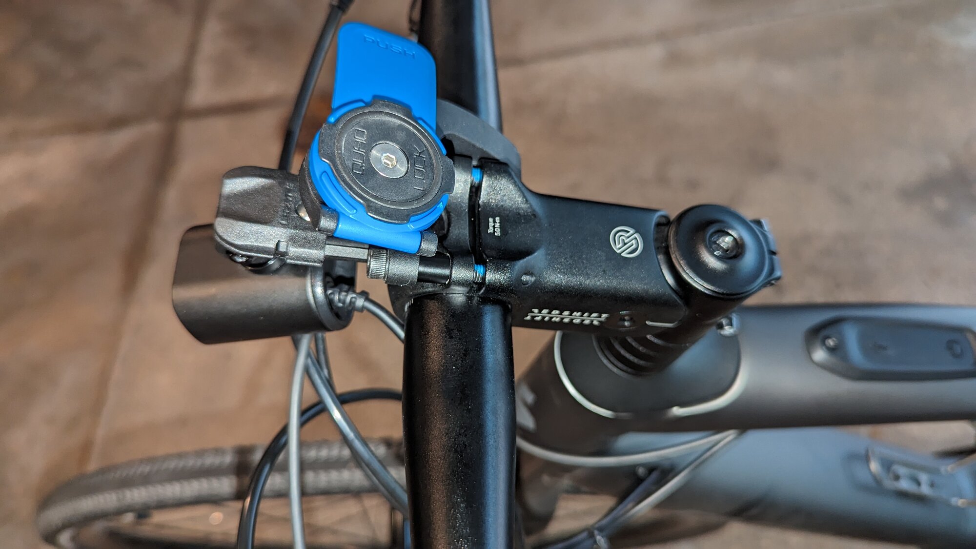

Important Note To Consider: Your front headlight mounts to your OEM stem and is handled via a Specialized plastic mount which affixes/slides into a 'notch' which is part of the bottom portion of your OEM metal stem. Once you remove your OEM stem to replace with the RedShift stem you lose the mounting notch and you will need to find an acceptable solution to re-mount your headlamp. I pondered many of these solutions which can be found here at the forum....some more sophisticated than others but few satisfactory to me. I came across a Lezyne (the manufacturer of your headlamp) stem mount part number 1-LED-RP-EMTSTM-V104. Surprisingly this part is not so easily available via retail but I found it here on ebay for $20 https://www.ebay.com/itm/275113452048 While I waited for this to arrive....I simply zip-tied the headlamp to my RedShift stem.
This Lezyne headlamp stem mount arrives with everything that you will require to smartly mount the headlight along with your RedShift suspension stem. It will mount to your choice of the front top two stem mount screws or the bottom two stem screws....whichever works best for you (I used the lower screws). I had posted some photos of my installation here somewhere.....but it results in a clean, smart looking, and very secure way to re-mount your headlight....in fact better than original in my opinion.

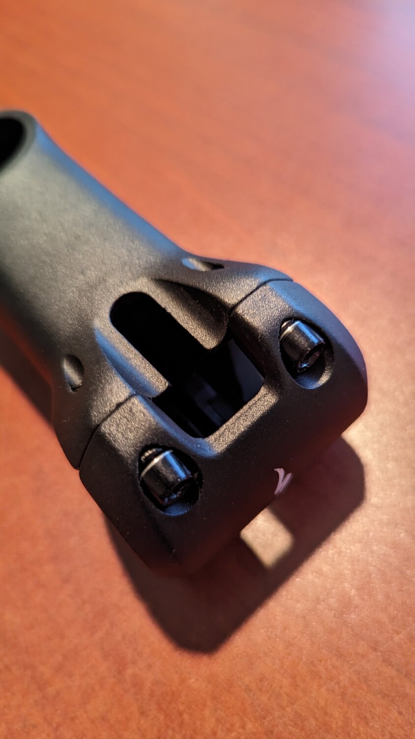

Here is your OEM stem uninstalled from the bike.....bottom view....and this 'notch' or cut-out is where the plastic mount atop your headlamp slides into the stem for mounting purposes. Once you give up the OEM stem you also give up this method of mounting the head lamp.
and here is a photo of the headlamp mounted with the Lezyne stem mount along with the RedShift stem:

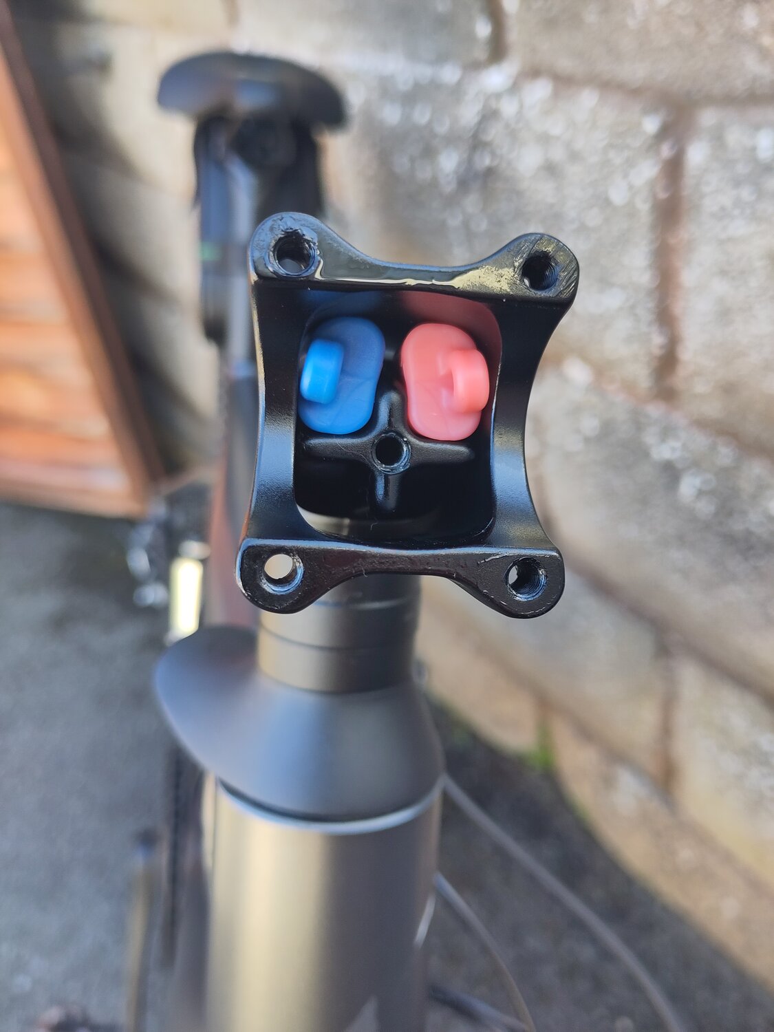

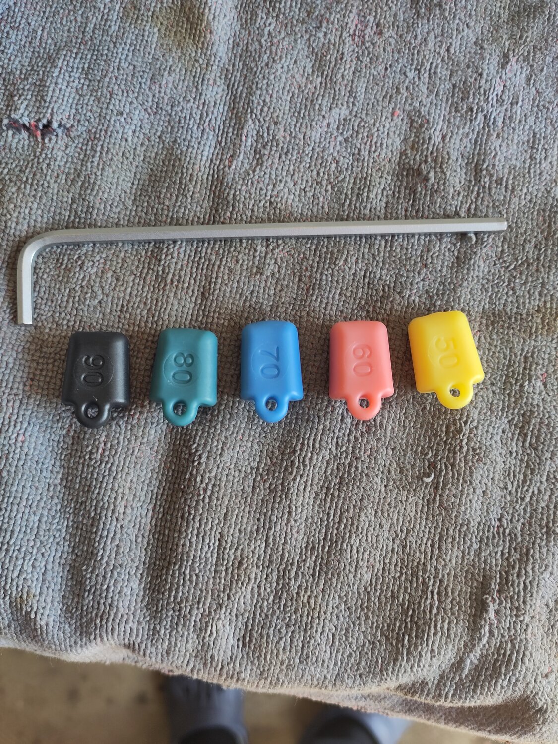

This is what the redshift stem looks like inside before the handlebar is fitted. The little cushions are called elastomers and you can pick the density according to your needs.

I beg to disagree. The first issue people experience with RedShift stem is the proper elastomer selection. Interestingly, using Innerbarends (especially in the sporty riding position) calls for the "drop bar" selection of elastomers, that is, two elastomers instead of one.
Some people think selecting the softest elastomer will give them the most of ride cushioning. Not. Too soft elastomer makes the stem compressed immediately with almost no dampening action. I use the blue and yellow elastomers together with my long stem and IBE setup like it were drop bars. It is because a big part of my body weight has been shifted forward.

I guess the best course of action is to experiment and not to just go with what the instructions say. Remembering that the elastomers do take a little while riding to 'bed in'

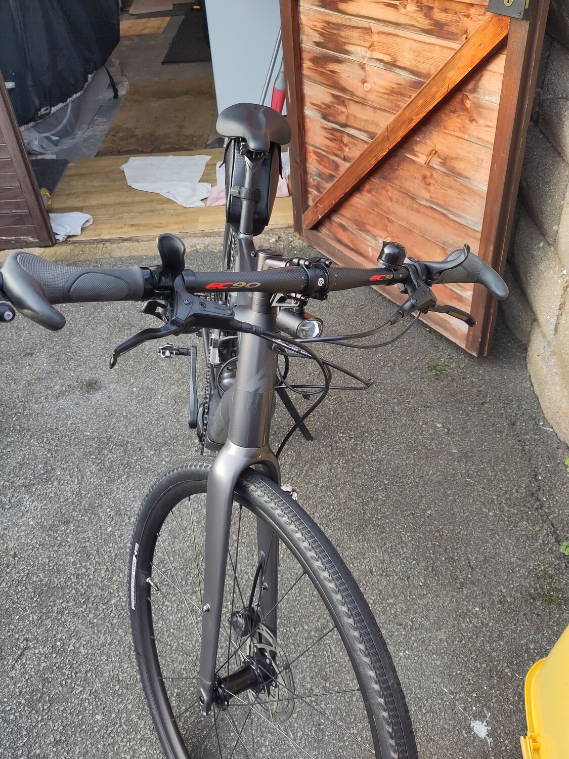

I've had multiple surgeries on my neck and shoulders, and shaky rides are a killer for me. I've had other gravel bikes and always bring my Redshift stem from bike to bike. I found the stock 4 SL to be an extremely stiff ride and, for me, painful. But I moved my Redshoft stem and my SQL inner bar ends and upgraded the handlebars to carbon ones, and everything is dreamy now. Improved the ride immeasurably. While all those things helped, the Redshift stem was the most improving, and then the carbon handlebars. Get the stem; you won't regret it.
PS. I also added a Redshift suspension seatpost because I'm a softie.

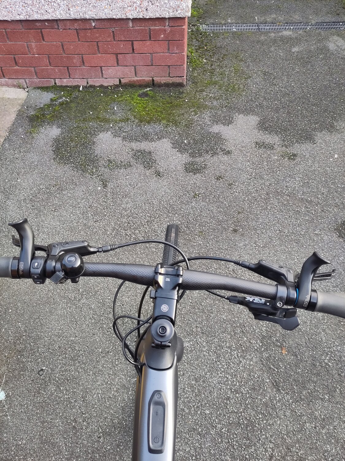

So on the advice of you guys my ordered parts arrived today and straight on the bike! Test ride tomorrow.
