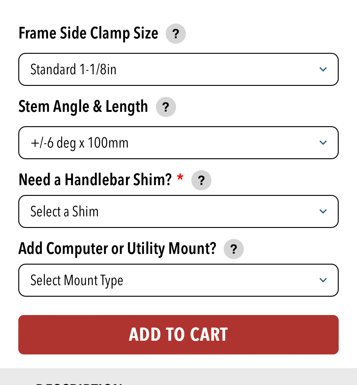

Thank you!
What is the right size and length of the stem?

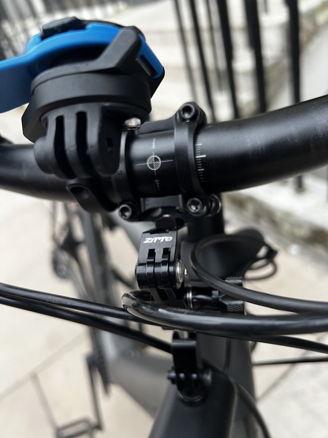

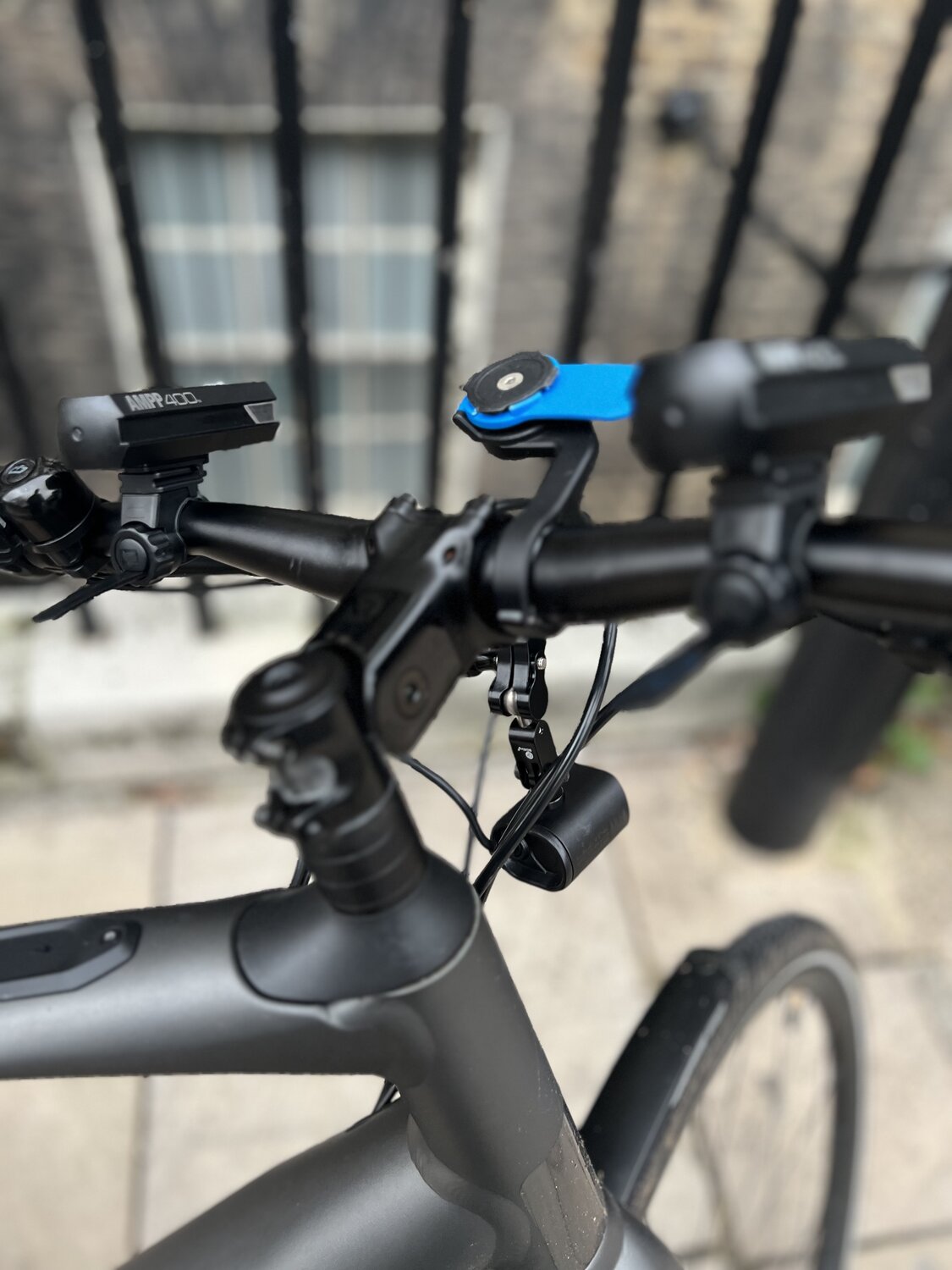

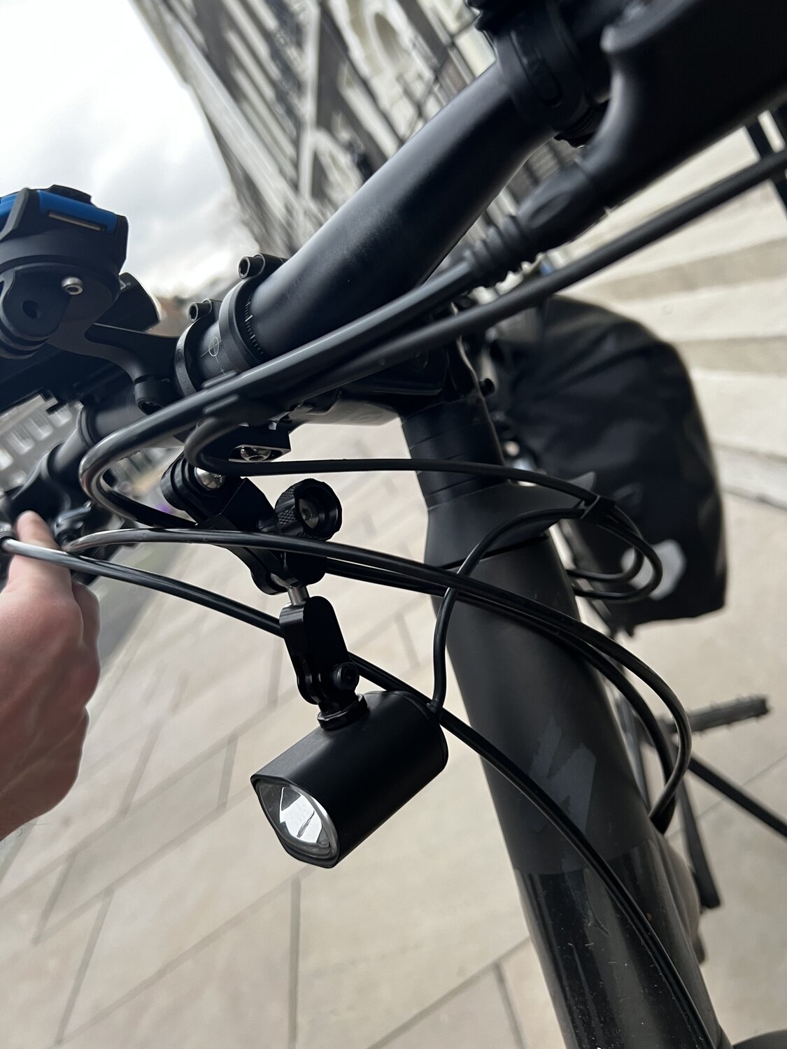

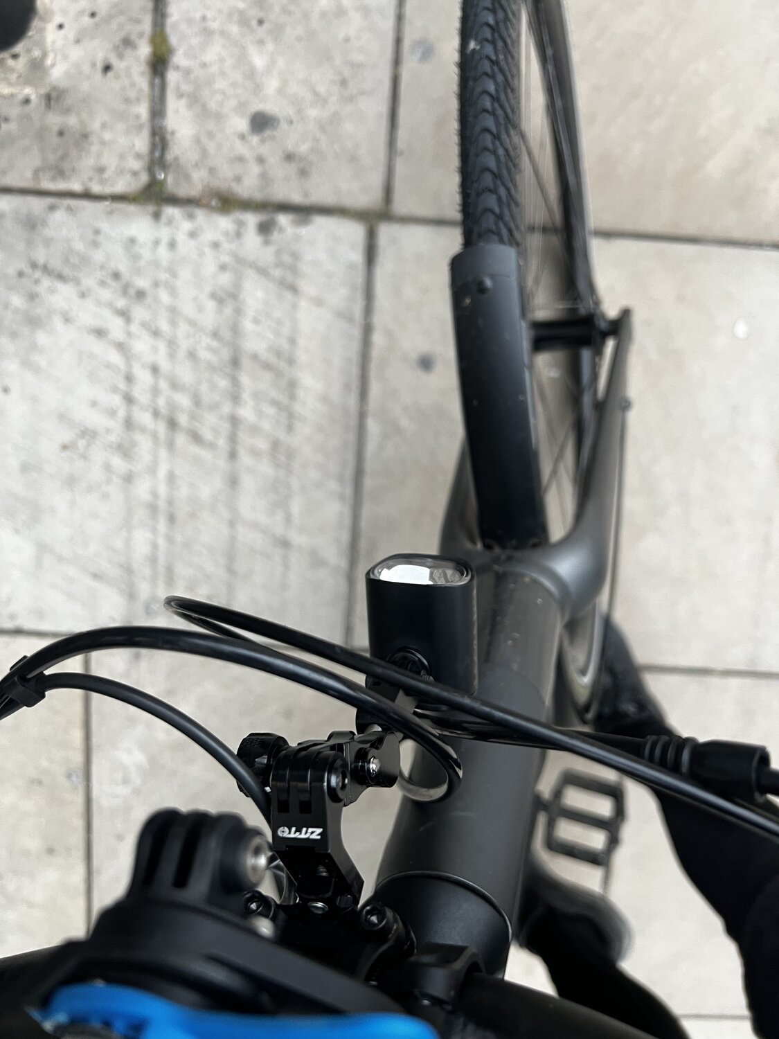

My solution was as follows. I share the link of the product I bought from Aliexpress. Both products are very high quality, I recommend.
Just found this amazing item on AliExpress. Check it out! £2.44 27% Off | ZTTO High-Strength Bicycle Stem Gopro Mount Lightweight CNC Holder Universal adapter for XC AM MTB Mountain bike Road Bike
Just found this amazing item on AliExpress. Check it out! £7.12 17% Off | Aluminium Alloy 360 Degree Rotating Joint Adapter Mount for Gopro Hero 12 11 10 Max XiaoYi SJCAM SJ4000 Action Camera Accessory

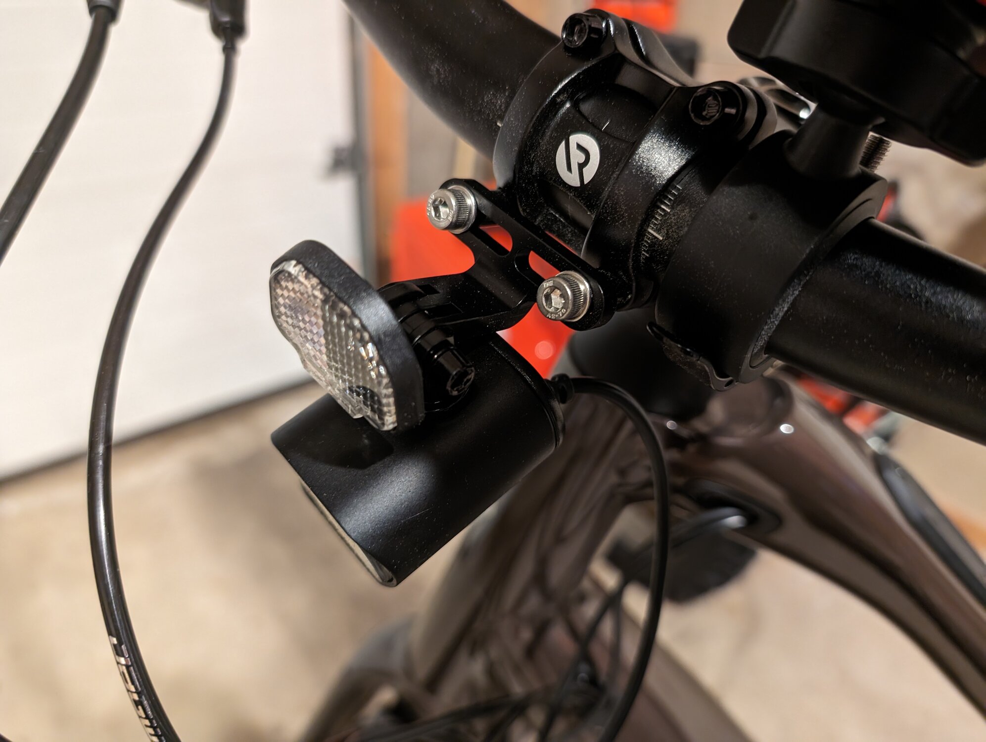

Re: The stem. I used this for the headlight: VEXPLO Bicycle Handlebar Mount...https://www.amazon.com/dp/B0BXVVXS5Y?ref=ppx_pop_mob_ap_share

Re: The stem. I used this for the headlight: VEXPLO Bicycle Handlebar Mount... https://www.amazon.com/dp/B0BXVVXS5Y?ref=ppx_pop_mob_ap_share
It is hard for me to visualize how you did it :) A picture, please?
